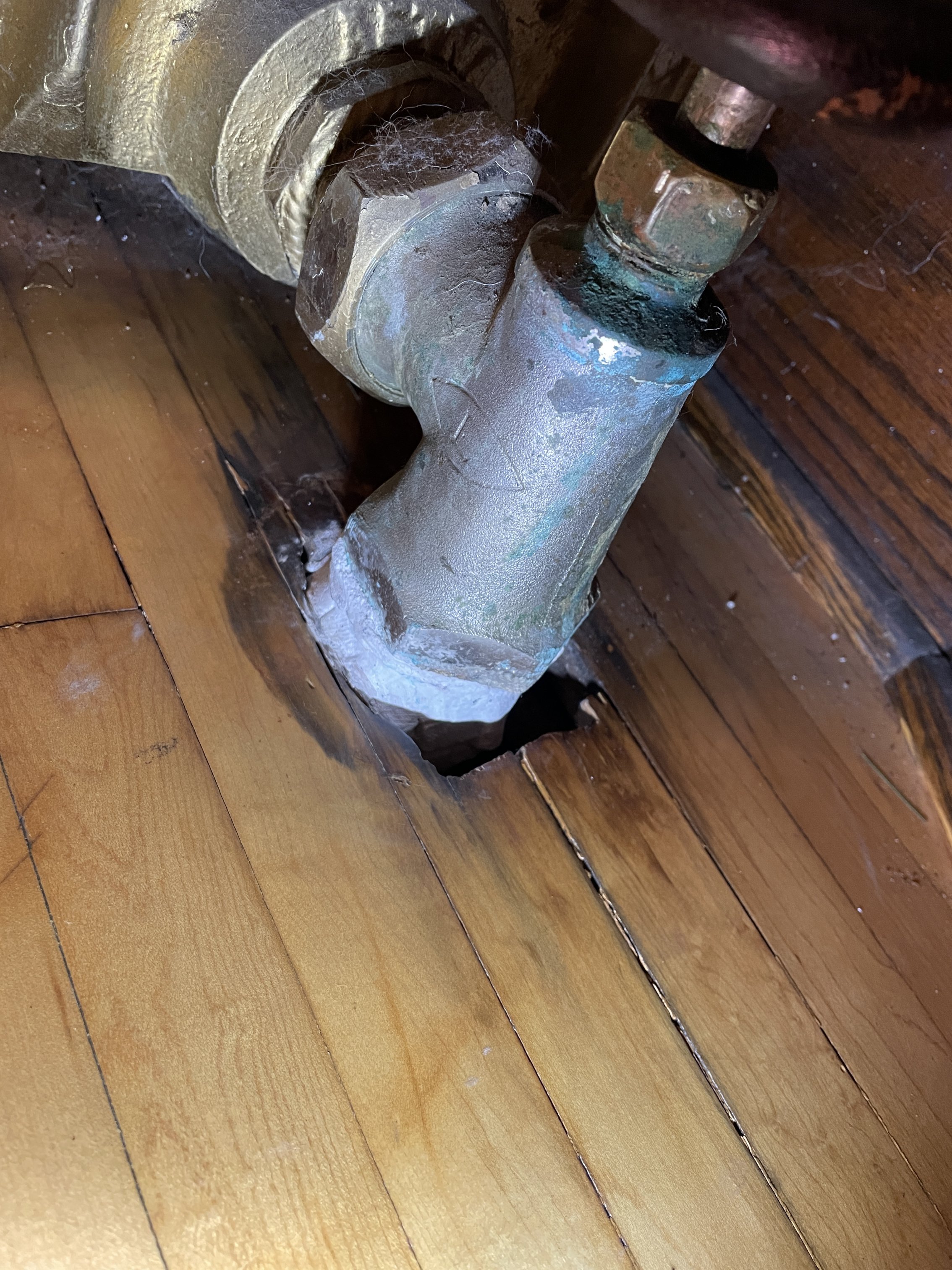

    guitbox Member Posts: 39
    Here's the pic of the corroded nipple that I'm most worried about and the temporary fix. I'm not sure this JB Weld epoxy is going to stick to this rusted metal, but I guess we'll see. If it doesn't hold I may have to call a pro who can fix it fast since I can't be without heat for too long.
  • Grallert
    Grallert Member Posts: 1,102
    Those riser pipes can be a real tricky repair and best left till warmer weather. It's possible the JB weld will stop the leak it's more likely it will just hide it as it drips down below. Either way it's less likely to continue damaging your floor. In theory the repair is simple but there's a good chance the nipple will break off in the valve and need to be carefully removed without damaging the threads in the valve.
    It's good to see there are still some exposed threads on that packing, you might be in luck simply tightening the nut till spring.
    Thanks, I hope it can last till spring. As long as the leak is just a drip and not lowering the water pressure of the boiler, I'm fine with it dripping onto the unfinished basement floor. At this time, I don't see any dripping, but will keep an eye on it.
  • Grallert
    That reminds me. I forgot to ask if your system is steam or water. If steam the pressure is very low and repairing the packing much easier. If it's water the pressure will be around 12-15 PSI and the repairs will be more complicated and definitely a warm weather endeavor.

    It is water and not steam. It's sitting around 10-12psi right now. I hesitate to bring it up to 15 until the repairs to the valves and pipes are fixed.
    I'm leaning toward just leaving the packing material and adding some more graphite or teflon rope, but I guess if there is not enough threads to do that, I may have to spray it with soapy water and put on a mask and remove it. I'm not sure it's asbestos so playing it safe is a good idea
    mattmia2 Member Posts: 16,431
    if the nut bottoms out before it stops leaking you have to add more. if there is enough in there to compress more then you might just have to tighten it. teflon is a lot more durable than the various fiber packings, little bits of the fiber packings tend to shred and get pulled out with the stem turning as rell as compressing over time. teflon is more stable but also much harder so you usually need to compress it in stages, add a little, put the nut back on and compress it, add a little more until you have enough that the nut isn't bottoming out
    don't crank too hard on them, the packing nut is relatively easy to crack

    Thanks for the extra detail. I'll be careful not to over tighten. Good news is, after tightening the nuts on all the radiators a bit this morning, I see no signs of leaking at the packing nut anymore. Maybe I can just leave them or maybe add some more packing to each of them in the spring.
    Since they have been left to leak for long periods of time, I suspect what has happened on a couple of the worse ones ( floor has black staining) the water drips down over the brass valve and does the real damage to the galvanized steel nipple under the valve. The nipple corrosion went unnoticed by me because they are under the floor and the escutchion plate. I can compress the nipple on two of them with my thumb which tells me they need to be replaced soon. Unfortunately one of them is on the second floor and I can't get at the pipes from underneath because the ceiling is finished. If the nipple comes out clean then maybe I can fit a new one without opening the ceiling. The 1st floor one is easier because the basement is unfinished.
