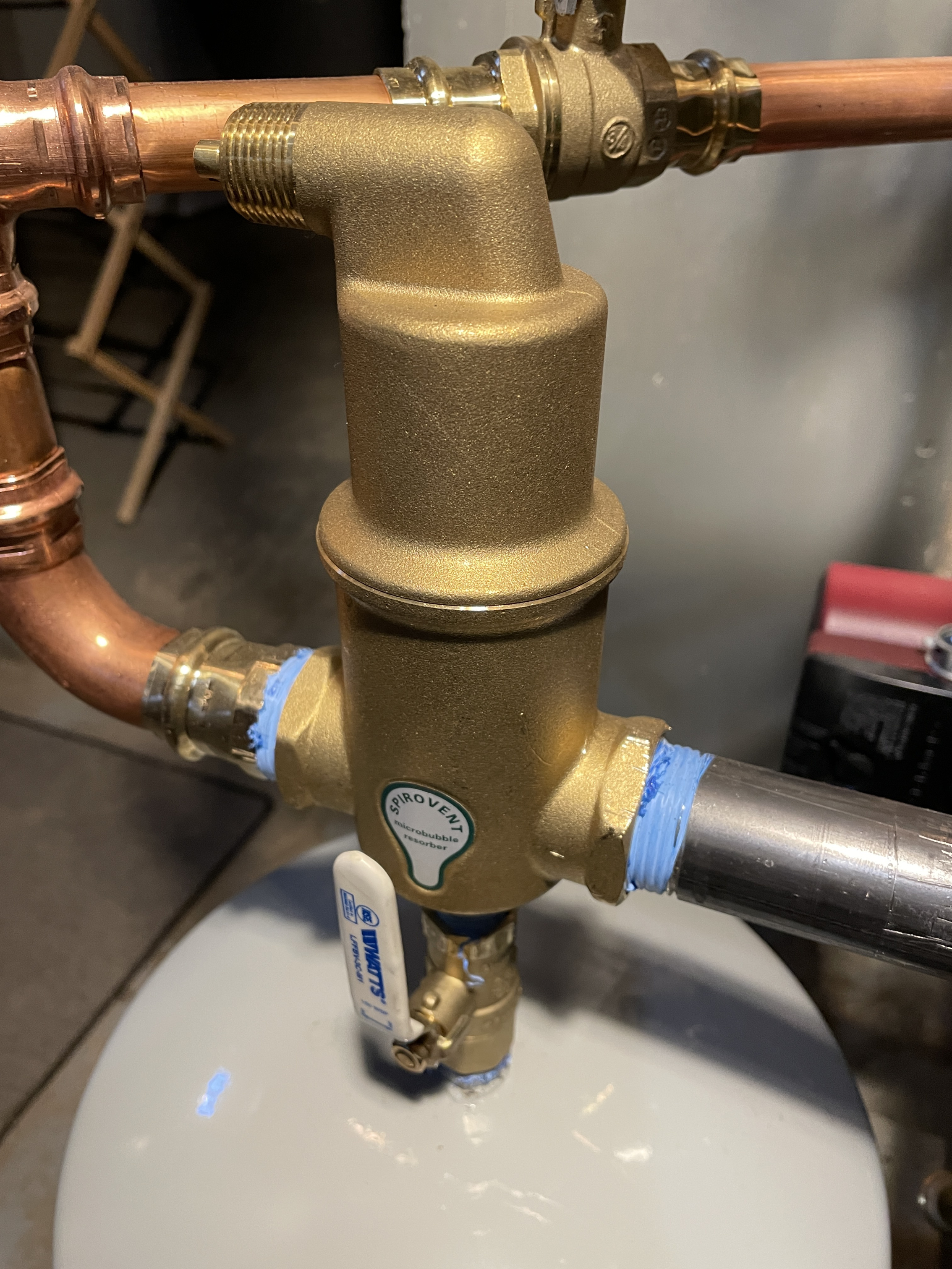

    I'm wondering if this is related to the leaking or something else. When I had the new boiler installed a few months ago, the technician said to wait 3 weeks and bleed the radiators. I did that, but the water pressure was so low there wasn't enough to push any air/water out of the radiator bleeders. So, I added more water to the boiler to about 12-14psi or so. The meter isn't so accurate that I can get to a specific psi. Anyway, fast forward to noticing some of the valves leaking at the packing nuts and the one nipple that I repaired with JB water weld and the pressure is down to 6-7psi. I've inspected all the radiator valves and piping that is not hidden in a wall and I can't imagine it has leaked much water—we're talking eye dropper dripping. At this time after tightening packing nuts I'm not seeing any dripping. So, what would cause the pressure to decrease so much? Is this normal with a new install that I need to bleed/refill until it's up to normal pressure a couple times? Also, when I refill do I need to do anything other than make sure the system is cold and open the water inlet valve? Do I need to do something to keep water from entering the overflow tank or something else?
    it only has a manual feed, not a pressure reducing valve? if it is a manual valve you need to use it to bring the pressure back up, to about 12psig if you have a 1 or 2 story house, a bit more if it is 3 story.
    does it have a microbubble air separator?
    fresh water has some air dissolved in it that will come out of solution when heated and the pressure is reduced so either that will find an auto air vent or become a pocket of air somewhere.
    when you purge or bleed a system you still leave some pockets of air in places, if you have the air elimination or management set up right those will migrate to the boiler and be vented or deposited in a compression tank so that is probably the air working its way out of the system. if it keeps happening after a few weeks to a month or 2 it may be all of your small leaks adding up.

    It's difficult for me to answer your questions because I know so little about modern boilers. My old boiler was simpler than this one.
    Am I correct in assuming "manual feed" means that the water inlet valve for adding water is opened/closed manually? In some systems, is the valve left open and the system automatically adds water when the pressure gets too low? If that is correct, then mine is manual feed.
    Yes, it has a microbubble air separator—see pic. Is that the thing that removes the air pockets and consequently lowers the water pressure?
    Thanks for explaining this, I'm learning a lot about my boiler that I did not know. I added water to 12-14psi cold and now that it's up to full heat it's at 20psi.
    reggi
    most modern systems have a pressure reducing valve that reduces the domestic water pressure to the cold fill pressure of the boiler. i will leave the debate about weather to leant that on or not for another time.
    that is a microbubble air separator. it will remove any air from the system if it is set up correctly and that will reduce the pressure if there isn't an automatic feed of water to replace it.
    if there are automatic vents at the top of the system those could pull in air if the pressure is a little low. if the automatic vent an expansion tank isn't before the circulator that could cause the automatic vent to pull in air in some cases.
    if topping it up doesn't slow the loss of pressure way down after a few weeks then there might be a bigger issue. you don't want to need to add fresh water very often because a lot of fresh water will corrode the boiler.

    As far as I can tell, there is no pressure reducing valve, and the water supply was turned off by the installers. So, I assume that means this system is designed to need water to be added manually.
    I'll keep an eye it and hopefully it will hold pressure now. Why does fresh water corrode the boiler?
    It brings oxygen and minerals with it. The boiler system is a closed system so the oxygen dissolved in the water quickly combines with a little of the iron and isn't available to corrode more iron(some of it gets vented as a gas as well). if you keep adding more water you keep consuming a little of the iron over and over again until the corrosion becomes significant.
