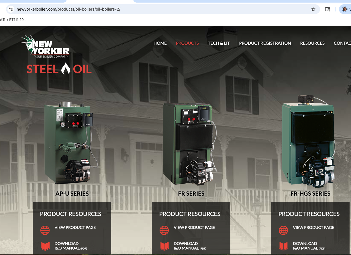

It seems most oil fired boilers are made with cast iron. I don't like cast iron. So I am looking for a steel boiler. The only brand that offers steel boilers seems to be Thermo-Dynamics. Is it a good brand? Are there other boilers that are not cast iron?

Somehow I missed that New Yorker offered steel boilers. When searching the internet for steel boilers most results were cast iron.
