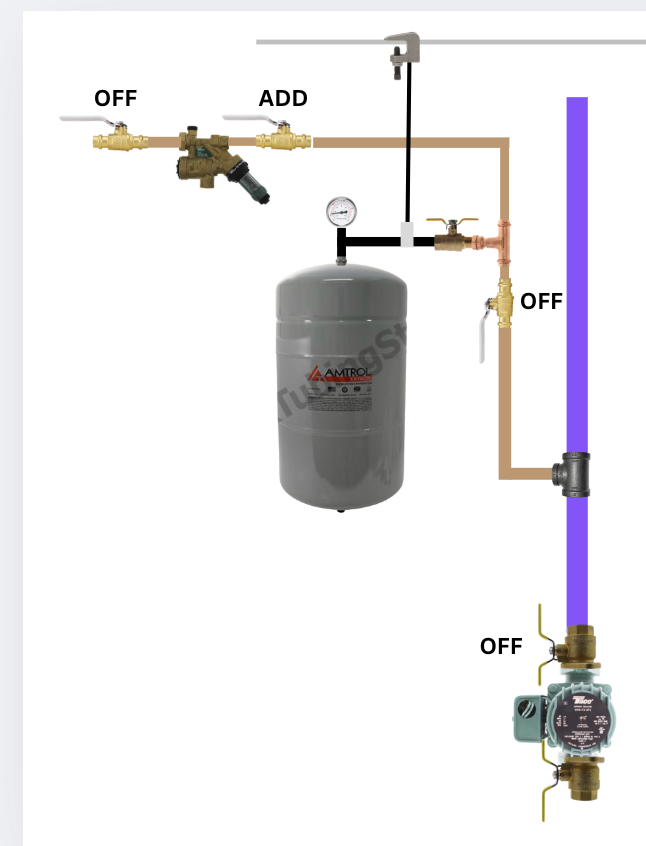

You have a ball valve at the boiler in the MU water. You could put the tee between the ball valve and the boiler. Put the EX tank and a pressure gauge there.
If you have (in addition to the valve we see) another valve upstream of the valve we see that only serves the boiler cut the tees in between the two valves.
Make sure you install the ex tank with the nipple pointed up and support the tank or make sure where you cut the tee in you can support the tee that feeds the tank. A drain where the tanks connects is noce to have

Is this correct? I added a tee with a pressure guage.
I have a steel beam right above the junction where the EX tank would hang. Seeing that this re-pipe woutl be copper and not have the tensile strength
, maybe a short steel or bronze nipple with a clevis hanger of some sort to support the EX. Or am I totally off here! Thank you!
Yes that will be fine. You could put another hanger on the city water supply to the expansion tank tee. You don't really need it for support, but it might be easier to hang it. One hanger is plenty though
here is super simple and low cost
Press in the FIP tee
Screw the iso ball valve into that tee
Screw a 1/2 x 4 black nipple and black ell into the iso valve
Screw tank into ell
Threaded rod or any suitable hanger rod around the black nipple
No need to mess with the fill valve location

When moving the EX, I would shut off the boiler. Shut off the current service valve for the EX. Close both valves from the MU water. Apply the changes you suggested.
I’m assuming the EX will need to be drained and pressure checked and reset.
How is system pressure then established while the repair is being made if both the EX and the any water are both essentially OFF?This is all so I understand the next steps. I will have a more qualified person with me.

You are 2/3 of the way there.
Is there another valve on this return line, or multiple valves?
You need to completely isolate that section or pipe, to cut into the 1/2" copper line
or else drain the system down to that level.
If you know a plumber with a freeze cuff, you could freeze the 1/2" line between the two press couplings to cut in the new tee just below the 1/2" valve.
A thrill-seeking plumber may just drop the pressure to zero, cut a press ball valve into the copper line just above the ell where it ties into the black steel tee :)
There are some 1/2" tap a line valves, but quite $$ Although sometimes on ebay they go pretty cheap.\
If you take on this project, remove the tank and plug that yellow tank isolation valve.

Thanks @hot_rod . Unfortunately there is no other valves upstream of the circulator on the return.
If I cut the copper pipe above the MU valve, would that provide the isolation?
There is another valve before the Fill valve,
waters coming down the purple pipe from above, unless you valve it off or drain it out
Lowering to zero pressure and doing a hot stab puts the system at a condition that if you are quick and methodical you could install the additional valve you need.
The same trick is used to change elements in electric water heater tanks without draining them down.

So even though I can turn off the ball valve which is currently isolating the MU valve, I would still need to find a way to isolate the 1 1.25" return line?
Exactly what you show in that diagram, a way to keep any flow from coming down the purple line for your proposed cut for the new valve and tee.
When it comes to a wet "hot" connection into a line I use a push grip valve. Then no power tools are required, which don't always mix well with splashing water :(
This is a handy tee when you don't have a lot of pipe movement available, with FIP for the tank connection
