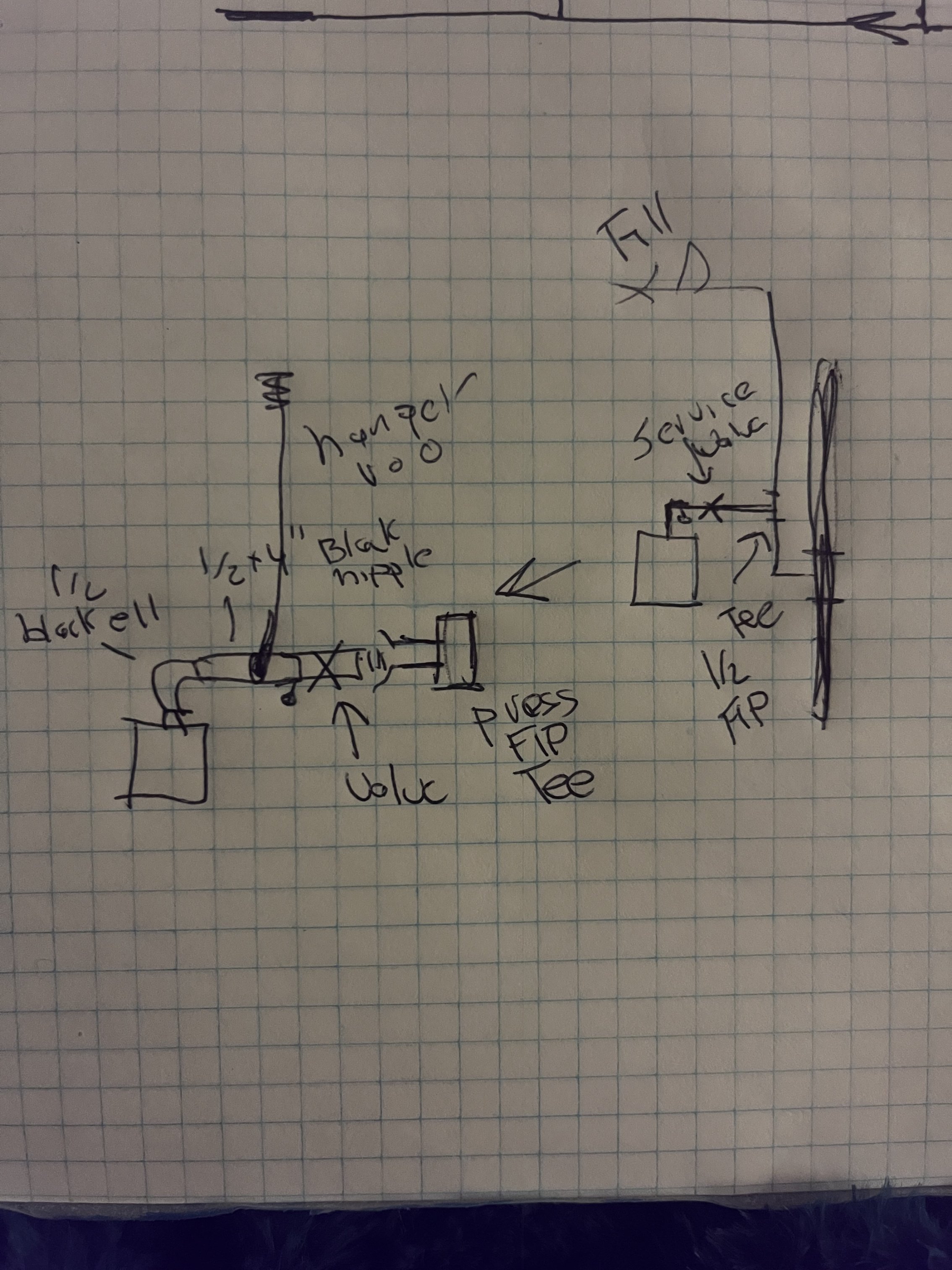

    here is super simple and low cost
    Press in the FIP tee
    Screw the iso ball valve into that tee
    Screw a 1/2 x 4 black nipple and black ell into the iso valve
    Screw tank into ell
    Threaded rod or any suitable hanger rod around the black nipple
    No need to mess with the fill valve location

    AlwaysLearning2024 Member Posts: 119
    Amazing @hot_rod !
    When moving the EX, I would shut off the boiler. Shut off the current service valve for the EX. Close both valves from the MU water. Apply the changes you suggested.
    I’m assuming the EX will need to be drained and pressure checked and reset.
    How is system pressure then established while the repair is being made if both the EX and the any water are both essentially OFF?
    This is all so I understand the next steps. I will have a more qualified person with me.
    Thank you all very much! Thai forum is truly helpful and generous.

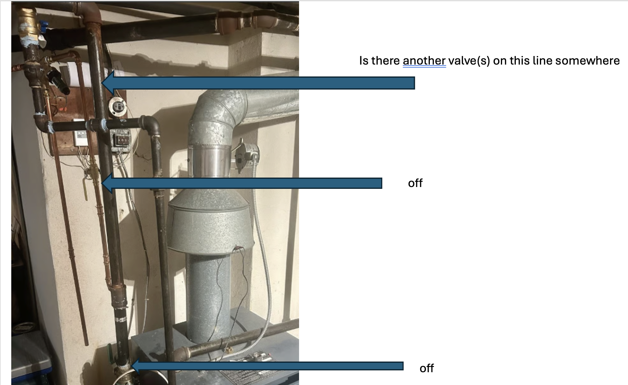

    Is there another valve on this return line, or multiple valves?
    You need to completely isolate that section or pipe, to cut into the 1/2" copper line
    or else drain the system down to that level.
    If you know a plumber with a freeze cuff, you could freeze the 1/2" line between the two press couplings to cut in the new tee just below the 1/2" valve.
    A thrill-seeking plumber may just drop the pressure to zero, cut a press ball valve into the copper line just above the ell where it ties into the black steel tee :)
    Thanks @hot_rod . Unfortunately there is no other valves upstream of the circulator on the return.
    If I cut the copper pipe above the MU valve, would that provide the isolation?
    There is another valve before the Fill valve,
    hot_rod Member Posts: 28,078
    waters coming down the purple pipe from above, unless you valve it off or drain it out
    Lowering to zero pressure and doing a hot stab puts the system at a condition that if you are quick and methodical you could install the additional valve you need.
