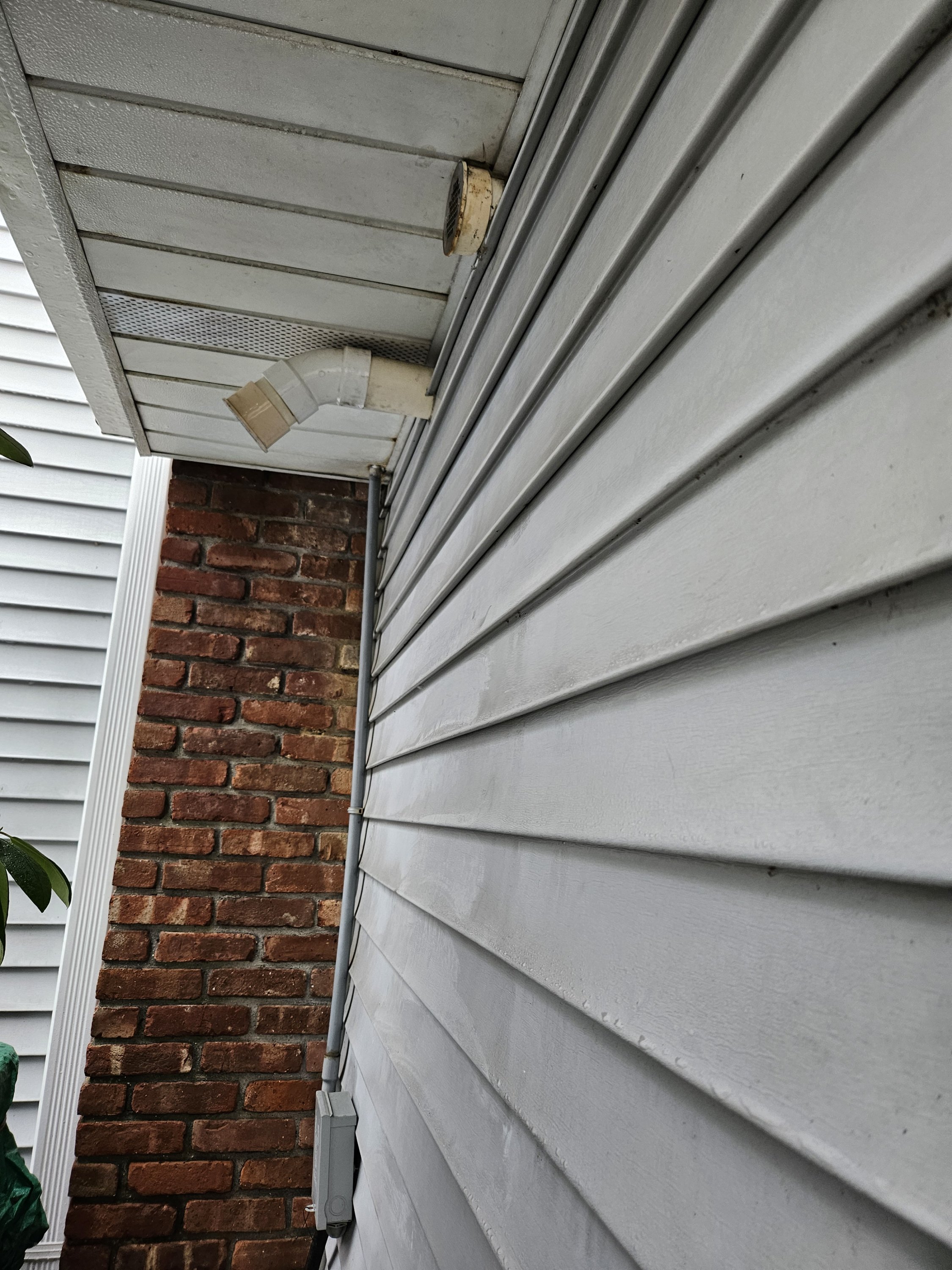

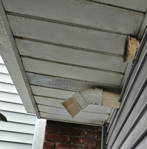

Hi and Good Morning everyone…I've been on before with questions about this same system of which I had to replace after 11.5 years … Since it was freezing with no time to make any decisions to change to a less Hi-tech, standard system, we replaced with the same unit…everything is working extremely well and no issues as I experienced at the beginning last time that caused me to come on here..Anyway… Unrelated to the new install, ice on the gutter on the outside wall caused my soffit and gutter to come down, which exposed rotten wood which was caused by the units exhaust over 11 years… My soffit is OVER the exhaust thus the condensate has caused the wood to rot… All of that has been fixed BUT the exhaust has to be extended which now means that my central AC unit must be moved about a foot so that the acidic condensate doesn't destroy it… Are there any other remedies such as extending the pvc duct and directing the condensate upwards?…or downwards… my installer seems to think not I hope all of thhis makes sense…. TIA…

    Picture of the exhaust pipe and the AC unit (all in the same shot) to get a better idea of your concern would help.

    ant930 Member Posts: 127
    edited December 2025
    Ok… Be right back…The Rhododendron is not as close as it looks and has been cut all around the bottom…
  • ant930
    The condensate was going up into the soffit which caused all of the wood underneath to rot badly… to extend the exhaust pipe it will inevitable drip acidic condensate onto my AC unit…Specs state the exhaust is NOT to be under a soffit for the very reason the wood had rotted
  • Ironman
    Ironman Member Posts: 7,886
    That should never have been installed that way.
    All that’s needed is for the pipe to be extended beyond the soffit and a 45* ell put on it facing upward.

  • Ironman
    There won’t be any (or extremely little) condensate dripping from the ell if it’s pointed upward. Any unevaporated condensate will drain back inside the piping as it’s designed to do.
    If that’s a real concern, then the pipe could be offset in the horizontal portion that’s under the soffit with a couple of ELLs, then extended out past the soffit with the 45 pointed upward.
    I’m a little bit at a loss as to why your plumber doesn’t see how to do something that simple.

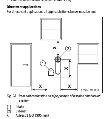

    hot_rod Member Posts: 27,054
    The installation manual shows acceptable venting termination.
    Is the 45 on the vent outlet?
    Could you remove the 45 and extend the pipe out to the end of the soffit?
    Although wind could still blow exhaust back against the building. Any windows above the soffit?

  • Ironman
    I can’t see everything from your picture, but I’d probably go away from the chimney since an inside corner termination should be avoided.

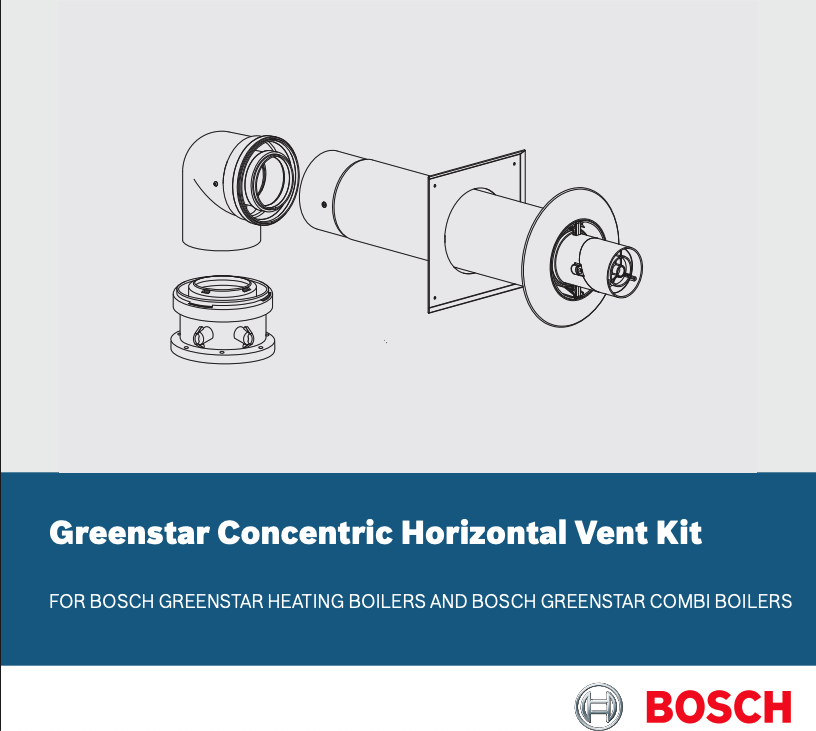

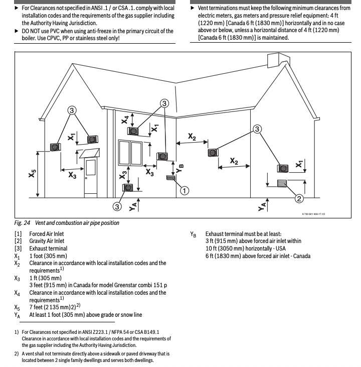

    I'm not a huge fan of these concentric vent kits, but they do blast the exhaust away from the building.
    Here are their other guidelines.
    Screenshot 2025-12-29 at 1.15.43 PM.png Screenshot 2025-12-29 at 1.16.04 PM.png

    Hotrod, Bob… we can extend it out, but thats why the plumber that did the install said that the condensate would then not be good to be over sthe AC unit slightly…I have that whole diagram also that you sent….pulled off Bosch site instead of copying from manual…Of course I don;t know what all that means, but when you all say "45" is that 45 degree angle?… as you can see in the photo, I believe it is
    Another option is to remove the 45° fitting , put a 90° ell, run down under the soffit 5 feet or so, then turn back out with a 45° or another 90°ell.
    This gets it away from the inside corner of the home, exhaust out from under the soffit, and away from the AC.
    So it would run horizontal under that intake towards the end of that outside wall then end with either a 90 or 45?.. I'm sorry, I'm trying to visualize in my mind… Also regarding a question you had earlier… there are no windows above…
  • ant930
    From that exhaust to the end of that wall/house it is about 5.5 feet
