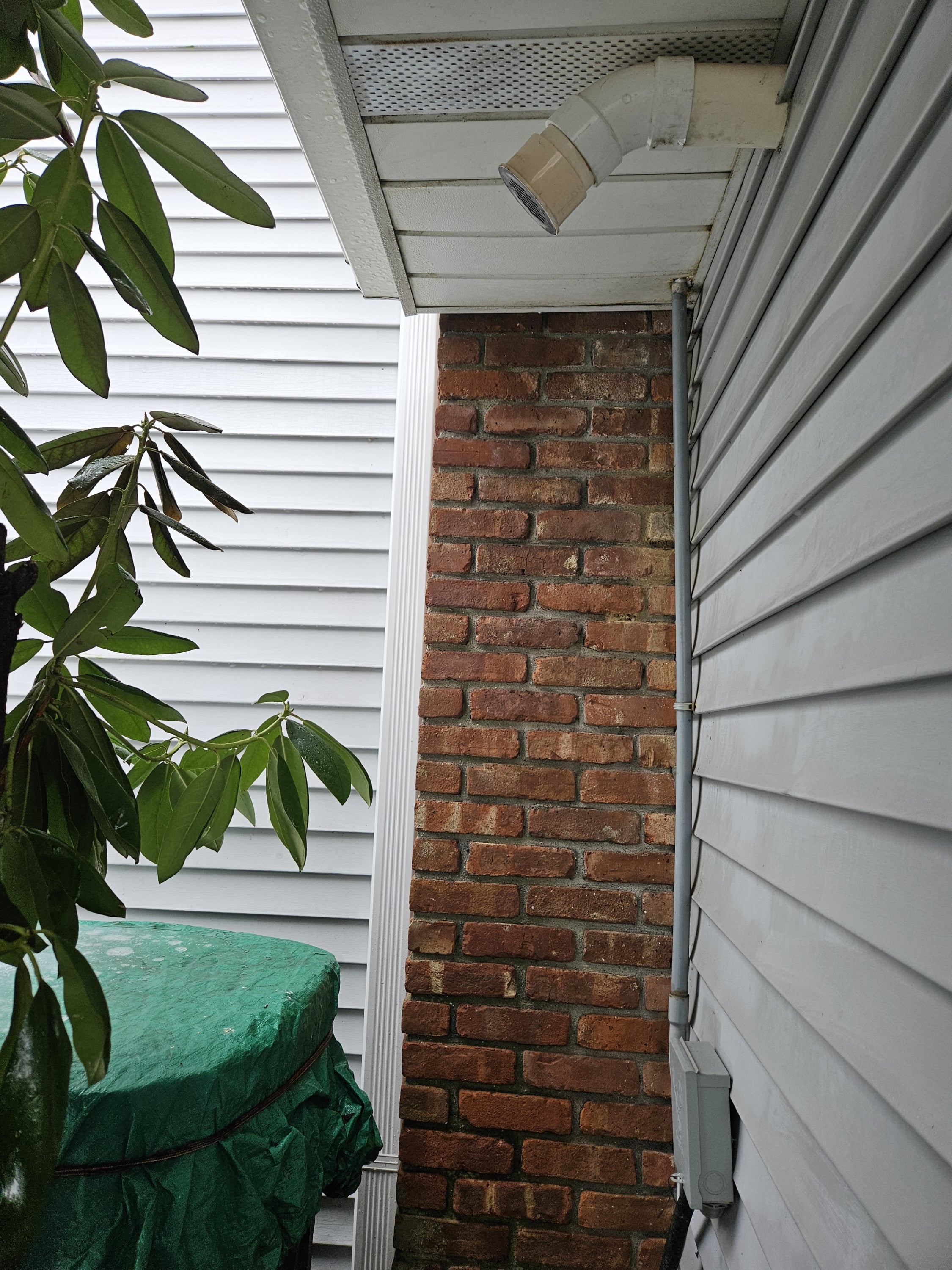

Hi and Good Morning everyone…I've been on before with questions about this same system of which I had to replace after 11.5 years … Since it was freezing with no time to make any decisions to change to a less Hi-tech, standard system, we replaced with the same unit…everything is working extremely well and no issues as I experienced at the beginning last time that caused me to come on here..Anyway… Unrelated to the new install, ice on the gutter on the outside wall caused my soffit and gutter to come down, which exposed rotten wood which was caused by the units exhaust over 11 years… My soffit is OVER the exhaust thus the condensate has caused the wood to rot… All of that has been fixed BUT the exhaust has to be extended which now means that my central AC unit must be moved about a foot so that the acidic condensate doesn't destroy it… Are there any other remedies such as extending the pvc duct and directing the condensate upwards?…or downwards… my installer seems to think not I hope all of thhis makes sense…. TIA…

    Normally the exhaust pipe is pitched back towards the boiler so you shouldn't get condensate outside. Is the warm vapor condensing your concern for the AC?
  • Picture of the exhaust pipe and the AC unit (all in the same shot) to get a better idea of your concern would help.

    Ok… Be right back…The Rhododendron is not as close as it looks and has been cut all around the bottom…

    The condensate was going up into the soffit which caused all of the wood underneath to rot badly… to extend the exhaust pipe it will inevitable drip acidic condensate onto my AC unit…Specs state the exhaust is NOT to be under a soffit for the very reason the wood had rotted

    That should never have been installed that way.
    All that’s needed is for the pipe to be extended beyond the soffit and a 45* ell put on it facing upward.

    The plumber didn;t say anything about being able to extend and then face upward at 45 degree angle… if that's what you meant above… if he just extended it, the acidic condensate would drip on the top of AC unit which would eventually cause damage

    There won’t be any (or extremely little) condensate dripping from the ell if it’s pointed upward. Any unevaporated condensate will drain back inside the piping as it’s designed to do.
    If that’s a real concern, then the pipe could be offset in the horizontal portion that’s under the soffit with a couple of ELLs, then extended out past the soffit with the 45 pointed upward.
    I’m a little bit at a loss as to why your plumber doesn’t see how to do something that simple.

    Sorry for sloppy spelling… and for my lack of knowledge.. I hope all that makes sense… So in other words…the outside pvc pipe can be pointed upwards after it exits past where the sofit/gutter ends? OR Horizontal?… would you do horizontal towards the chimney or past the intake?

    The installation manual shows acceptable venting termination.
    Is the 45 on the vent outlet?
    Could you remove the 45 and extend the pipe out to the end of the soffit?
    Although wind could still blow exhaust back against the building. Any windows above the soffit?

    I can’t see everything from your picture, but I’d probably go away from the chimney since an inside corner termination should be avoided.

    Hotrod, Bob… we can extend it out, but thats why the plumber that did the install said that the condensate would then not be good to be over sthe AC unit slightly…I have that whole diagram also that you sent….pulled off Bosch site instead of copying from manual…Of course I don;t know what all that means, but when you all say "45" is that 45 degree angle?… as you can see in the photo, I believe it is
    hot_rod Posts: 28,704
    Another option is to remove the 45° fitting , put a 90° ell, run down under the soffit 5 feet or so, then turn back out with a 45° or another 90°ell.
    This gets it away from the inside corner of the home, exhaust out from under the soffit, and away from the AC.

    So it would run horizontal under that intake towards the end of that outside wall then end with either a 90 or 45?.. I'm sorry, I'm trying to visualize in my mind… Also regarding a question you had earlier… there are no windows above…
  • ant930
    ant930 Posts: 127
    From that exhaust to the end of that wall/house it is about 5.5 feet
