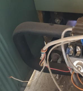

    Here are some pics I just took, if that helps. And yes, it has been running since 92.
    hot_rod Member Posts: 28,011
    It looks like someone has added a temperature control on the return piping? See below pic. But is has been disconnected inside?
    I suspect that added control maybe kept the pump off if the return temperature dropped below 130? That is one method for boiler protection.
    The general rule of thumb is for the boiler return temperature to rise above 130F within 10 minutes of run time. But your 20 minute in not a deal breaker, if that is measured at the return, not the boiler temperature gauge?

    No, the added temp control on the return piping is NOT connected.
    At this point, I do not have a temp gauge for the boiler return temp. All I have is the boiler temp gauge on the tank, so that is the gauge that took 20 min to get to 135 degrees. Do I need to install a temp gauge in the incoming pipe, just before the tank?
