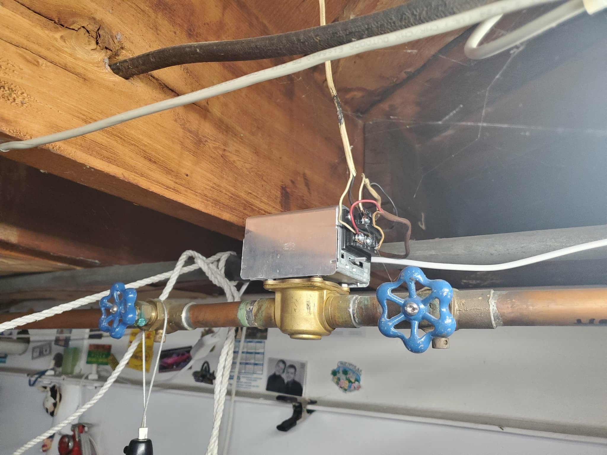

    Depending on the type of zone valve, some will trigger the boiler on when manually pushed to open, others do not

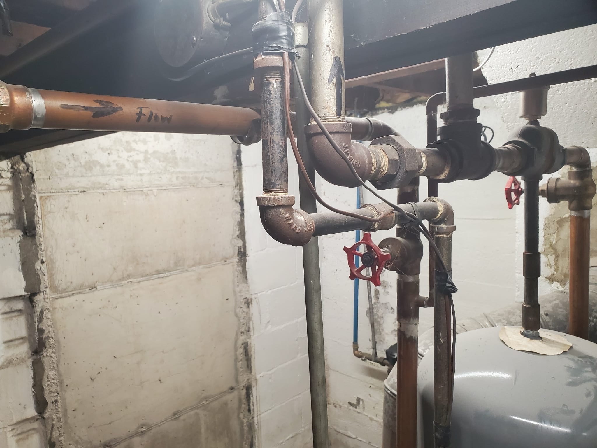

    A pic of the boiler piping and valves would explain more

    When my Honeywell zone valves click on, they open the water flow and also start the boiler.

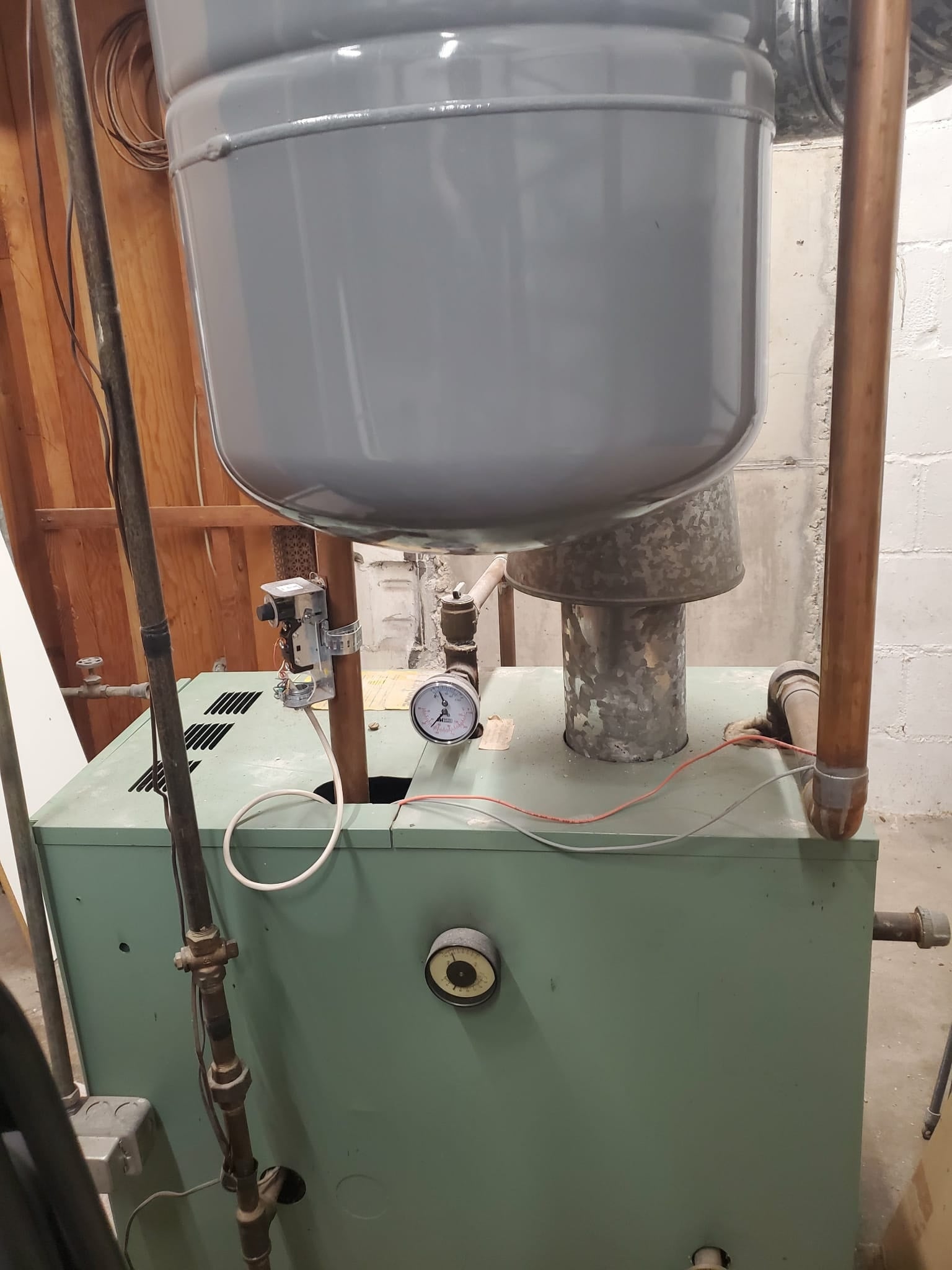

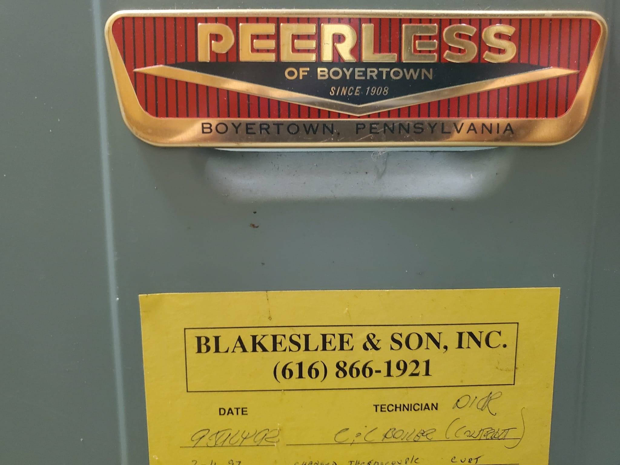

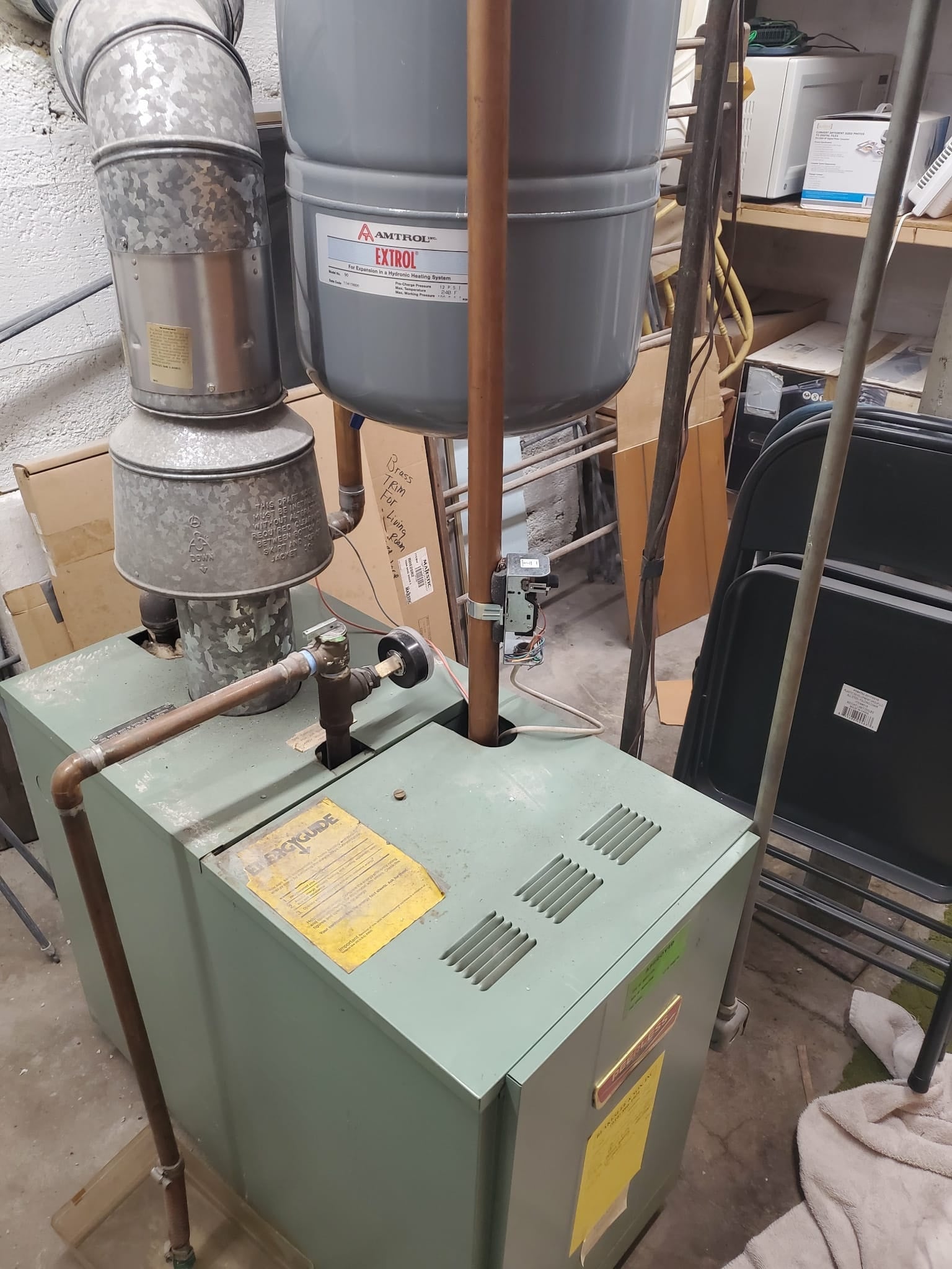

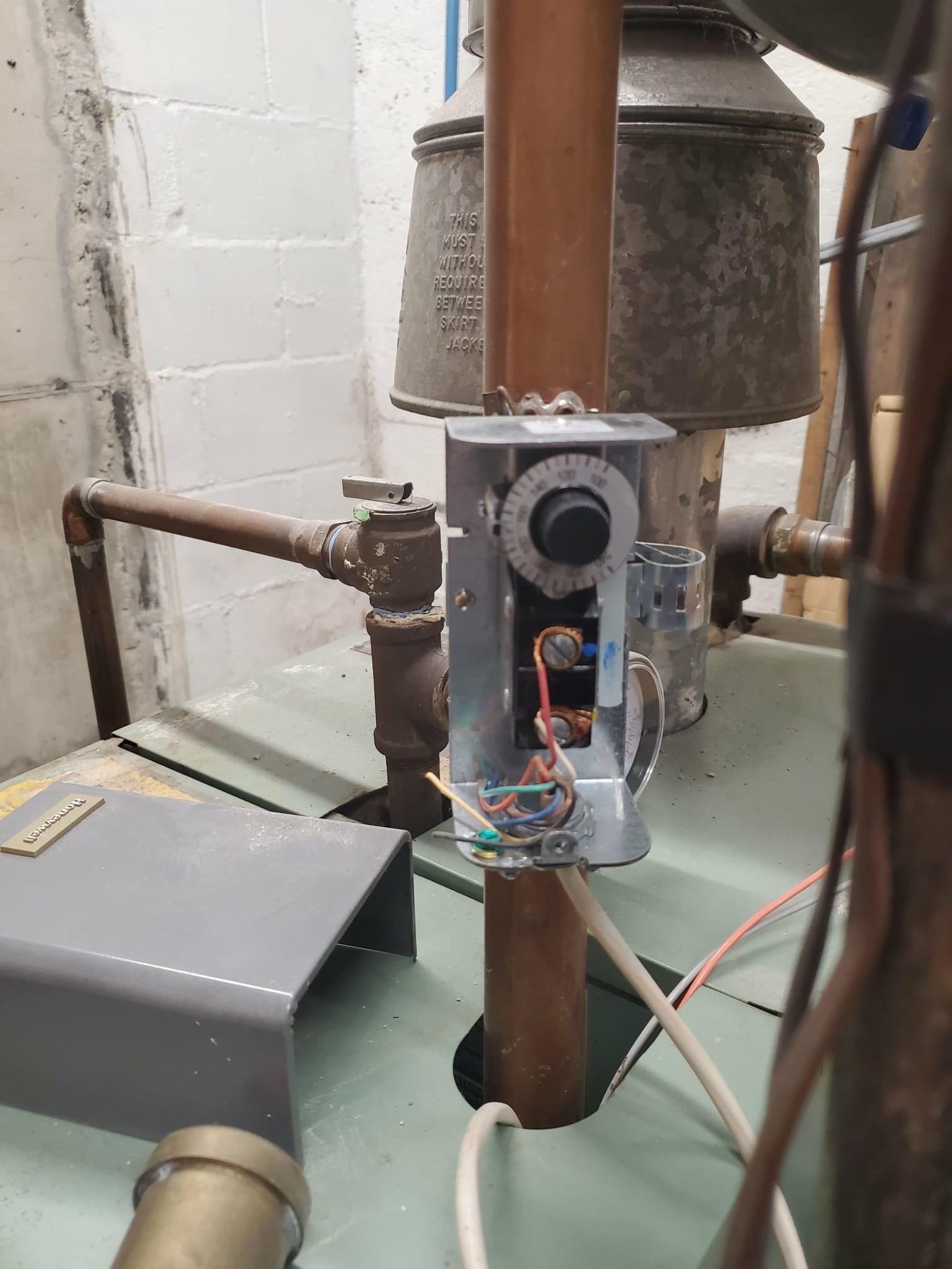

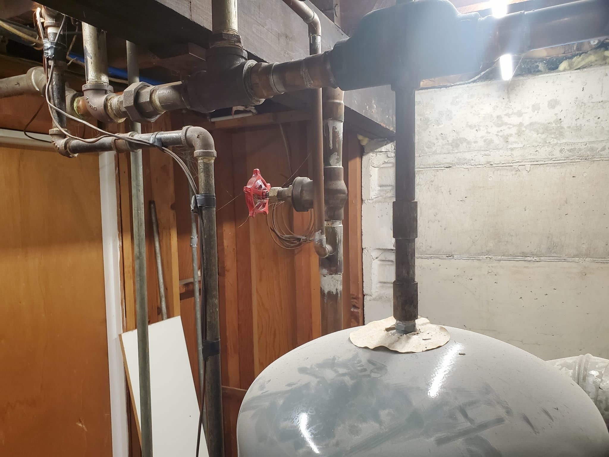

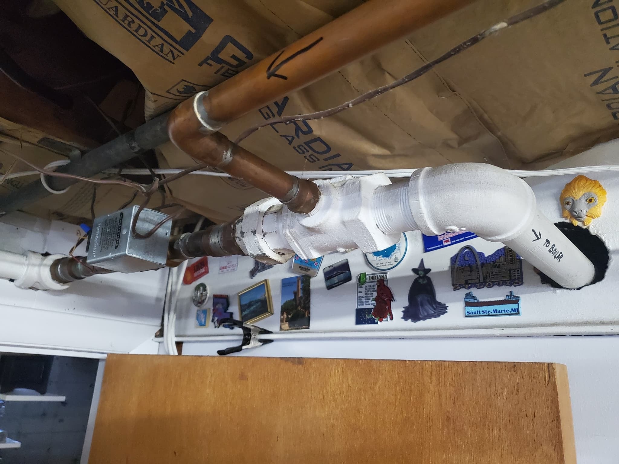

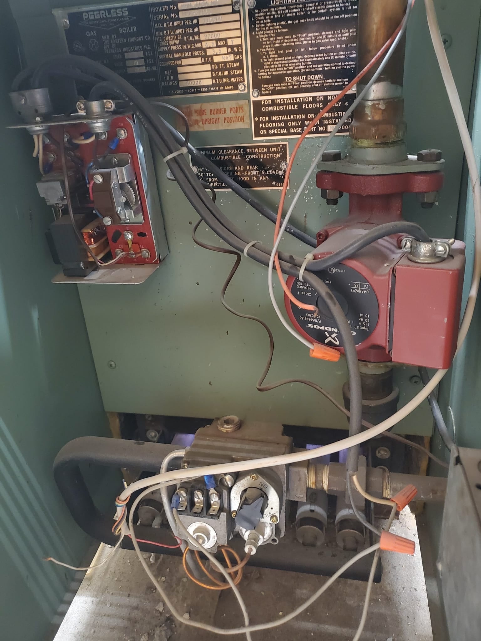

    Here are some pics I just took, if that helps. And yes, it has been running since 92.
    hot_rod Posts: 28,705
    It looks like someone has added a temperature control on the return piping? See below pic. But is has been disconnected inside?
    I suspect that added control maybe kept the pump off if the return temperature dropped below 130? That is one method for boiler protection.
    The general rule of thumb is for the boiler return temperature to rise above 130F within 10 minutes of run time. But your 20 minute in not a deal breaker, if that is measured at the return, not the boiler temperature gauge?
    The building, lifestyle, and your desired ambient temperature is what drives the fuel bill. It not so easy to compare neighbor houses.
    Also you want to look at fuel consumption over the years, your fuel provider may have that available online? Fuel costs have been going up, as such the monthly bill goes up.
    You do not have a vent damper on that boiler, so a portion of the heat energy you paid for is going up the flue, when the boiler is off. I don't know if that could be added, a question for Peerless. I would rather that then a purge system.

  • Hi Bob,
    No, the added temp control on the return piping is NOT connected.
    At this point, I do not have a temp gauge for the boiler return temp. All I have is the boiler temp gauge on the tank, so that is the gauge that took 20 min to get to 135 degrees. Do I need to install a temp gauge in the incoming pipe, just before the tank?

    Getting rid of the tankless coil will help, contact Peerless or their rep in the area about a damper addition
