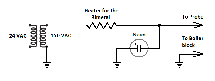

    When the power is on and water is low, the warning light lit up. When water reach the probe, the light turn off. I guess it means the probe is working? However, when heat is called, boiler still won't respond. If i jump terminal 3 and 4 (the label on my hand drew diagram) when heat is called, boiler fire up. So the problem must still be the lwco.
    I tested continuity between terminal 3-4, 3-5, 4-5. No call to heat, power off or power on, there's only continuity between 3-5. That means the bimetal switch is not shifting position to connect the safety circuit if i understand correctly.
    When the power is on, the voltage between 6-7 is 148v, between 6-8 is 138v, between 7-8 is 10v.
    Do you know what's the circuit inside the bimetal relay box? I took a guess and drew a diagram. It's riveted in place so i can't easily take is off.
    What other test can i do to diagnose?
    I know it's probably time to get a new lwco but I'm curious also still confused about a few things. For example, I don't understand the circuit connecting the warning light and the probe, and the possible heating element on the bi-metal switch. Maybe I drew it wrong.

    when the probe is conducting the voltage across the probe falls so it isn't enough to light the light, when the probe is out of water it isn't conducting and the voltage rises so there is enough voltage to strike the neon light. it is probably a transistor that closes the relay if there is enough current through the probe. the relay most likely is bad, most likely the contacts are corroded and not making good contact but the could could be open or the transistor could be bad too.
    109A_5 Member Posts: 3,456
    The probe basically shorts out the neon lamp and more current goes through the relay coil (heater).
    The Bimetal Relay - most commonly relays have a coil that makes a electromagnetic field and that moves an armature and opens or closes the contacts, in this case the coil most likely acts as a heater and the Bimetal flexes to open or close contacts. Since they used a Bimetal and a heater it is probably gives the unit some needed delay to avoid nuance interruptions and maybe a short water fill delay to get a bit more water into the boiler.

    If the probes continuity to the boiler's water is intact it effectively shorts out the neon lamp or the voltage is below the neon lamps firing voltage. When the water goes away the probe is basically an open circuit the Bimetal heater only has the neon lamps current through it so it cools down and the relay changes state.
    See delay times at the bottom of the label.
    Dirt simple, I bet the relay contacts need cleaning.

    if it is using a bimetal timer rather than a relay it is fairly common for the heater on those timers to burn out too, especially in this case where it spends a lot of time energized although if it is connected directly to the probe rather than through an amplifier the lamp won't light if the heater is open.

    The interesting thing is, without power there is continuity only between terminal 3 and 5, which is expected because the heater is cold so the bimetal switch connect the alarm/auto feeder circuit. However even when the power is on, without heat call (so the outside circuit through the thermostat is still open), there is still continuity only between terminal 3 and 5. I mean, if the heater is working, the bimetal switch would move away from terminal 5 then there shouldn't be continuity between terminal 3 and 5. However if the heater a bust, then the neon light won't lit no matter what.

    Ok, I see what you are saying. The contacts are probably 'Break Before Make' and the 3 to 5 never even opens up. I suppose the Bimetal being a spring something mechanical has failed so even with heat the Bimetal does not move the contacts properly.
    On your wiring diagram you could measure the resistance between points 6 and 8, with 8 disconnected from the probe, I'm thinking maybe higher than 20,000 Ohms but probably not higher than 100,000 Ohms.
    I'm starting to wonder if there is just a Carbon Composition Resistor for the heater and its value has drifted enough that it does not heat the Bimetal sufficiently any more. Even with the higher resistance due to age the neon lamp could still easily work.

    it is usually a little piece of nichrome wrapped around an asbestos sleeve over the bimetal strip
    Yes in general agree, but in this situation, the higher voltage 150 VAC (would be lot of nichrome wire), not much wattage needed, the low current through the water, and the Initial Burner Startup Time being a 5 Minute Delay and I bet nichrome wire is more resistance stable with time.

    120v bimetal timers were very common before things were microcontroller controlled. it is an off the shelf part although the current will be dependent on the water which will have a high resistance so the voltage across the timer will be far less than 120v.

    Looks like it may be Vitreous enamel coated ceramic wire-wound resistor for the heater, maybe the connections to the heater have dilapidated.

    that is just uninsulated nichrome wound in layers separated by mica or kynar.
    in the case of the hydrolevel it is probably more like 5v so the nichrome is much shorter since most of the voltage drop is in the water.
    5 VAC across the heater resistor makes little sense. The Neon lamp would be on all the time. The voltage drop across the water has to be less than the firing voltage of the Neon lamp. So there is way more than 5 VAC across the heater resistor.
