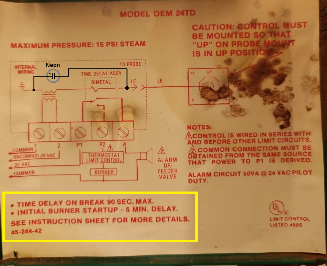

    What does the note say on top of the LWCO ?

    The note on the LWCO says something like "the red light will lit when water is low".

    I tested continuity between terminal 3-4, 3-5, 4-5. No call to heat, power off or power on, there's only continuity between 3-5. That means the bimetal switch is not shifting position to connect the safety circuit if i understand correctly.
    When the power is on, the voltage between 6-7 is 148v, between 6-8 is 138v, between 7-8 is 10v.

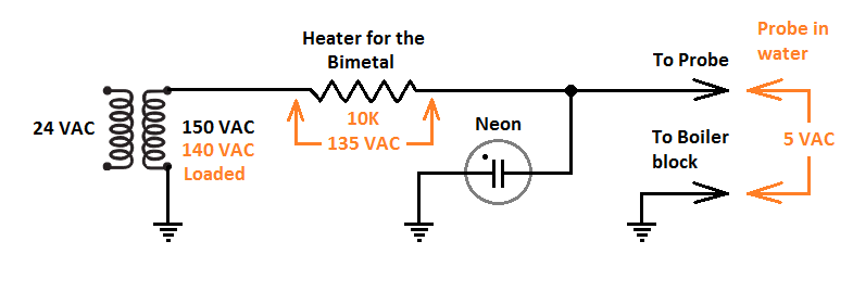

    Do you know what's the circuit inside the bimetal relay box? I took a guess and drew a diagram. It's riveted in place so i can't easily take is off.
    What other test can i do to diagnose?
    I know it's probably time to get a new lwco but I'm curious also still confused about a few things. For example, I don't understand the circuit connecting the warning light and the probe, and the possible heating element on the bi-metal switch. Maybe I drew it wrong.

    when the probe is conducting the voltage across the probe falls so it isn't enough to light the light, when the probe is out of water it isn't conducting and the voltage rises so there is enough voltage to strike the neon light. it is probably a transistor that closes the relay if there is enough current through the probe. the relay most likely is bad, most likely the contacts are corroded and not making good contact but the could could be open or the transistor could be bad too.
    109A_5 Member Posts: 3,686
    The probe basically shorts out the neon lamp and more current goes through the relay coil (heater).
    The Bimetal Relay - most commonly relays have a coil that makes a electromagnetic field and that moves an armature and opens or closes the contacts, in this case the coil most likely acts as a heater and the Bimetal flexes to open or close contacts. Since they used a Bimetal and a heater it is probably gives the unit some needed delay to avoid nuance interruptions and maybe a short water fill delay to get a bit more water into the boiler.
    If it was me I drill out the rivets and see what is going on, maybe the contacts just need cleaning. If needed the rivets can be replaced by screws. Replacement of the LWCO is always an option, but I like fixing things and / or just knowing exactly why I need to replace it.

    If the probes continuity to the boiler's water is intact it effectively shorts out the neon lamp or the voltage is below the neon lamps firing voltage. When the water goes away the probe is basically an open circuit the Bimetal heater only has the neon lamps current through it so it cools down and the relay changes state.
    See delay times at the bottom of the label.
    Dirt simple, I bet the relay contacts need cleaning.

    I think you are right about the bi-metal switch and neon light.
    The interesting thing is, without power there is continuity only between terminal 3 and 5, which is expected because the heater is cold so the bimetal switch connect the alarm/auto feeder circuit. However even when the power is on, without heat call (so the outside circuit through the thermostat is still open), there is still continuity only between terminal 3 and 5. I mean, if the heater is working, the bimetal switch would move away from terminal 5 then there shouldn't be continuity between terminal 3 and 5. However if the heater a bust, then the neon light won't lit no matter what.
    I'll open it tomorrow and see what's going on.
    Ok, I see what you are saying. The contacts are probably 'Break Before Make' and the 3 to 5 never even opens up. I suppose the Bimetal being a spring something mechanical has failed so even with heat the Bimetal does not move the contacts properly.
    On your wiring diagram you could measure the resistance between points 6 and 8, with 8 disconnected from the probe, I'm thinking maybe higher than 20,000 Ohms but probably not higher than 100,000 Ohms.
    I'm starting to wonder if there is just a Carbon Composition Resistor for the heater and its value has drifted enough that it does not heat the Bimetal sufficiently any more. Even with the higher resistance due to age the neon lamp could still easily work.

    Yes in general agree, but in this situation, the higher voltage 150 VAC (would be lot of nichrome wire), not much wattage needed, the low current through the water, and the Initial Burner Startup Time being a 5 Minute Delay and I bet nichrome wire is more resistance stable with time.

    that is just uninsulated nichrome wound in layers separated by mica or kynar.
    in the case of the hydrolevel it is probably more like 5v so the nichrome is much shorter since most of the voltage drop is in the water.
    5 VAC across the heater resistor makes little sense. The Neon lamp would be on all the time. The voltage drop across the water has to be less than the firing voltage of the Neon lamp. So there is way more than 5 VAC across the heater resistor.

    It is what the OP measured, I don't know how the OP measured it, besides how much do you really think it drops in a situation like this ??? A resistor that makes the needed heat with the current going through water.
    You think if you loaded the transformer down to just above the Neon lamp's firing voltage it would last very long ??? NE-2 lamp (for example) is about 65 VAC + your 5 VAC so if the transformer has to be loaded down by the water to below 70 VAC otherwise the Neon lamp will be lit all the time. So if the transformer is loaded to less than half its open circuit voltage how long is it going to last ?????
    My prediction if @Daboosa gets it to work is something like this. For about almost 2 watts heater dissipation. And BTW I suspect the Neon Lamp assembly has it own current limiting resistor inside.
