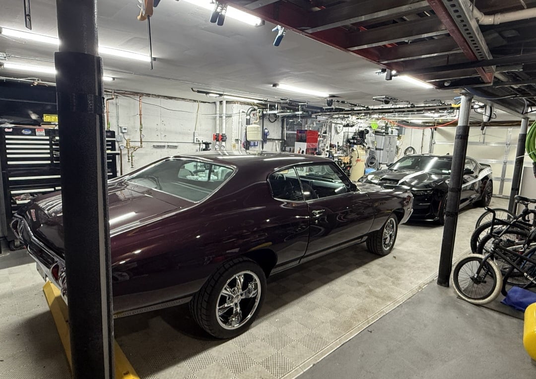

This is a 28 year learning and experimentation lab for me. As I learned better hydronic techniques and strategies, I would repipe accordingly. The Home has staple up Radiant, Mud Job Ceramic tile Radiant, Buderus Panel Radiators, Modine Heater for Classic Car 🚗 area. Mad Dog

Part of my redesign was to have these two boilers be able to operate either sides' system (Temporarily carry most of tje load) if one went down. Mad Dog

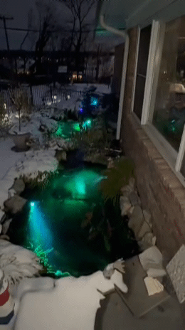

Not Bahamas water temps, be keeps it ice free while they semi-hibernate. Mad Dog
Looks like that can survive as low as 35° water temperature.

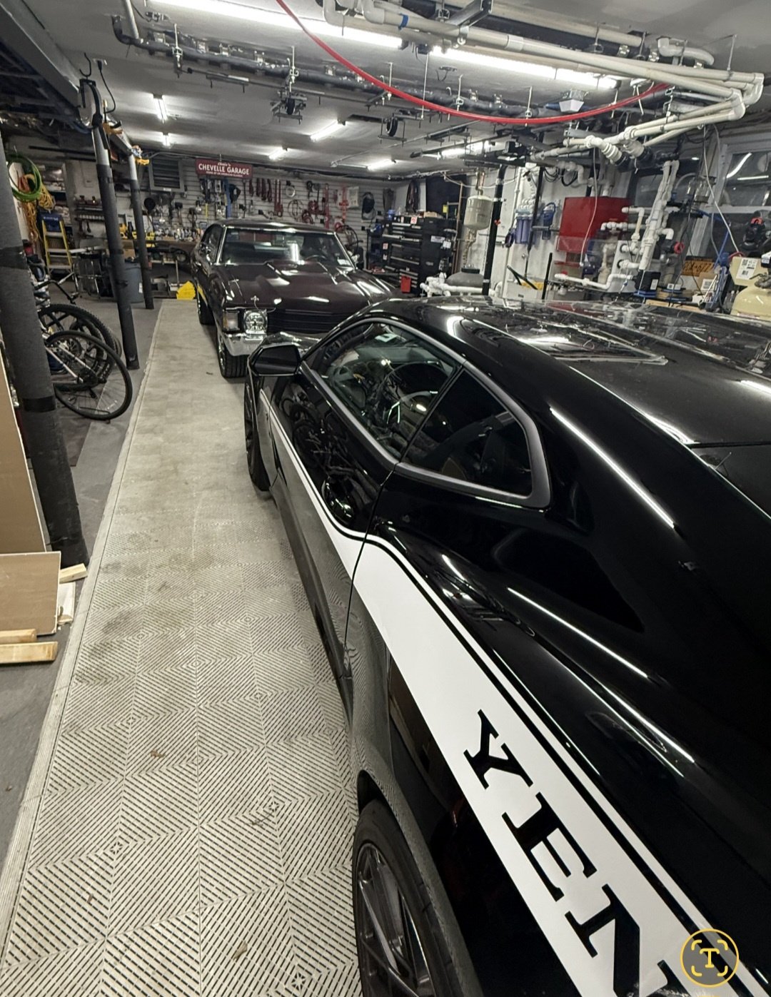

Like the protective stanchions. Does his move equipment thought the space?
