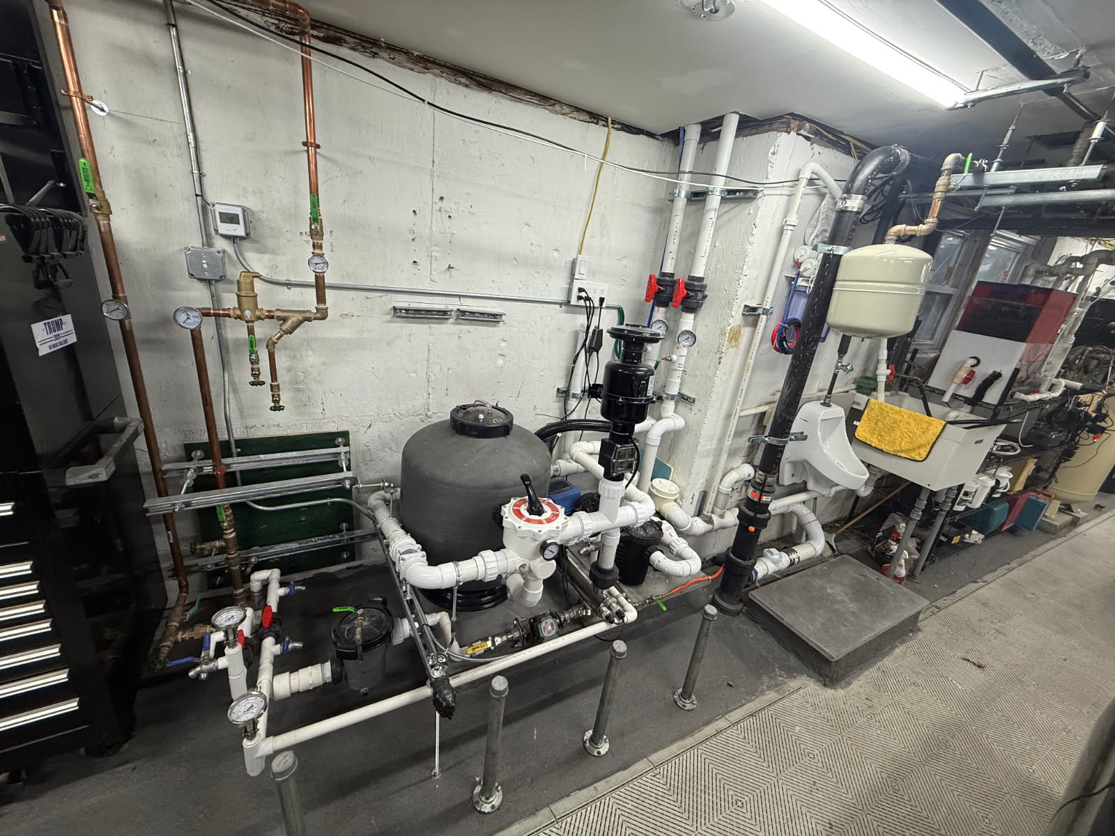

The mixing station and Flat Plate HX and pond filtration
1 -

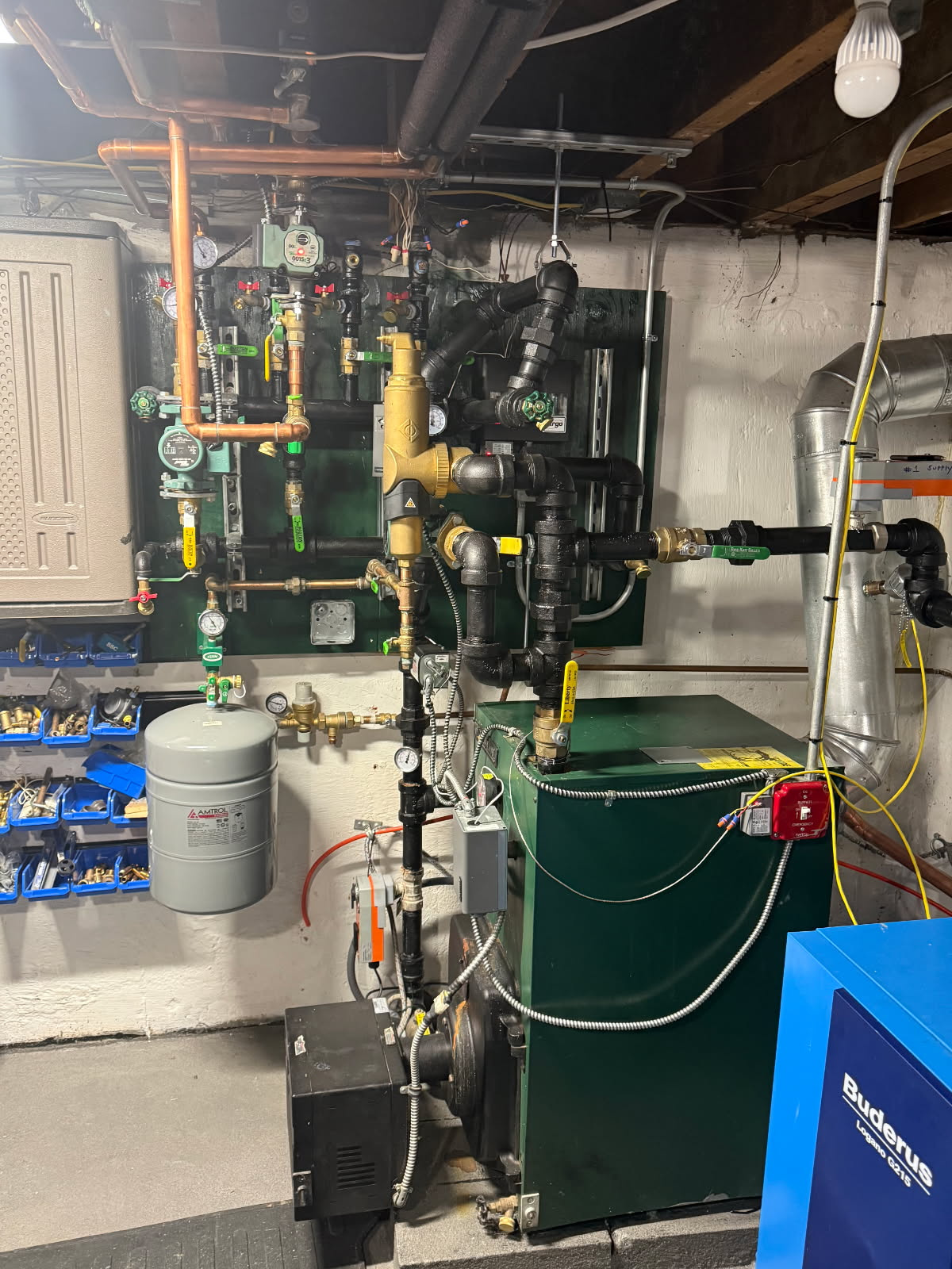

The Williamson on the left has been the dedicated pool heater/boiler for the Gunite pool for the last 25 years. I repiped for boiler protection (in a very tight corner and around his tool shelves) and to provide pond warming, so this boiler now gets year round use. WIRING BY OTHERS. Next time I'm there I'll bring a bag of zip ties. Mad Dog

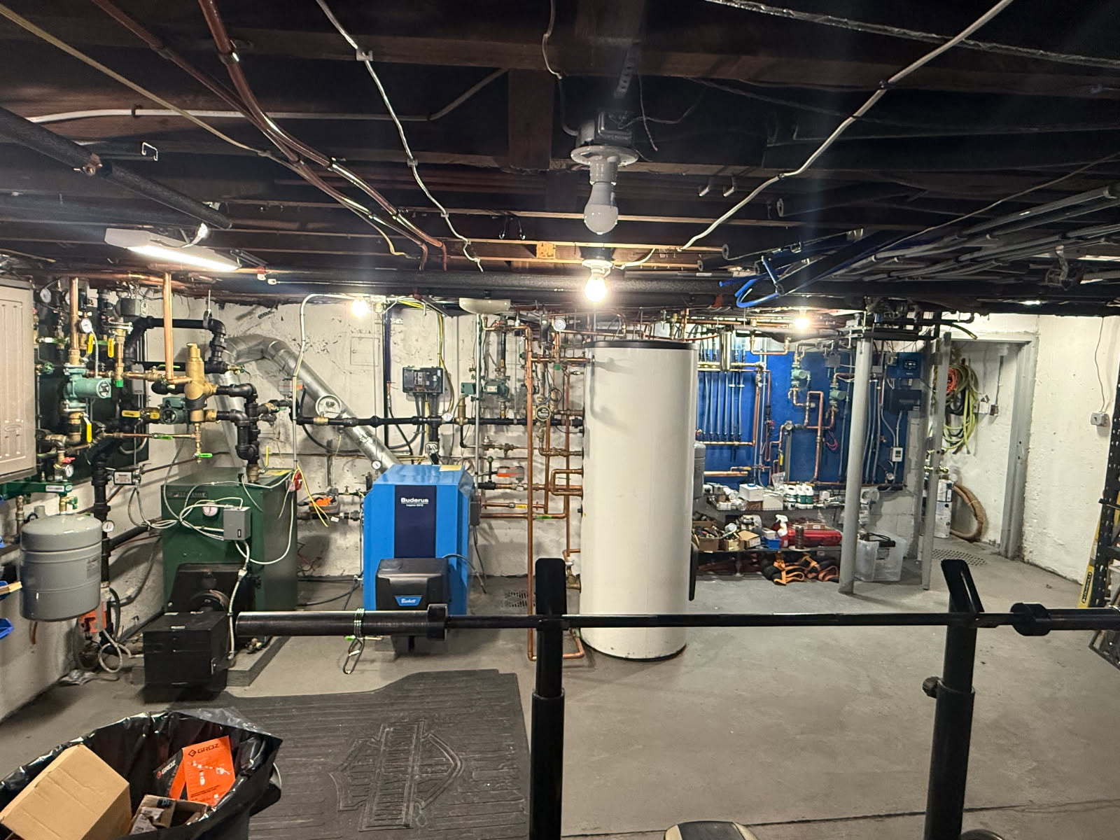

This is a 28 year learning and experimentation lab for me. As I learned better hydronic techniques and strategies, I would repipe accordingly. The Home has staple up Radiant, Mud Job Ceramic tile Radiant, Buderus Panel Radiators, Modine Heater for Classic Car 🚗 area. Mad Dog
1 -
Part of my redesign was to have these two boilers be able to operate either sides' system (Temporarily carry most of tje load) if one went down. Mad Dog

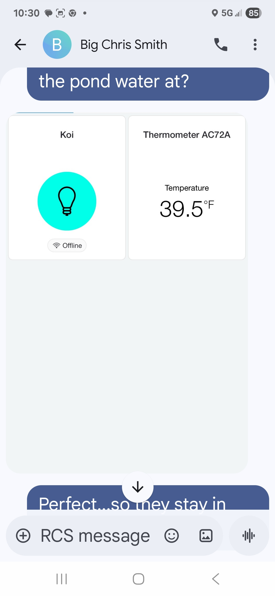

Great question. This is the first season and the data logger is getting installed next. The big concern was not boiling the Koi! Ha ha. Mad Dog

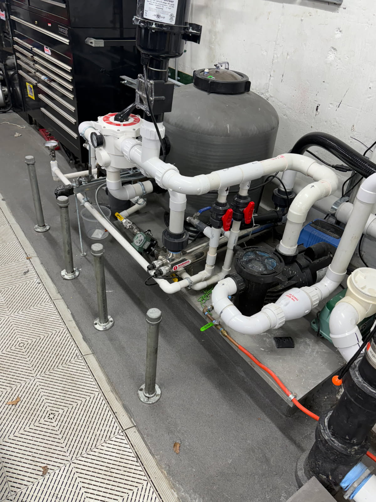

Another huge concern for me was using Koi Friendly PVC glue, no copper or brass either. Stainless steel as much as possible. The HX is an alloy. I even installed extra ball valves and drain stations to throughly flush out any toxins in the glue. Mad Dog

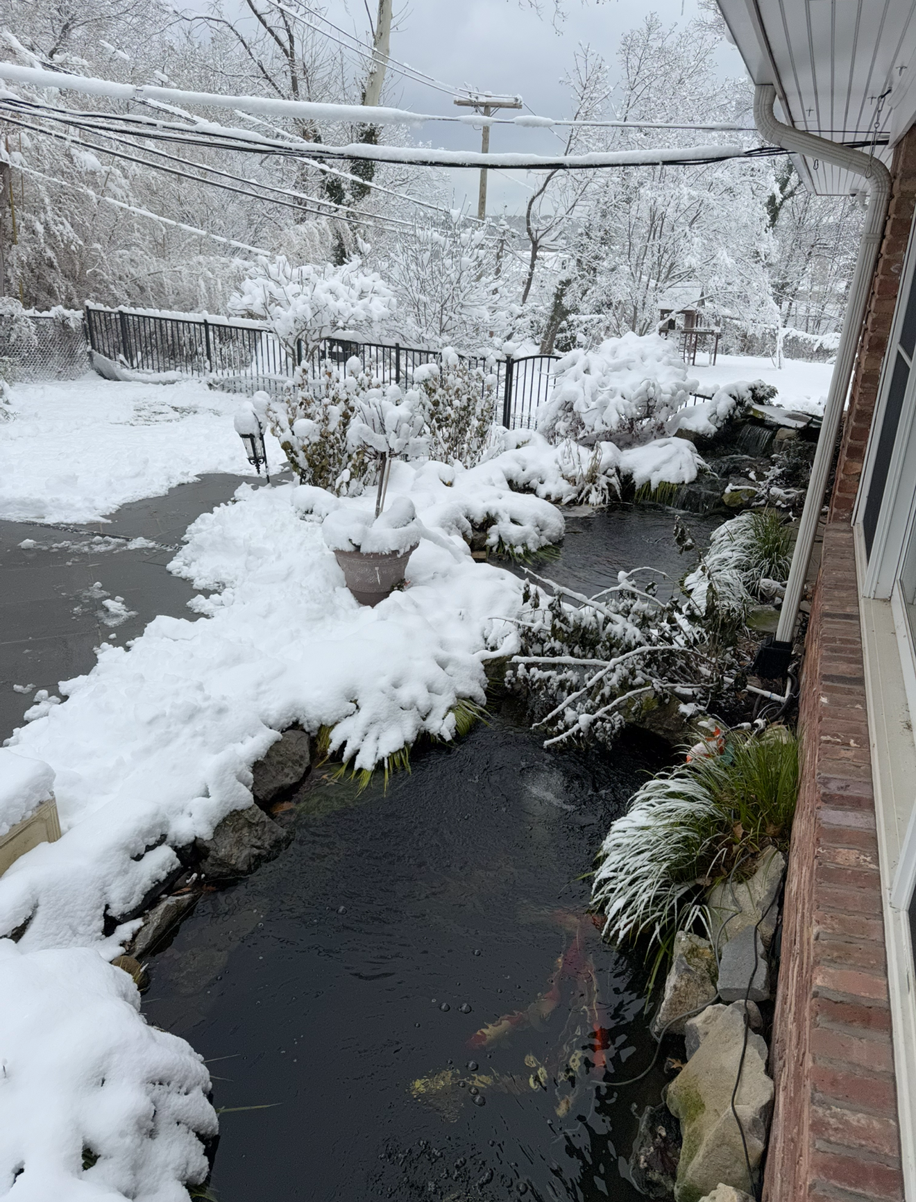

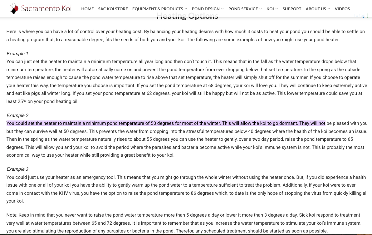

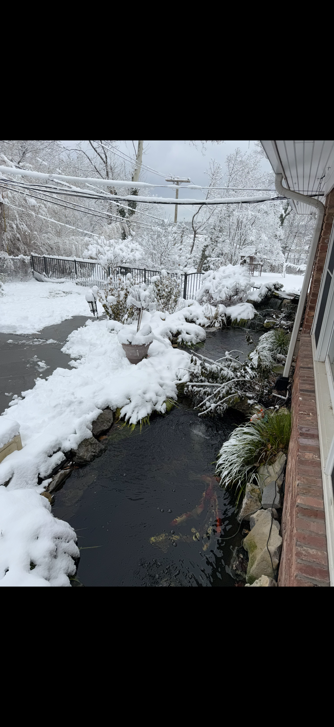

Not Bahamas water temps, be keeps it ice free while they semi-hibernate. Mad Dog
Looks like that can survive as low as 35° water temperature.

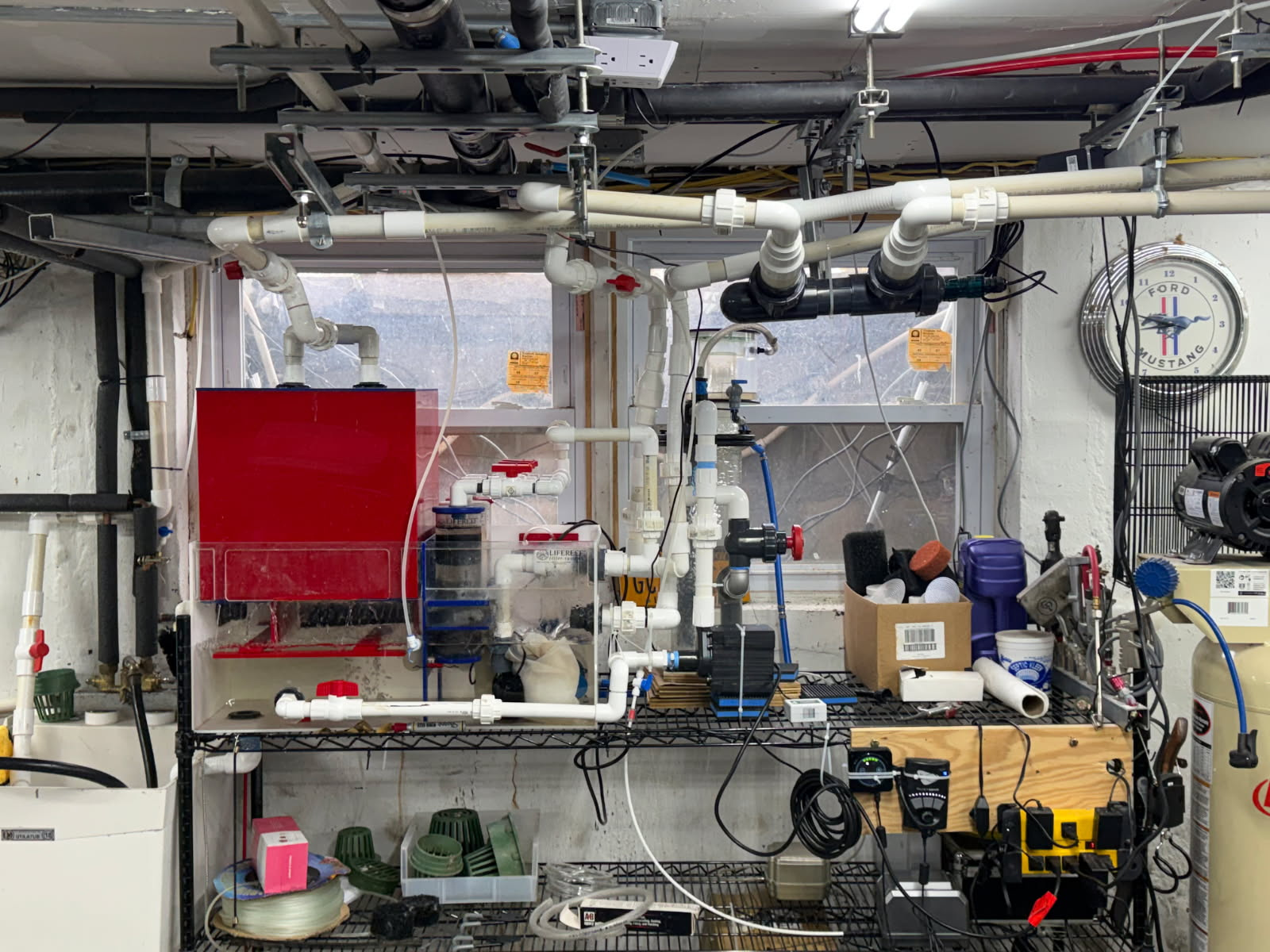

Yes...My client is a Mad Scientist tinkerer...He adjusts temps with his phone. I'll put up some pics of his protein collector. When we were looking at Colleges for Matt Jr years back we got a tour of some MIT Aquaculture labs. I took pictures and shared them with the client. This inspired him. Its not as elaborate, but its very impressive...New York Aquarium at Coney Island quality....Lucite tanks with all of cool piping. 😎 Mad Dog

Like the protective stanchions. Does his move equipment thought the space?
I didn’t know copper and brass are bad for Koi, was wondering why you used iron pipe.
PC 7060...Yes..they have deleterious effects on Fish, especially. Iron pipe? No iron pipe on the pond side of the Flat Plate HX. Mad Dog

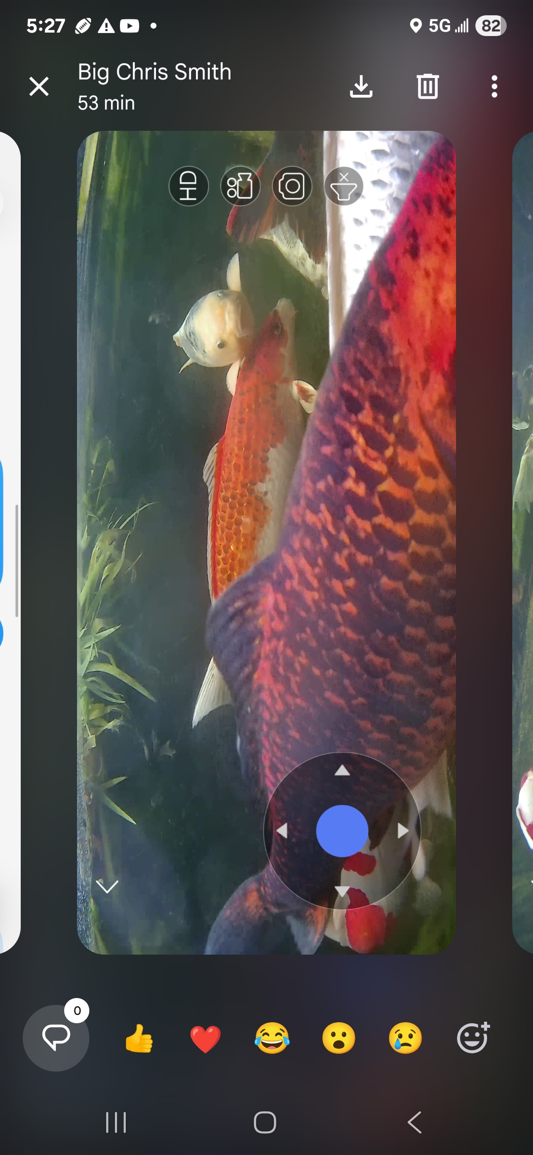

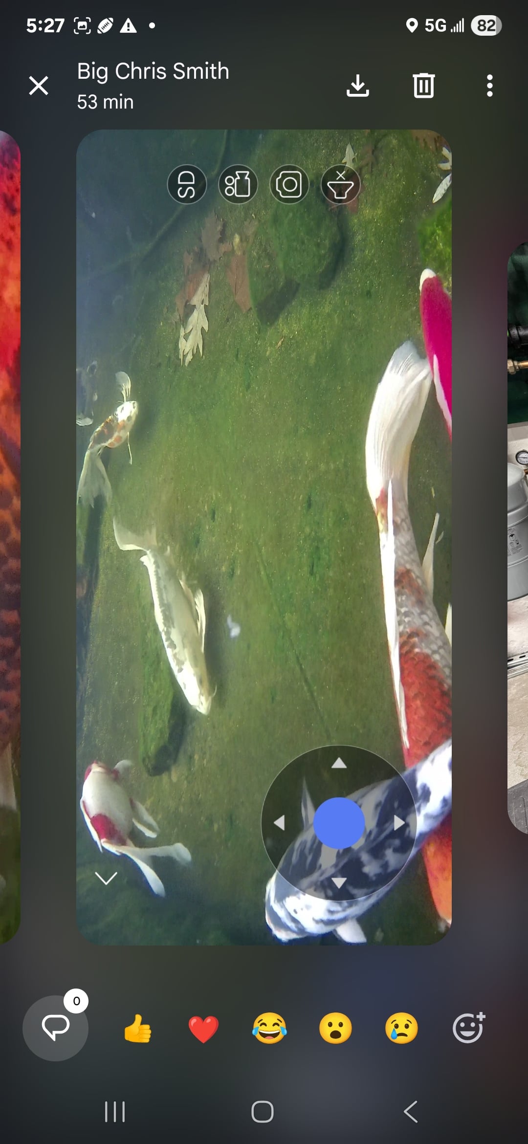

Isn't this cool..underwater Koi Cams...say hello...Mad Dog
