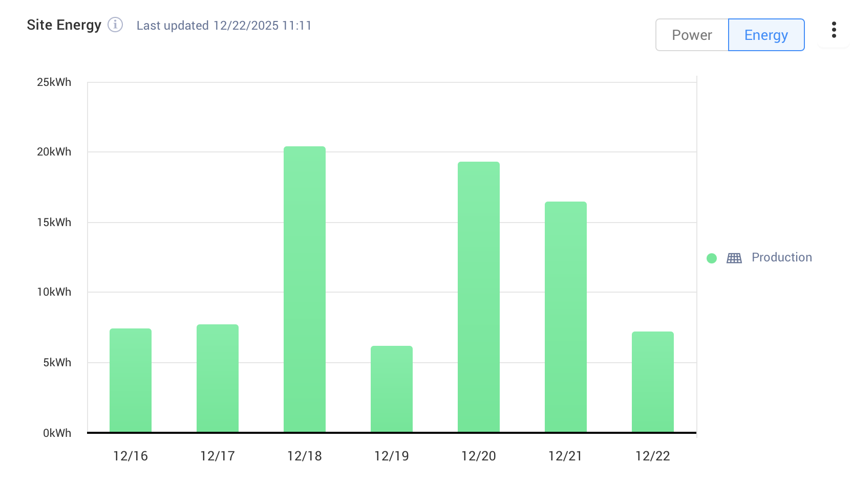

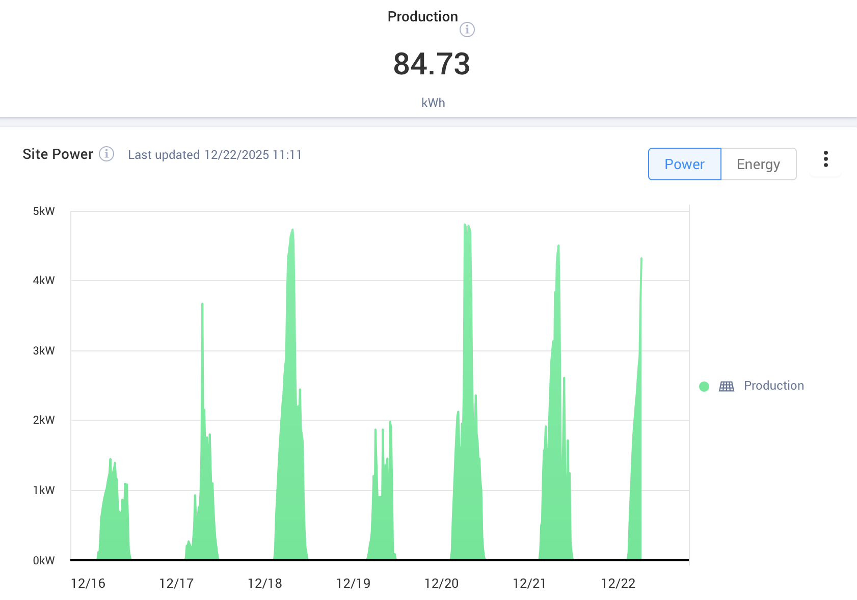

    Today is a nice sunny day on the day after the shortest day of the year. I should have really good production as the days get longer
    Here's energy, showing daily kWh (12/22 is full sun, but it's still morning):
    Here's Power, showing kW over time:

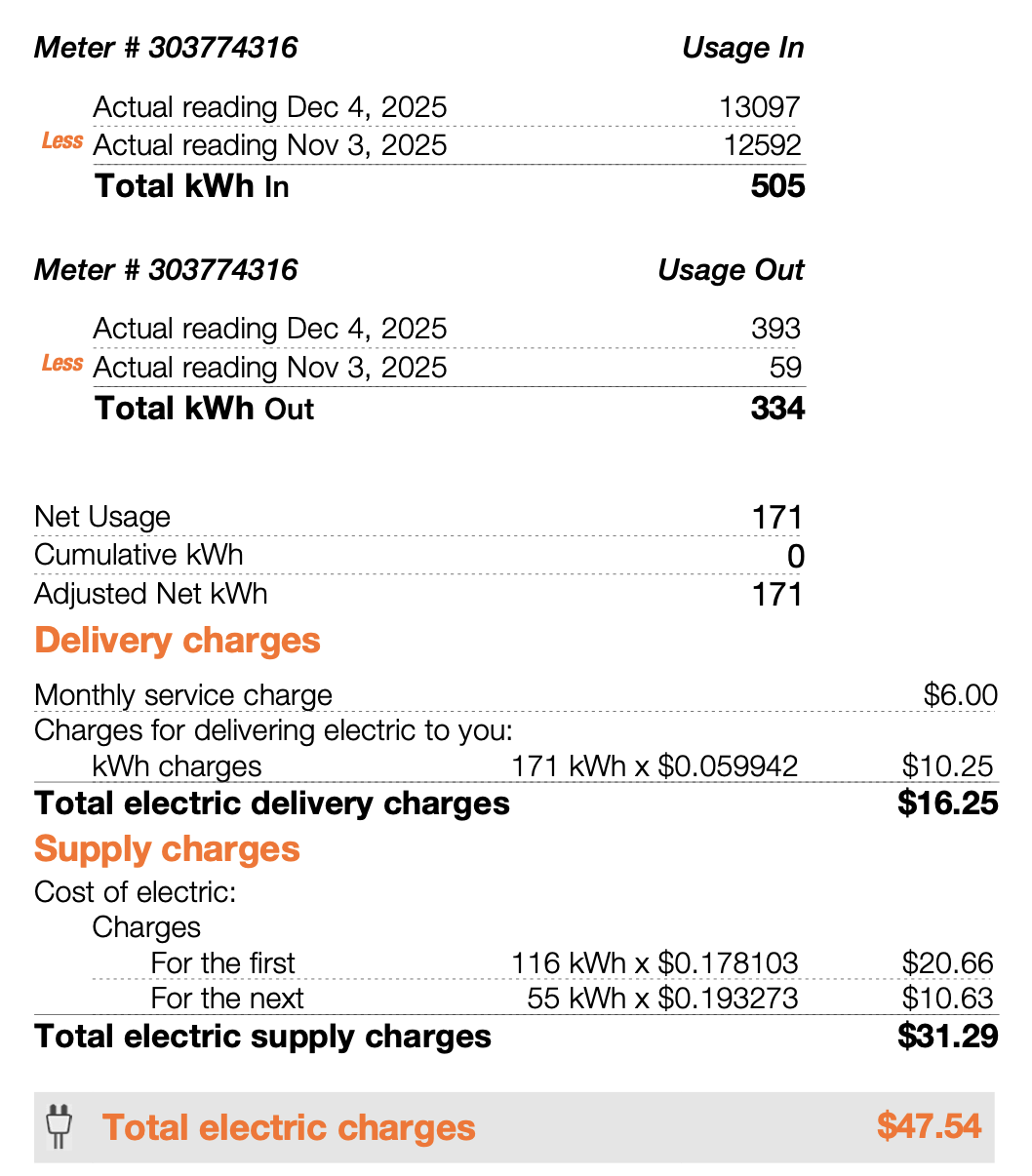

    In my first full month of November 2025, I had 438 kWh produced (reported from the solar provider).
    In the utility bill below, though, you'll see the numbers don't match up. This is because there is a number missing I think, and that is the number of kWh of my own production that I used (and so never got sent out to the grid, nor came in from the grid). So I think that number is 438 kWh produced minus 334 kWh sent out to the grid, which equals 104 kWh.
    But regardless for now I'm super happy to have output 334 kWh to the grid against 505 kWh incoming from the grid in miserable, cloudy, short-days November. It will be interesting to see which month I first break even, and then of course, the surplus starts piling up.
    One more note that I see solar naysayers talk about is the charges that remain on the bill regardless of solar generation, or "Delivery Charges". I will have the $6 service charge regardless, but look at the rest of the Delivery Charges. It is billed at $0.059942 per kWh. But it's only charged against the net incoming kWh which is just 171. That amount will soon be zero and should remain zero as I expect to be at Net Zero electric usage year over year. We'll see!

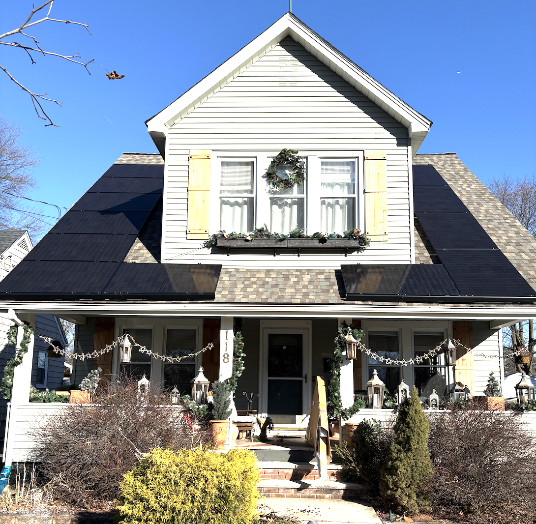

    I like the installation layout on the roof
    ethicalpaulIntplm.
    ethicalpaul Member Posts: 8,163
    Thanks! There are 3 on each side of the center gable as well. My wife was kind of bummed to cover up the new pretty shingles, but I have purposely asked several daytime visitors if they noticed anything about the roof and most of them don't even see the panels. People don't look up much!
    If you look carefully you can see there are two additional panels on the westerly side because I was able to position those in landscape orientation. They would fit that way on the easterly side as well (which is more directionally advantageous), but I couldn't do it on that side due to fire code placement rules.

    Interesting that the went to the roof edge on the left side. I thought code required a walk path around the entire array. Maybe two sides is all that is required?
    It passed inspection, so it must be code compliant, and they maximized the roof area.
    yes apparently they just need one side. I wanted it on the other side (better sun there) but the installers said the fire department likes the accessible side on the driveway side which I can understand
