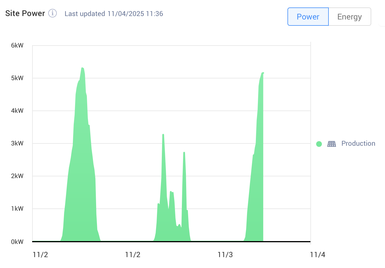

So production has begun and all seems good. Here is this Sunday, Monday, and Tuesday (today, partial):
11/2 was clear all day I believe, it was mostly cloudy yesterday, and today has started out clear. This shape will become very typical I believe, with it getting wider during the longer days of summer and narrower during the cold dark winter.

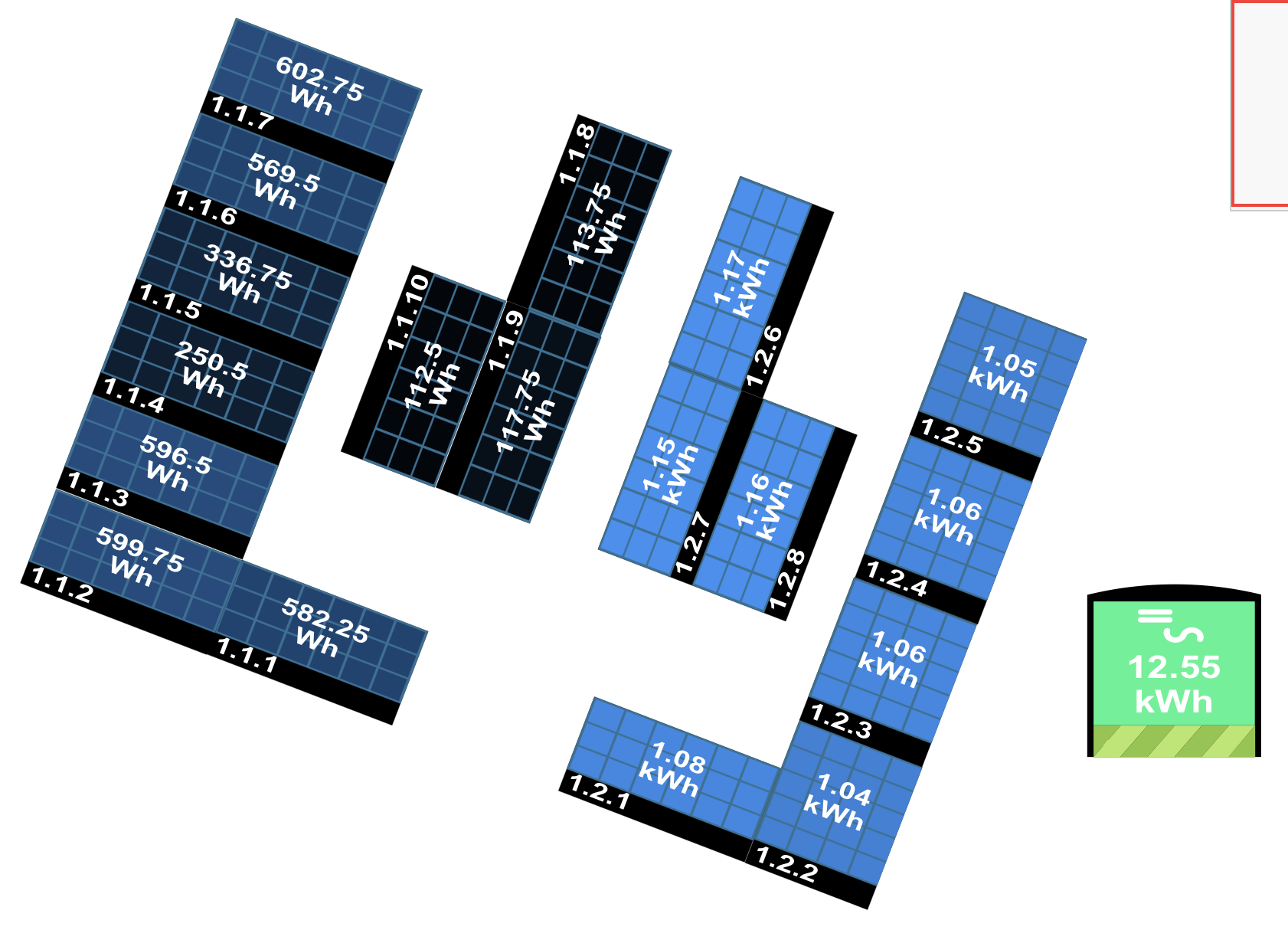

Here's the layout view, showing morning production. Afternoon will swing over to the west side of course:
