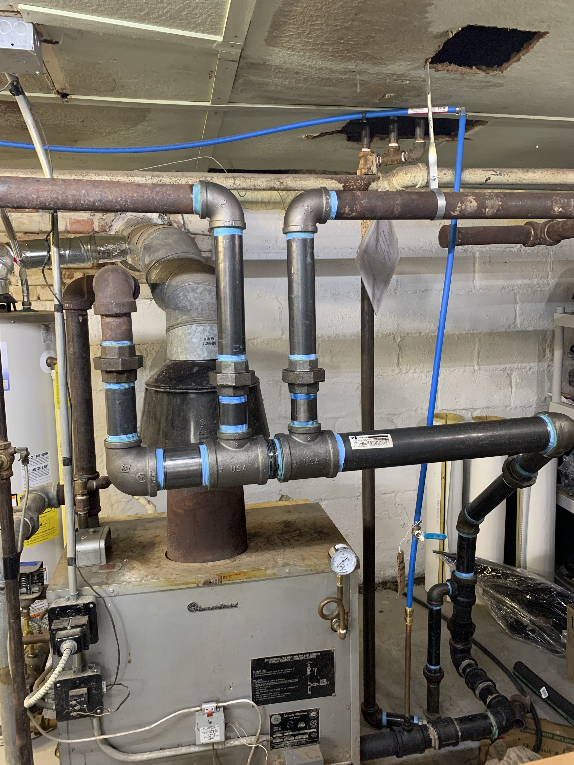

    I looked at the other recent thread. Your system looks like it has counter-flow mains (mentioned before) and that is a reasonable sized boiler with only one steam riser (steam velocity).
    Since it appears to have counter-flow mains yet I don't see any drips on either side of the boiler the keep the condensate coming back out of the header. Are there drips elsewhere to handle the bulk of the condensate ? Are the mains all insulated to minimize condensate generated in the mains ? Is the pitch of the mains correct ?
    The old system had some huge piping to help separate the steam and condensate. Although the steam supply directly under the Left main may have been problematic.

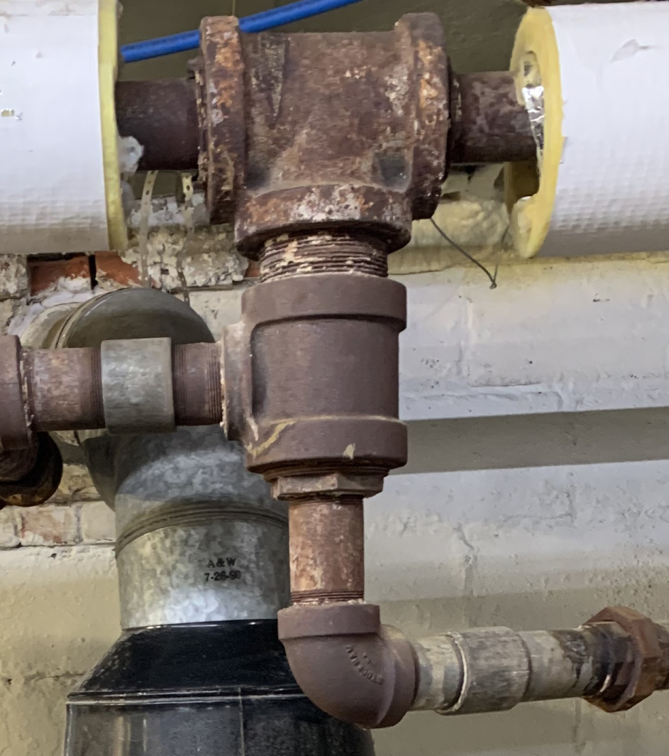

    If your mains are truly counterflow (the one on the left sure looks like it is) you need to add drips.
    The way to do this is as follows"
    Both risers come off the header. You want to install a tee immediately after the elbow at the top of the riser. The branch of the tee should look straight down. I would make the branch size 1" black and you can reduce it to 3/4" copper (or Blk pipe) below the boiler water line. You need a tee in both supplies if they are counterflow. You can ty both drips together below the water line.
    As far as skimming goes TSP or washing soda. the ratio is 1 lb/each 50 gallons of boiler water. You need to find out how much water your boiler holds by draining it into 5 gallon buckets. So if the boiler hold 10 gallons you would need 3.2 oz..
    mix it in a bucket with water and pour it in to the boiler through the skim port ot by removing the safety valve. Start the boiler and when the supply pipe gets hot shut the burner off before you get steam. Then add makeup water as slow as pissible and start skimming. A stream the size of a pencil is good. I have never had to skim more than an hour or so. Drain the boiler and refill, do this twice and then fill and run

    can you help me understand why it would need drips? Isn’t it the function of the header (3” compared to the 2” mains) the equalizer to move any water carryover back to to the Return and out of the mains ? Are drips for counter flow only?

    The larger header pipe is to reduce the steam velocity of the steam coming from the boiler so the water droplets can drop out and flow down the equalizer.
    The drips are so any returning condensate does not get into the header. I can see the returning condensate of the left main dripping through the steam flow.

    maybe what is happening is the combination of the header not being pitched toward the equalizer and the missing drips is causing it to retain that relatively small amount of condensate from the piping in the header and throw it out in to the mains.
    individually they are wrong but usually don't cause a problem, together they might add up to a problem.
    did it get better but not go away entirely when you insulated more of the mains?
    it looks like there is space to rotate the equalizer a little and tip the header that way.

    I think I may have found my solution with the help of posts here, Dans book and his and other videos I’ve watched. Also why changing my header and all the other things I’ve done and checked didn’t change anything.
    Here it is….
    my system is two pipe COUNTERFLOW.
    it was originally a coal fired system, and the mains are always warm with that system so when it called for heat there would be little to no steam condensate when the steam down through the mains
    … now it’s gas fired and mains are cold between cycles. The water in my mains are just from the condensate from the beginning of the cycle . I know this because once I purge / drain out that water in the main heats as it should.
    also there is no water hammer so I know it’s not pooling cold water . The water is the condensate from the cold main. Also why if I shut it down near the start of the mains heating up, let it set for a time and fire it back up problem is for the most part gone.
    So this would mean I need to add the previously mentioned by some, DRIPS to the HL near the boiler header to both of my mains so that condensate in the mains at start up can drain back.
    Thoughts ?

    The drips near the boiler may help, however that probably won't drain the far end, which seems to be your primary issue and concern.
    I only see a few options from here;
    Increase the pipe pitch, (are the pipes even sized correctly ?) a lot of work and expense.
    Add a dedicated return to drain the ends of the main(s).
    Custom boiler burner timing control. Call for heat, burner on, warm up the mains, shut the burner down, let the mains drain, burner on to heat the home until the thermostat is satisfied.
    The custom timing thing is probably not very efficient, from your experiments it probably would work. And it may be hard for most folks to implement and others may not understand it.
    Adding a dedicated return to drain the ends of the main(s) is probably the most practical resolution.
