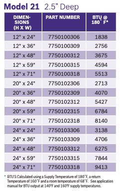

The first is easy, costly but easy, I can swap the 24x12 buderus (1838) with a 24x24 (3138) btus, so around a 1300 increase. Sorry now my question.

    I second the bigger panel radiator.
    You will not need to re-invent the piping. It is really plug and play.
    There are lots of options to go taller and thicker.

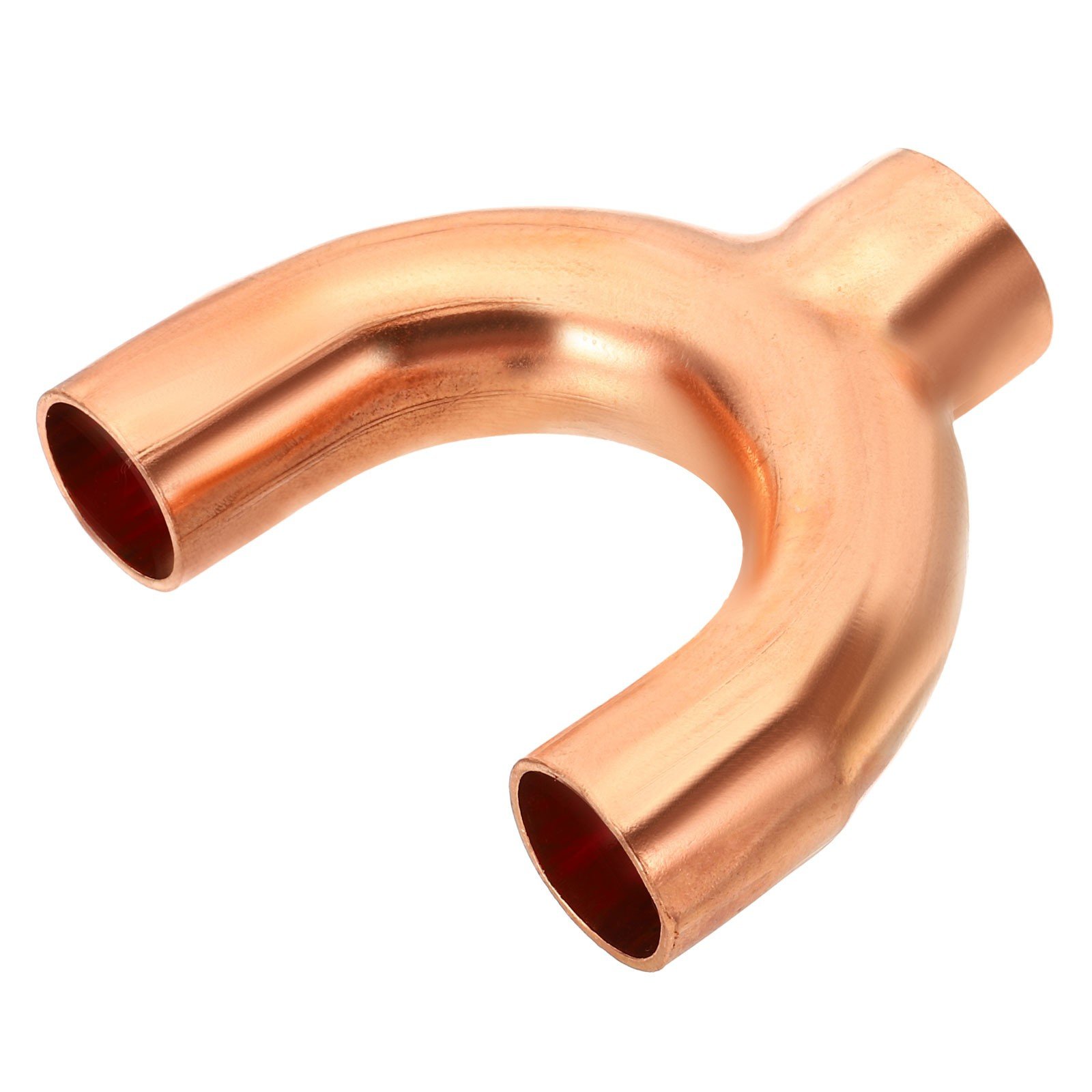

    Another question, What if I went back into the wall on the Supply and return side and put this in, then run 2 pipes into both elements, Then come out as 2 pipes and back into 1 pipe?? Better/worse idea?
    mattmia2 Member Posts: 17,906

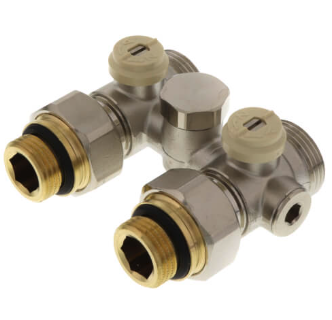

    how you connect the ends is much less of an issue. the question is what is the pipe size and size of the path through that radiator fitting. is that fitting 1/2" or 3/4" and is the path through it a full 3/4" is it is?

    if the panel radiator is in series, i am concerned about that h fitting restricing flow

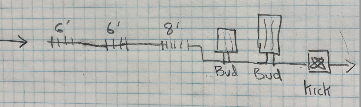

    Maybe I should give you a little more info on this loop. There are 2 - 6FT fins, 1 - 8ft fin, 2 Buderus rad's one 12x24 and one 24x36 and one Kick under the kitchen sink. And right now, I have not seen a TEMP drop on the 2nd rad in series.
    is this a single series loop or are these fed off of separate supply and return mains or manifolds?
  • TerrS
    TerrS Member Posts: 202
    Correct, 1.5" supply manifold, feeding 4 zones, single supply/return for each zone ending in a return 1.5" manifold.
    hot_rod Member Posts: 28,078
    Is it piped like this, everything in a series row?
    The 1/2" H valves will be the flow restriction, as you try and get more output.
    Knowing how much more BTU/hr would help determine what is possible.

    Yes mostly, its actually, 3/4 Caleffi into small rad, then 3/4 into 6ft fin, Loop with 2 - 3/4 - 1/2" diverter tee's to push water into the Kick, then another Caleffi valve into the bigger RAD, then into the 8ft fin and the 6ft fin and then back to the boiler, all feed by 3/4 copper.

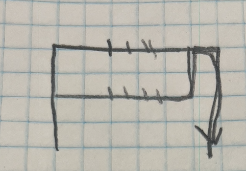

    I don't really agree with the reverse return sketch. The bottom element has flow through the branches of two tees. The top element flows through 2 tee runs and 1 90 deg ell.
    I was thinking like this

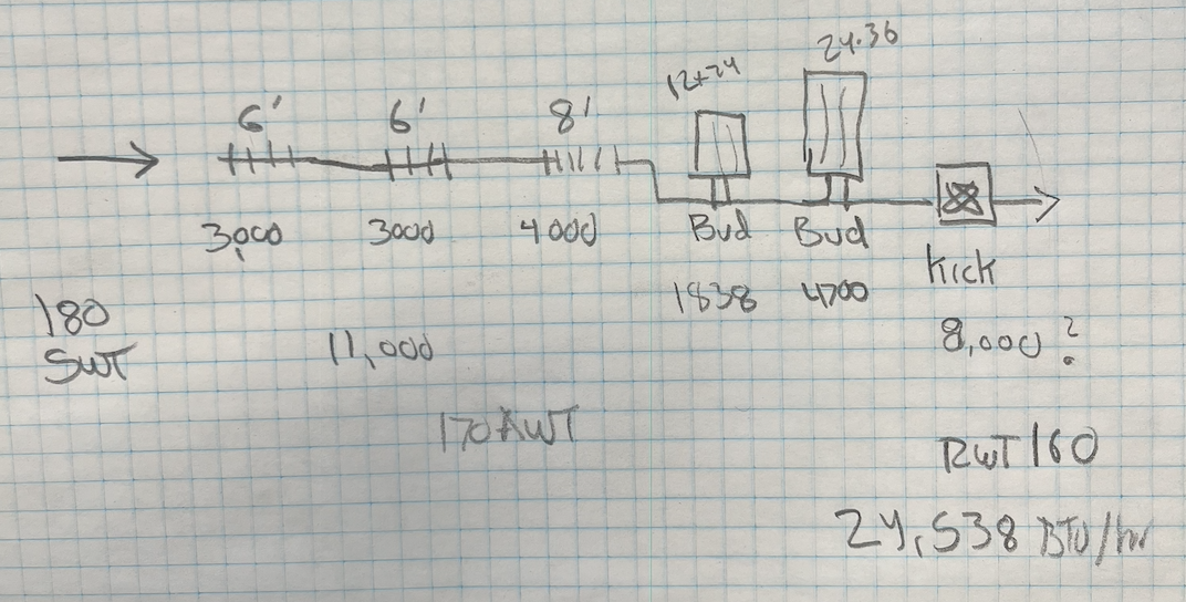

    My numbers look like this, depending on what the kick is rated at?
    You mentioned a 7 ∆, so if you are flowing 2 gpm. \
    so 500 X 2 gpm X 7°= 31,000 BTU/hr from all the emitters
    If you have more accurate numbers plug them in. 2 gpm may be a bit high through those H valves

    I agree with your numbers, but this is where who ever plumbed my house back in the 40's probably, they didnt pipe it all by floor, they piped it, Attic, in 1 loop, 2nd floor in a 1" feed loop, then the 1st floor and basement, front of the house, back of the house. So the problem I am trying to help/fix is the back of the house, but specifically the basement which has a bedroom with 1 6ft emitter, bathroom 1 6ft emitter and common area with just the 24x12 rad. The front half of the basement has more emitters.
    So my thinking was increase the rad to 24x24 and try to increase the bathroom fin to something like the HE2 to increase those total BTU's, since the doors are all open I was hoping it would all mix together and bring the temperature up by 1-2 degrees which is what I think I am missing. The kitchen and dining room are okay temperature wise with the rad and kick. the 8ft is in the dining room and okay.
