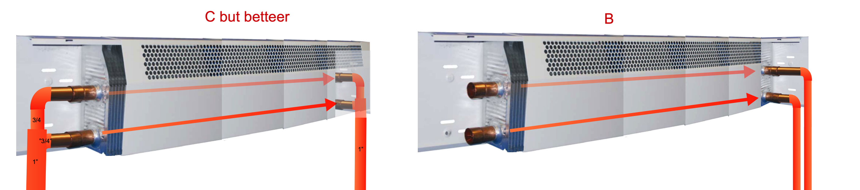

So I have hit a snag in my heating which In one area of my house I just dont have enough elements / BTU's to keep up.. I mean it eventually does, but not really. The area has some insulation and is the combination of a basement with 3 rooms, 2 - 6ft slant-fins and 1 - 2ftx12" Buderus radiator, and I really dont have any room to increase length. So 2 @570 x 6Ft = 6840BTU and the RAD at around 1838 BTU's or around 8678 in total with 180 degree water, and I really should have around 10-11K BTU of output. So I am looking for way to solve.
The first is easy, costly but easy, I can swap the 24x12 buderus (1838) with a 24x24 (3138) btus, so around a 1300 increase. Sorry now my question.
The smith HE2 baseboards have a dual element (pics enclosed)
Could I use the same single supply with a Tee and 90 as input, and then Tee and 90 on the output side to complete the connection? I think there is something about water collision or maybe the supply top element doesnt get enough flow, because of water path of least resistance?? Can someone please explain if this would work to increase the Output BTU's??
Or cause other issues.
Thank you.
Terri
he21.png 168.2K
HE2.png 105.7K
    Yes as long as the existing pipe will give you enough flow. To get the most heat out of it pipe the supplies to one end of each element and the return to both opposite ends.
    But when you pipe it on the return end, put a tee on the lower element, bring the return line to the boiler into that tee to up to the upper element. At the upper element put another tee with a air vent on it.
    On the supply end put the tee on the top element. Feed this from the boiler and continue it to the bottom element . This balances the flow between elements. Another tee on the lower element instead of an elbow to attach a drain valve if needed.

  • If piped direct to the supply and return like B there will be more heat than if you did the return loop like A.

    i think they want to go with option c and use a tee at each end
    hot_rod Posts: 28,705
    the output chart shows the difference in piping method and btu output.
    Two parallel flows are the highest, the footnote indicates 1.5 GPM minimum to obtain that
    EdTheHeaterMan Posts: 12,948
    edited December 2025
    Then that will cause the individual pipes to get 1/2 flow. That will work better if they feed with 1" using a 1x3/4x3/4 tee.

    I think B would work fine.
    Or reverse return it if there is room in the enclosure.
    Reverse return makes both piping paths equal so they balance flow

    Another question, What if I went back into the wall on the Supply and return side and put this in, then run 2 pipes into both elements, Then come out as 2 pipes and back into 1 pipe?? Better/worse idea?
    how you connect the ends is much less of an issue. the question is what is the pipe size and size of the path through that radiator fitting. is that fitting 1/2" or 3/4" and is the path through it a full 3/4" is it is?
    also if they are in series there will be a temp drop through the panel radiator so you'll have to use a lower average temp when calculating the baseboard output.

    I don't really agree with the reverse return sketch. The bottom element has flow through the branches of two tees. The top element flows through 2 tee runs and 1 90 deg ell.
    I was thinking like this
