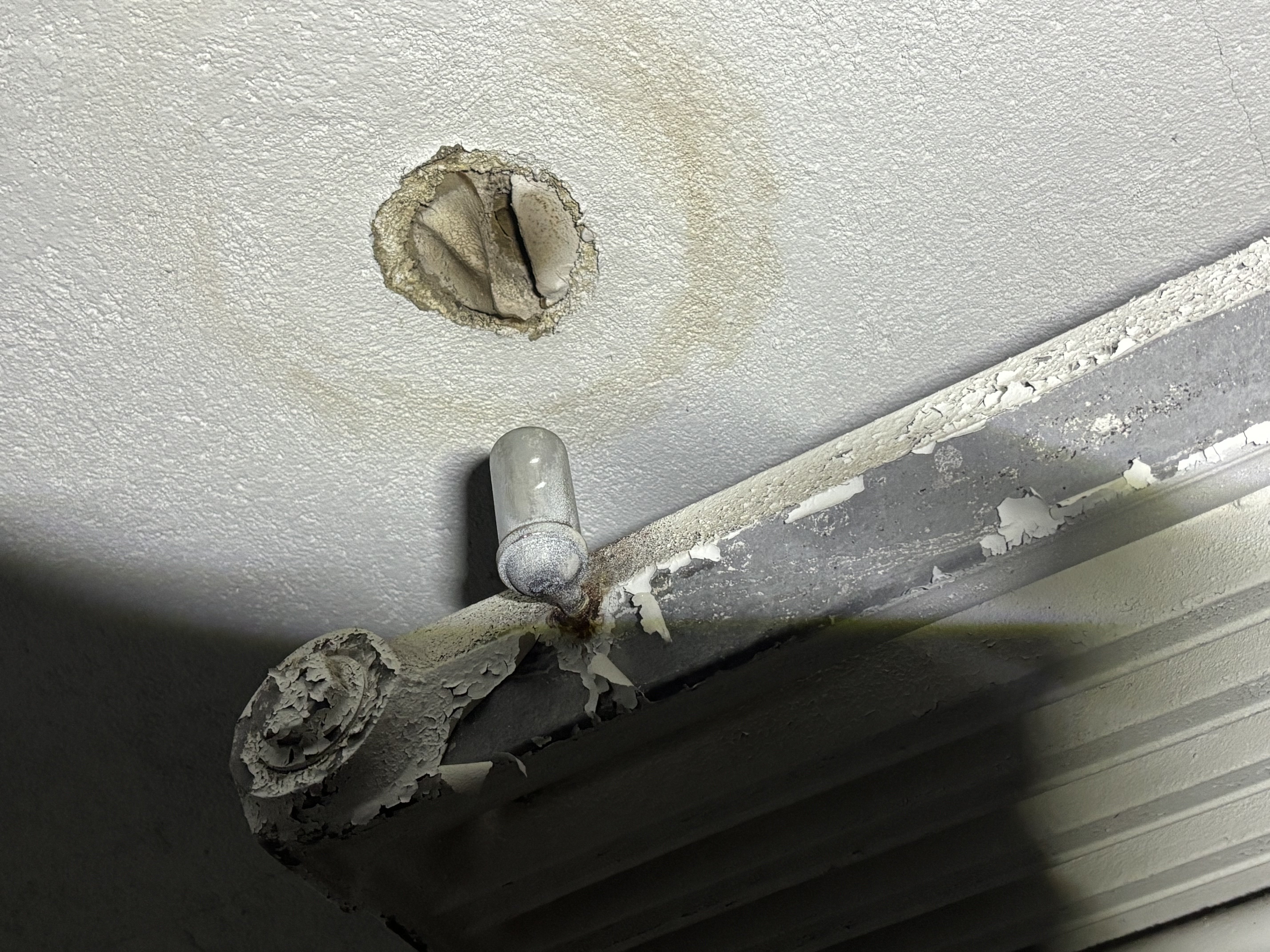

I moved into a new apartment this Fall, partially because it had old-fashioned steam heat. Which if you've never lived with a well-functioning system, it really is amazing.
Then the heating season came, and my radiators started blasting out a terrible mix of mostly air, with maybe a little bit of steam. Dropping the humidity in my unit into the mid 20s and making my place a living hell most of the time.
I'm a guy that tries to find the reason something isn't working. Which led me down into the basement. Where I realized that two of my radiators are attached to counter-flow branch, with very little pitch. And as far as I can tell, is basically run as a "total loss" system.
I've attached some photos.
First, a demonstration of the kinds of pressure that must be going on in the system. Enough to strip everything off this radiator down to the metal.

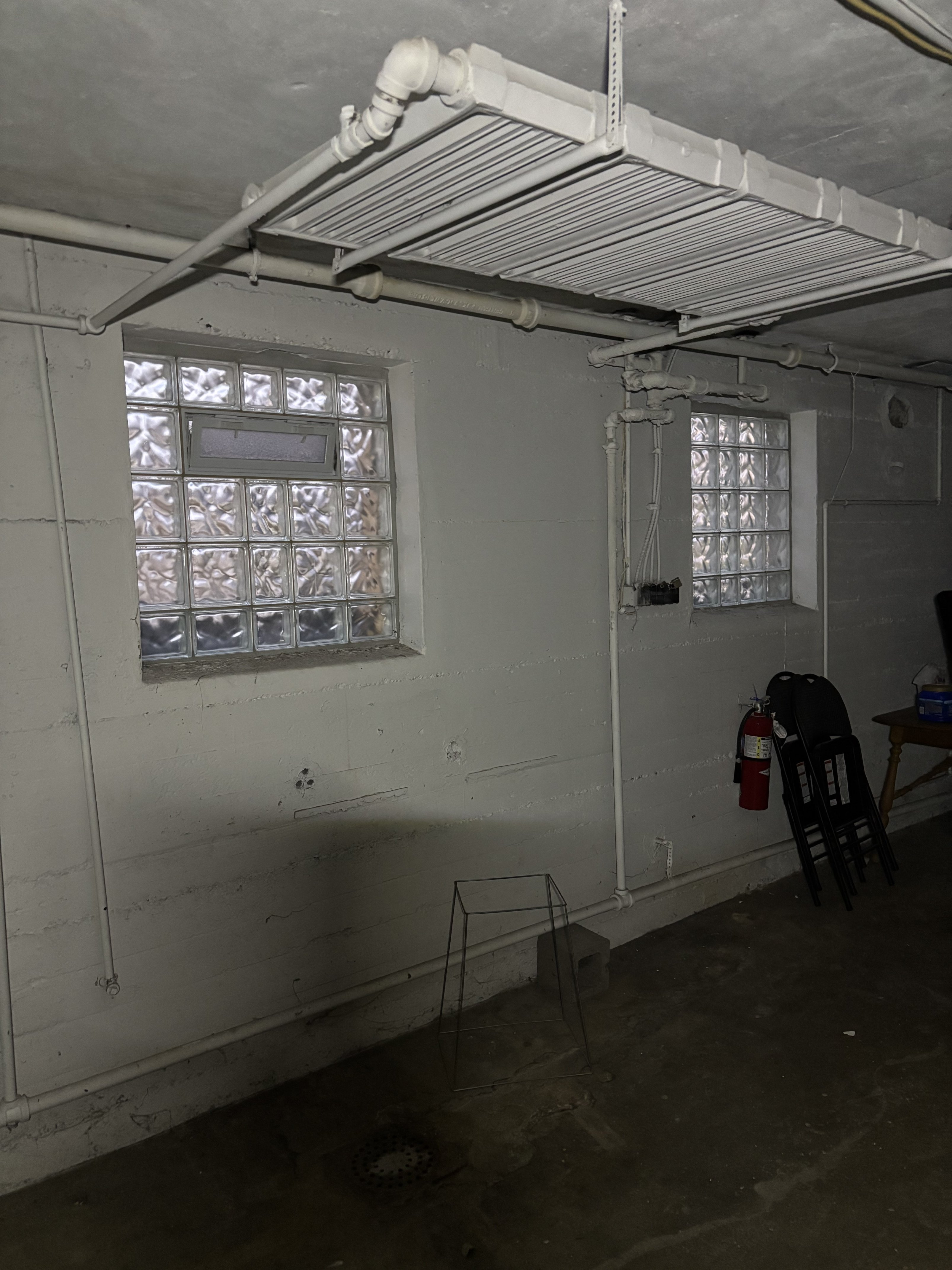

Second a 2-pipe (??) radiator in the basement attached to the same steam main.
And third, an air vent (I think) that's attached to another horizontal radiator (also 2 pipe) much closer to the boiler than my radiators.

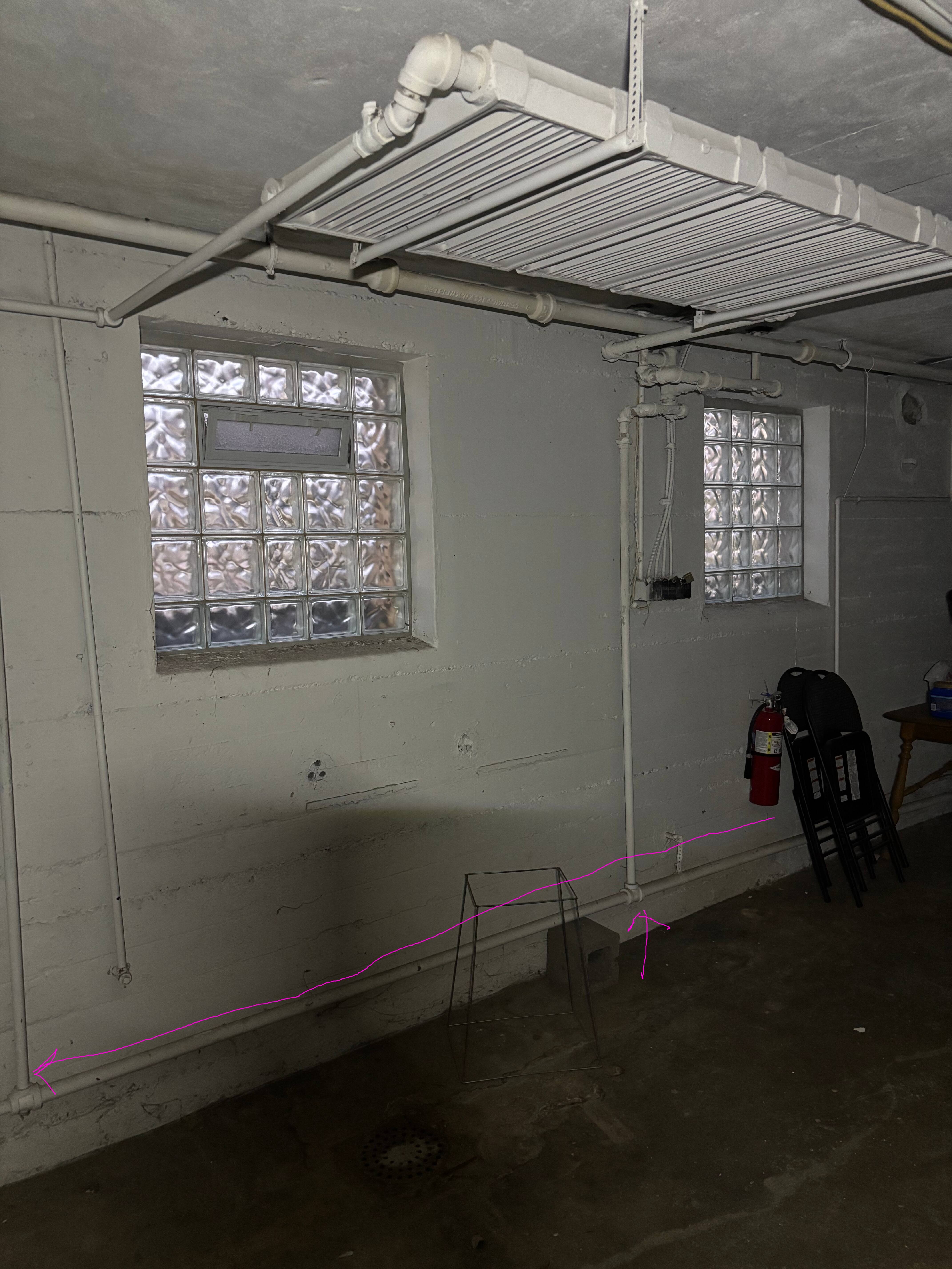

    I try to avoid closing/opening the inlet valve, but I'm pretty sure the system is at far too high a pressure for the vents to have any control. And sometimes it's just plain too hot to live in here, even with all windows open, or the AC units blasting.
    Almost no pitch along the whole length of the pipe. Also a 2-pipe radiator attached to the same pipe.
    mattmia2 Member Posts: 15,608
    wet returns don't need pitch.
    the basement radiator is set up 2 pipe because it is below the main, the condensate can't flow up hill to the main so it needs a drip to let the condensate in to a wet return.
    the flaking paint and plaster is from the moisture from bad vents that aren't closing. the pressure may be too high for then to close properly but the reason the paint is flaking is because steam is leaking out the vents.

    KC_Jones Member Posts: 5,907
    If you are talking about the ceiling radiator, one end is piped into a wet return, the other end appears to go through the ceiling, but the picture does not show that too clearly. If the ceiling connection is the feed, the other end goes into a wet return, they are indeed separated by the water that sits in that pipe at all times.
    Water is commonly used in a steam system to create a separation so the pressure differential can allow for steam movement. In this case the steam feed, to the vent, the outlet goes to wet return so it doesn't see the steam, so you get steam flow based on the installed venting on the mains and the radiator.
    Not getting steam where it is desired in a 1 pipe steam system comes down to venting. The mains need adequate venting to get steam available to all radiators at about the same time. Then the radiator vents handle venting of the individual emitters as required. Sometimes so slow that they barely heat at all. I have that in my own home with some large radiators vented slow enough they heat a maximum of half way and only on the very coldest of days.
    As far as pitch, I wouldn't get too wrapped up in that. Only steam carrying pipes need pitch in a wet return water seeks it's own level and flows based on that. If a return is above the water line, then yes pitch is appropriate. For the counterflow main you discuss (I didn't see a picture) the pitch needs to be 1" in 10' based on being counterflow. Parallel flow needs 1" in 20'. So if you are talking about the pipe near the floor, that does not need pitch.
    To be crystal clear, I do not see a steam main in any of the pictures you posted.
