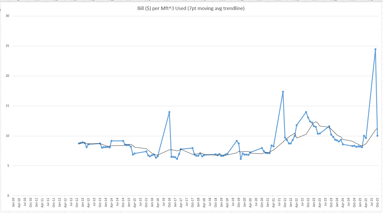

    Here in Michigan our gas cost/recovery published rate is about $3.36/Mcf. I track my Mcf usage and bill amount each month ($/Mcf) which of course shows the impact of real total charges with surcharges. The spikes in the data are just the result of shoulder months where very little gas is used and thus the fixed costs grossly skew the $/Mcf. Nonetheless maybe this can give you some comparison. Again the house is about 4500sqft with 12ft ceilings (1890), updated upstairs windows but otherwise pretty much original.
