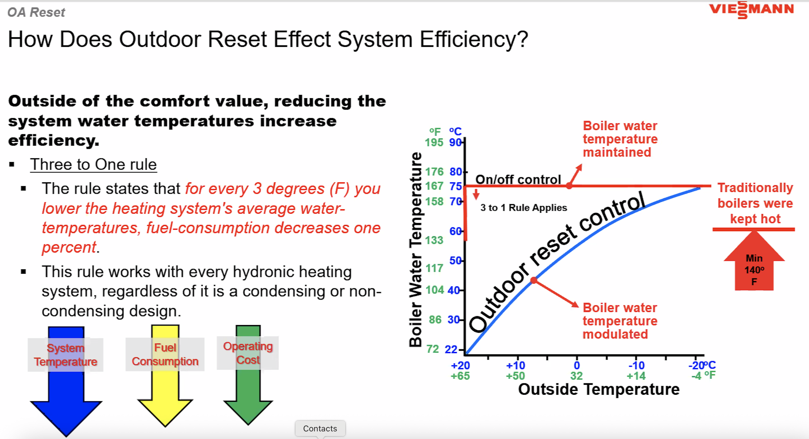

    hot_rod Member Posts: 26,497
    differences between oil and LP is LP boilers can modulate to the load and run condensing temperatures when conditions allow.
    That is as if not more important than condensing mode in a zoned system
    So to do a fair comparison you would want to look at your heat emitters, can they run at condensing temperatures for part of the year? 150-160 is about as low as you can run an oil fired boiler. There is no low limit on condensing equipment.
    Also historical data for various energies is available online. There is more to the number crunch than just the fuel cost difference

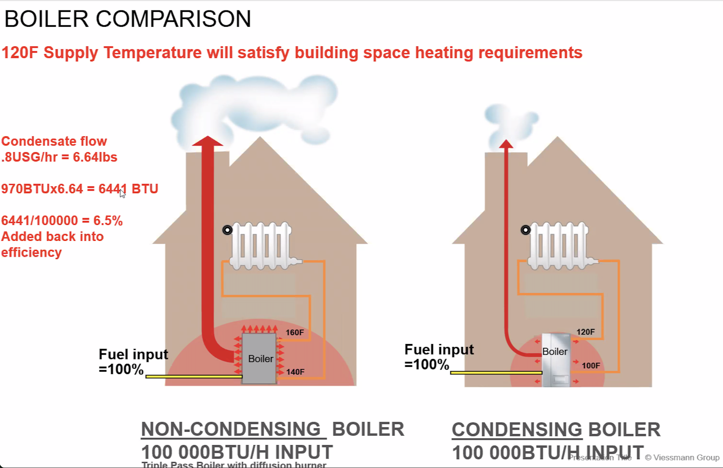

  • ChrisJ
    ChrisJ Member Posts: 17,051
    In regards to condensing, isn't that determined almost entirely by how the radiation is sized?
    I.E. if grossly oversized, the system should spend most, if not all of it's time condensing? Would radiant floors tend to allow a boiler to run condensing all of the time?
    Curious if the modern 95-98% efficient forced air furnaces are also condensing, and if they are I assume that's all of the time unless there's something severely wrong with the ductwork?

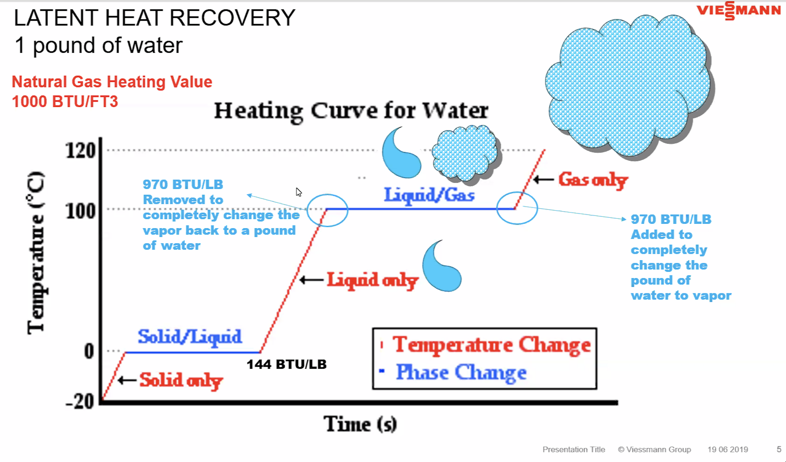

    Yes, it's the return temperature that controls the condensing at the boiler. So low SWT, or a wider delta can help keep you in condensing mode.
    So run condensing mode as often as possible, use modulation, enable and configure step delay, outdoor reset for long even cycles.
    Screenshot 2025-12-16 at 8.28.50 AM.png Screenshot 2025-12-16 at 8.29.24 AM.png Screenshot 2025-12-16 at 8.30.02 AM.png
