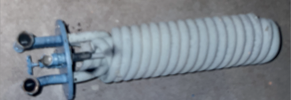

    hot_rod Member Posts: 27,080
    This was my experience with a finned coil tank, less than 1 year into the tank the owner started to notice DHW production falling off. I did the boiler work, a different plumber supplied the indirect. Guess who sorted it out.
    Yes it was hard water, but…
