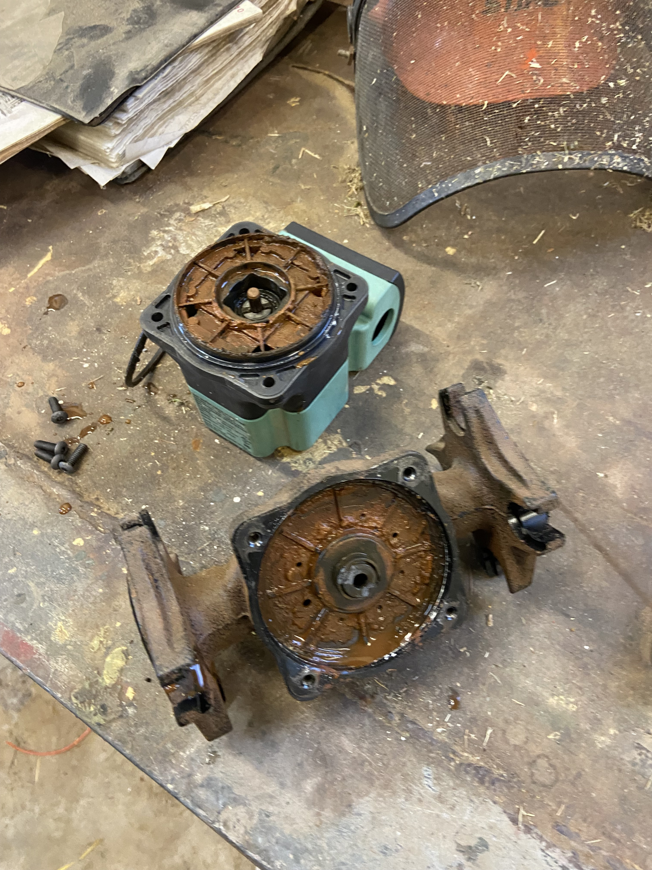

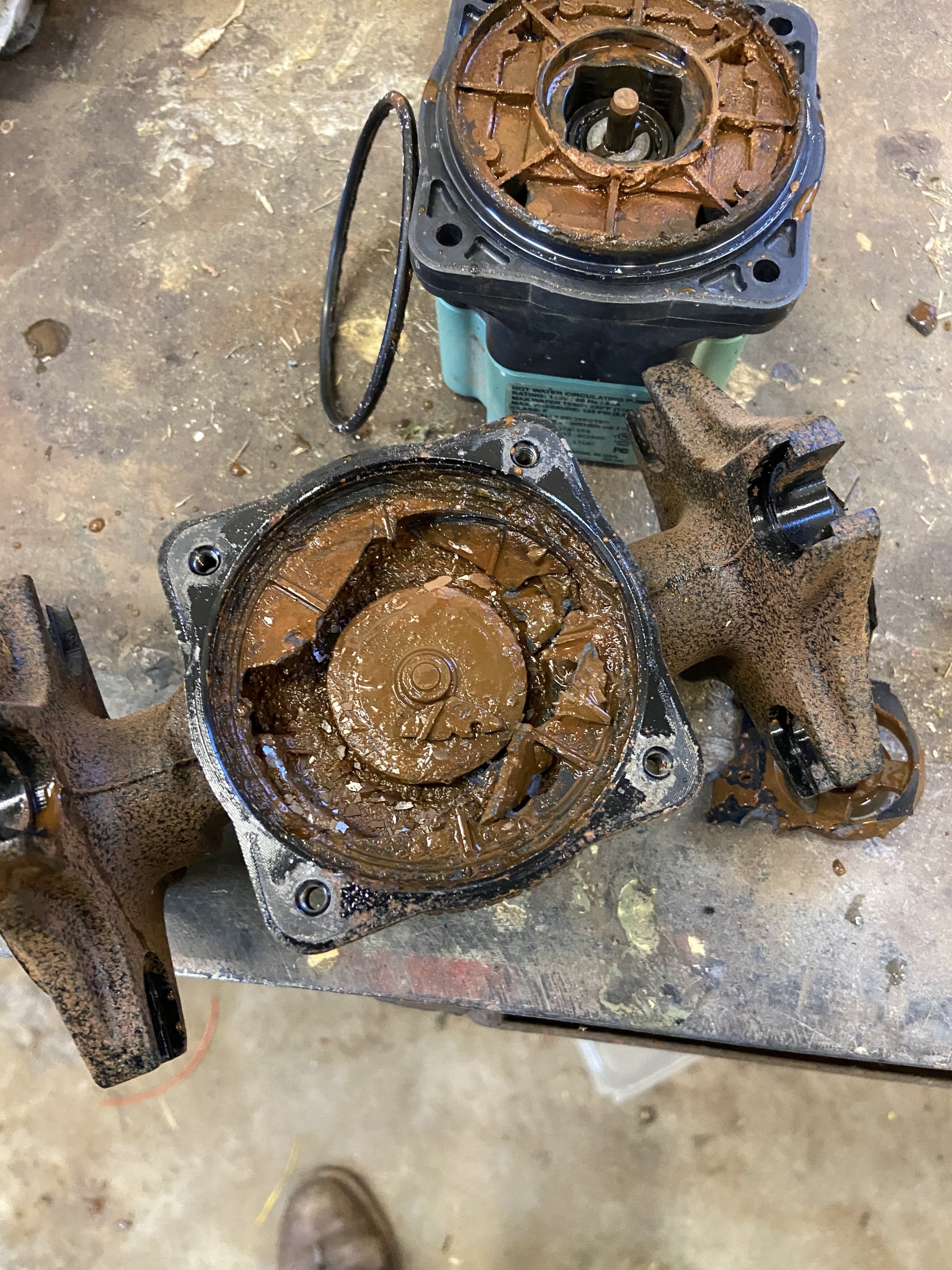

My heat exchange from 200k res steam boiler set at 190degF to a 30 gal superstor set at 180degF is pathetic… looking at interior water quality after replacing a circulator I’m suspecting the SSU30 corrugated coil is totally fouled. Tank is 11 yrs old now. I inherited (as the service babysitter) the setup about 2 yrs ago. I’m considering a TFI Everhot external water heater, but also considering perhaps just a different brand of indirect tank… I’m done with HTP.

    That was my question as well. Small pex radiant zone via mixing valve, and small fin tube baseboard zone. There is hardly any iron in the system. Maybe isolated to the circulator by low water content and poor air elimination.

    whatever rusted the circulator is going to rust a steel tank too.

    The pex appears to be the first stadler viega orange/white which I believe is barrier. Good call on that anyway. I have another job where I recently discovered bon-barrier on some radiant, after progressively changing noisy circulators that grew rust into the impeller.
