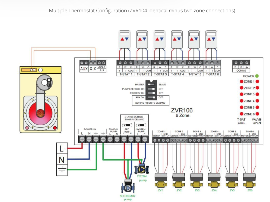

    hot_rod Member Posts: 26,527
    In addition, I'd add that relay boxes offer fuse protection, pump exercise, priority,RWC t-stat connections

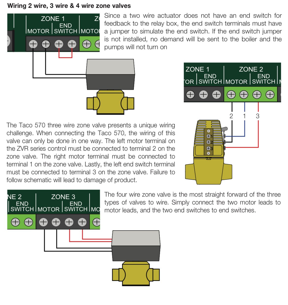

    The Taco valve like the 573 are also 3 wire. As taco explains it lets say your going to T & T on an oil boiler on a call for heat to start the burner. T & T on the primary control also is fed by the small transformer on the cad cell relay so if the end switch on the valve (like a Taco) the end switch will also be hot from the zone valve transformer.
    You will have two transformers intermingled, but it is not an issue if wired properly. See the attached. Page 3.
    Personally, I would rather have relays to avoid confusion and miswiring.
    on the Caleffi ZRC the 573 wires like this

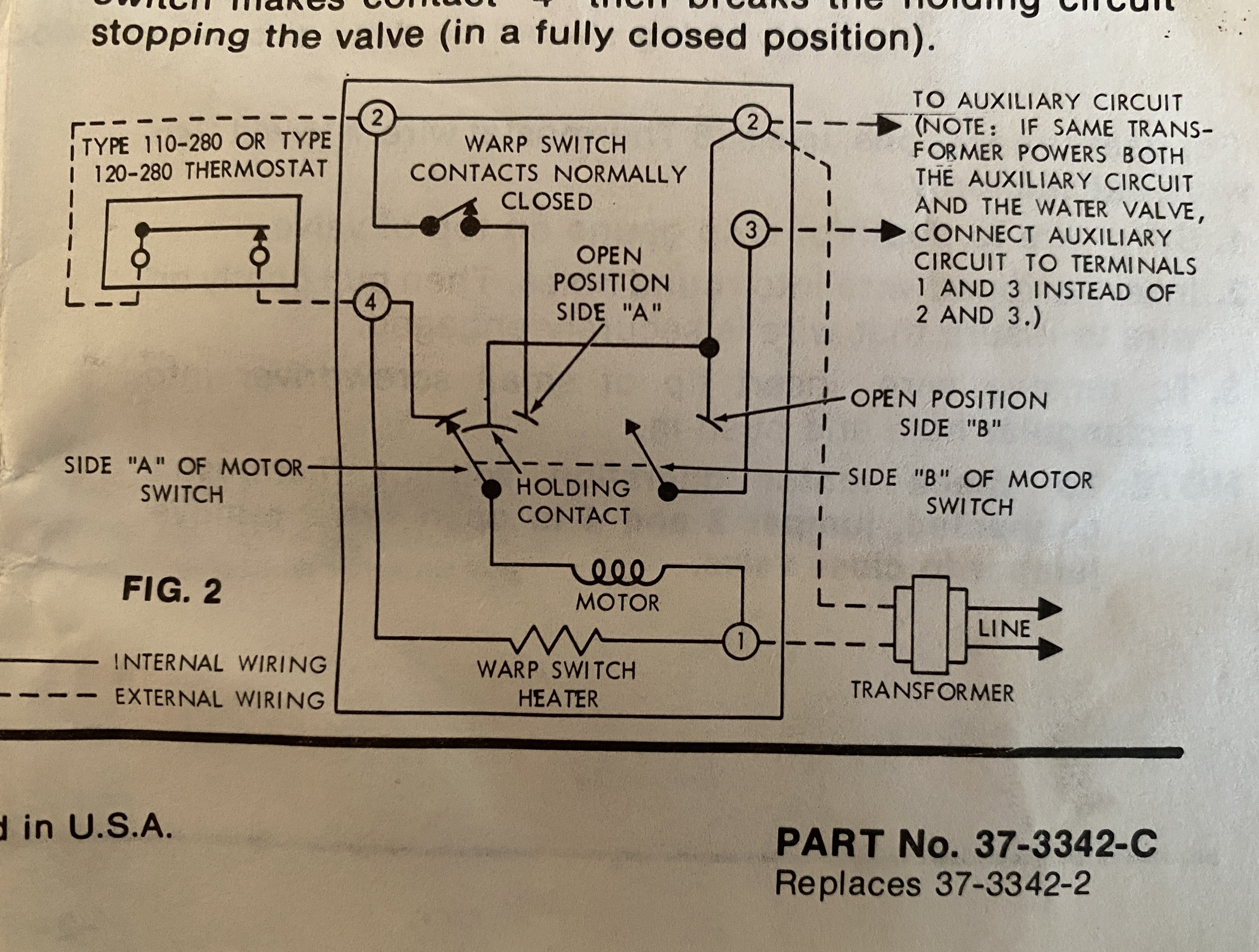

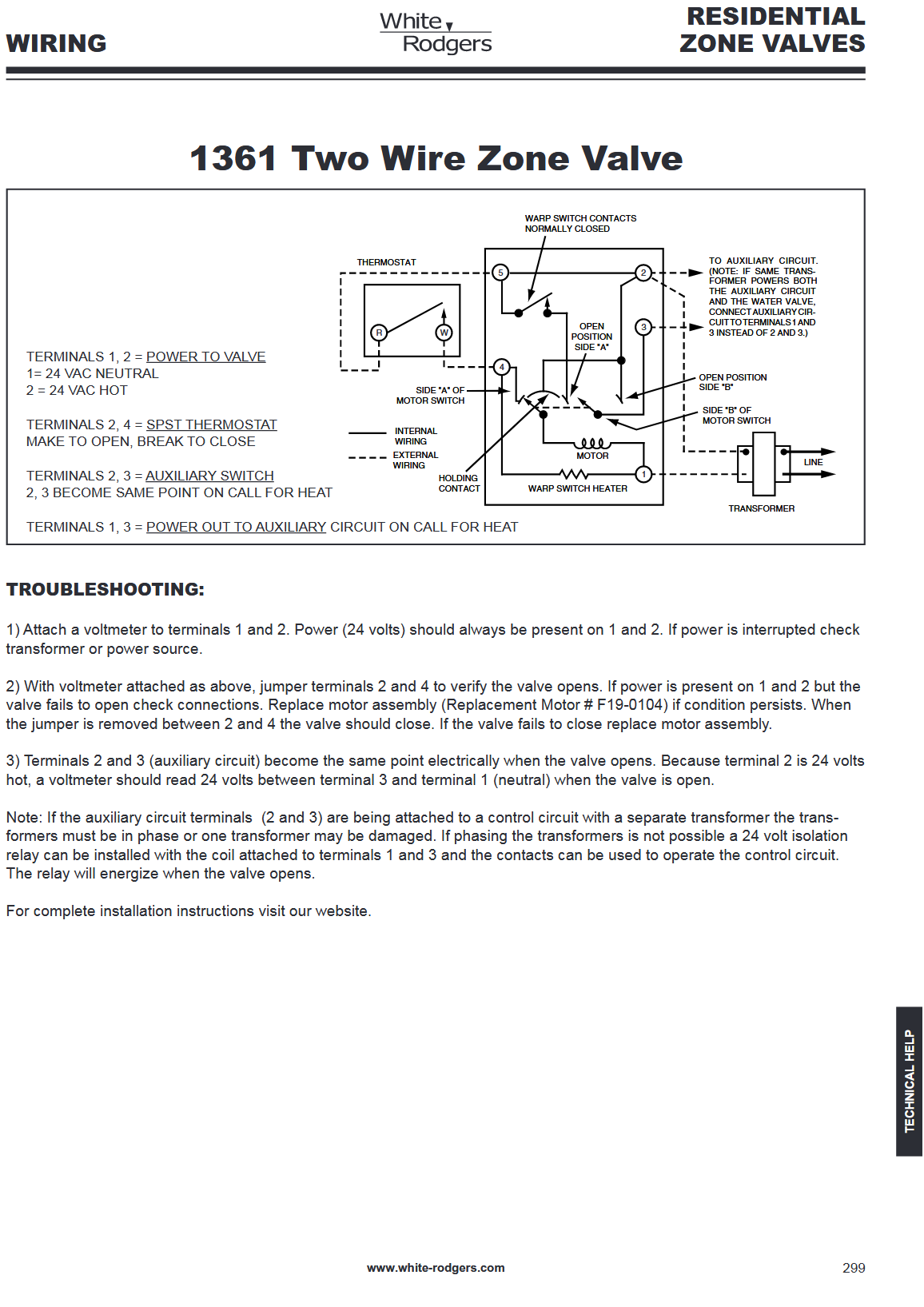

    Here is the text from White Rogers:
    Note: If the auxiliary circuit terminals (2 and 3) are being attached to a control circuit with a separate transformer the transformers must be in phase or one transformer may be damaged. If phasing the transformers is not possible a 24 volt isolation relay can be installed with the coil attached to terminals 1 and 3 and the contacts can be used to operate the control circuit.
    The relay will energize when the valve opens.
    Document is here: link

    EBEBRATT-Ed Member Posts: 19,455
    What WR said is true if both wires of both transformers are intermingled. But as explained in the Taco brochure if only one wire is then it is not an issue.

    109A_5 Member Posts: 3,374
    The zone valve connection information has been out there probably for decades but folks refuse to read the instructions and/or if they do they still decide to do things wrong. Steam boiler near boiler piping is a classic example of not following instructions.
    With the White Rodgers 1361 zone valve, a relay is not needed if the zone valve is wired correctly to the system and the Taco document explains why. A transformer failing after 9 years of service is most likely just a transformer failure especially if no NEW actual underlying system issue is found.
    Generally transformers are very reliable, but they do fail.
    Nothing wrong with isolation relays, even if you don't need them, except you have added another device to the system that can also fail.
    This below is more like Lawyer CYA speak than Electrical Engineering.

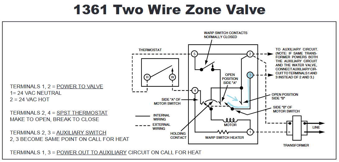

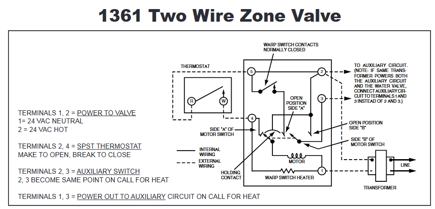

    @109A_5 - can you expand that diagram to show the revision at the bottom of the page? My revision is 37-3342-C,
    I did RTFM and the documentation that came with my zone valves was missing the bit you refer to as lawyer CYA stuff. Maybe instead the engineers at WR added it?
    @EricPeterson No revision number.
    https://s3.amazonaws.com/s3.supplyhouse.com/product_files/White%20Rodgers%20-%201361-102%20-%20Wiring%20Guide.pdf
    edited December 17
    @EricPeterson In situations like this you have to ask 'What changed ?'. A wiring setup that lasted and worked correctly for 9 years was probably correct. Adding an isolation relay may have masked the real issue and with the added benefit of restoring proper operation.
    Personally in situations like this I like to troubleshoot with a light bulb (Dim Bulb Test), no more blown transformers or fuses.
    If I had to guess from here, one side of your boiler's transformer is grounded (maybe through the logic board). Due to a zone valve or zone valve wiring defect I suspect one of the terminals of the 1361 has become erroneously grounded. When the End switch (Side B) closes the erroneous ground path causes harmful current through the transformer that fails. I suspect the erroneous excessive current is made possible since the pipes going to the zone valve are connected to the boiler. With a Dim Bulb Test and a clamp on ammeter the fault current may be obvious but limited to a safe level by the use of the Lamp.
    So the Lawyers and/or Engineers being made aware of a possible ground defect with their zone valve recommend the isolation relay… CYA !!! If the fault happens know one knows. CYA
    In a properly working circuit (as explained in the Taco document) closing the 1361's terminals 2 to 3 should not cause any excessive (harmful) current to flow in either transformer (boiler or thermostat / zone valve power). Secondary windings of multiple transformers 'touch' all the time and it does not cause a mysterious failure unless there is a defect somewhere.
