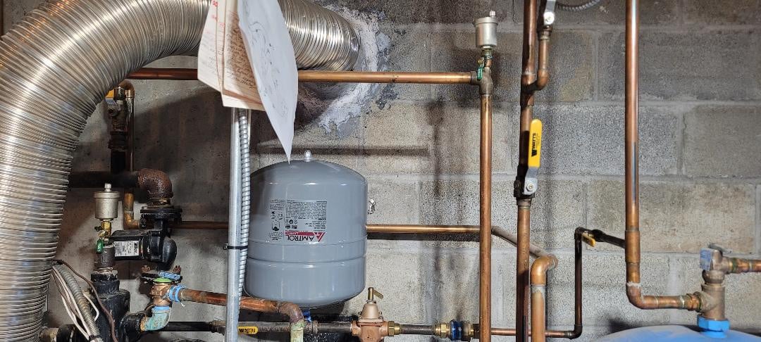

So. I am rethinking my expansion tank installation as well. I installed a Extrol ex30. The friend who helped with this suggested buying an ex-30PRO next time. The PRO model specifically says ok for use with glycol. The other does not. But, AI says it is ok. It is also precharged at 15 psi and the regular is 12 psi. But, the other question is I can order a kit that had a bleeder valve set up like this. Do you suggest this upgrade or not needed?

The next question is that I have these bleeders in two spots on the boiler and one in the attic. I have had a few people say that they hate the concept of one in the attic and that it can cause me more trouble than it is worth. Any thoughts on these bleeders and how will I be purging the air when I do the glycol? It sounds like the expansion tank kit with bleeder has something special to remove the air. Thoughts? See the pic below for the two bleeders I have on the boiler. THANKS!!!!

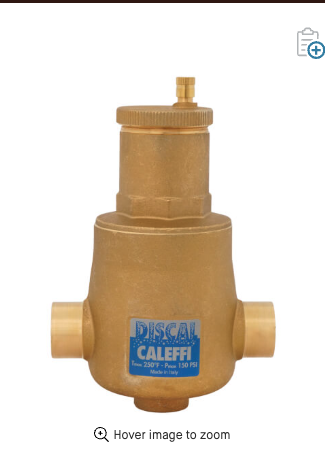

I can't see enough of this component, it looks to be some sort of air purger?
If you did want to repipe you want a microbubble type air purger, not a cast iron ramp. The are much more efficient and no piping requirements like the cast iron type. They work much much better with glycol systems that don't give up air easily.
With an efficient air purger and manual valves to fill and purge you should not need any remote manual bleeders, anywhere except maybe cast iron radiators.
The Amtrol Pro is a plastic lined expansion tank, longer life expectancy, specifically designed for systems with non barrier plastic tube. A plain steel expansion works fine with glycol. The glycol has inhibitors to protect all the ferrous metals in the system.
When you are all finished put a 5 gallon bucket with lid, relief valve discharge tube goes into the bucket. Should the relief valve ever discharge, you capture the glycol solution.
