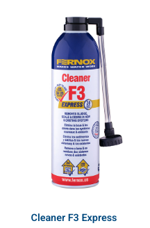

    My process would be to squirt in a cleaner and run that for a day to get the system to a good starting point for new glycol. Flush it out well.
    This system cleaner comes in a squirt can, screw it onto a purge or drain valve, hose thread, open valve, and pull trigger. Be sure it is tightly connected as the can empties in seconds!

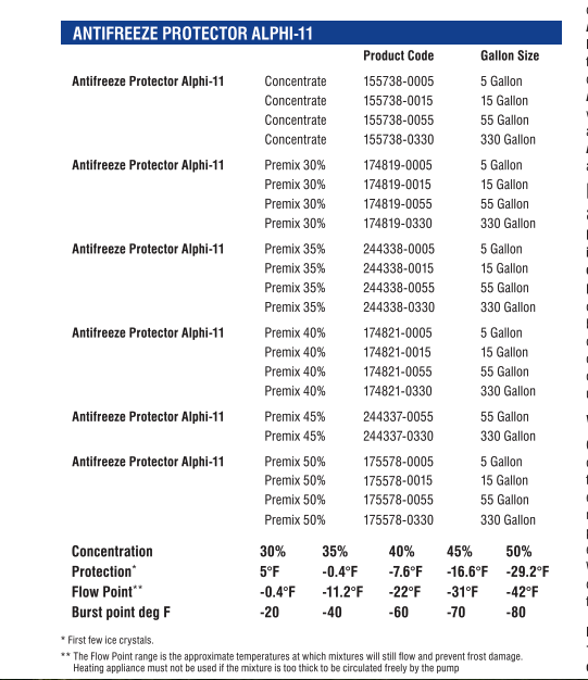

    Choose a glycol brand and the %. Most brands have info on the container for protection. Generally 30- 35% is adequate, but decide on the lowest temperature you want protection to.
    This Fernox Alphi 11 at 35% will flow down to, -11°F burst at -40°F

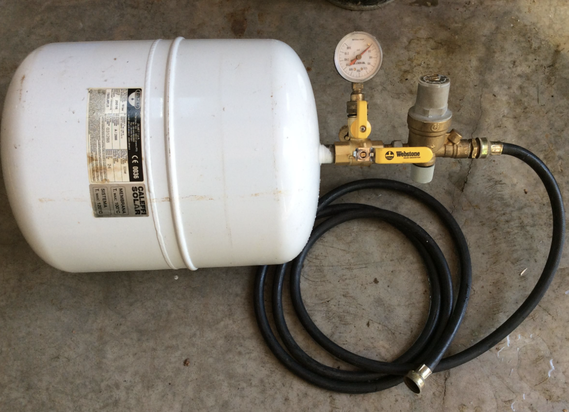

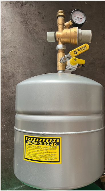

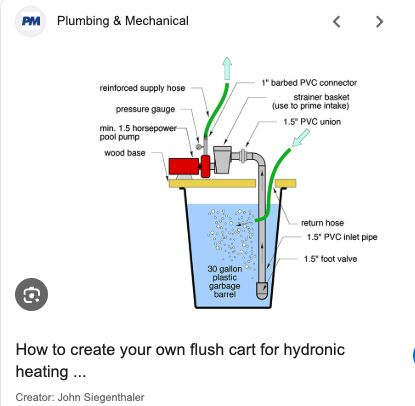

    You will need some way to pump it into the system and purge air out. A 5 gallon bucket or plastic garbage can allows you to pump out, and purge back int the bucket until you do not see or hear air bubbles. This can take some time depending on the piping, zones and amount of fluid.
    Simple and inexpensive is a 5 gallon bucket with a small submersible type pump from the Home Stores, 1/2hp is plenty.
    Or find pool or spa pump on Marketplace and build a system like this.
    Some hydronic wholesalers have pump carts to rent or loan, that makes it a simple, safe job.

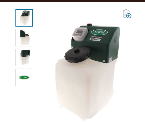

    Some choose to add a glycol fill tank to add fluid as air bleeds out.

  • Will this product work the same as F3? Supplyhouse is where I often order from. Thank you.
    X800RD - Sentinel X800RD - Sentinel X800 Fast Acting Cleaner Rapid-Dose

    Also, I don't think I am going to go with the auto feed system this time. But, I would love to know more about them. At this moment, I need to simply make the system safe from freezing and enjoy the holidays. I can then research this another time and when I replace my attic air handler in the next couple of years, I will then consider this upgrade? What is the need for this expensive device if the house has been fine without it for 27 years? Thanks.

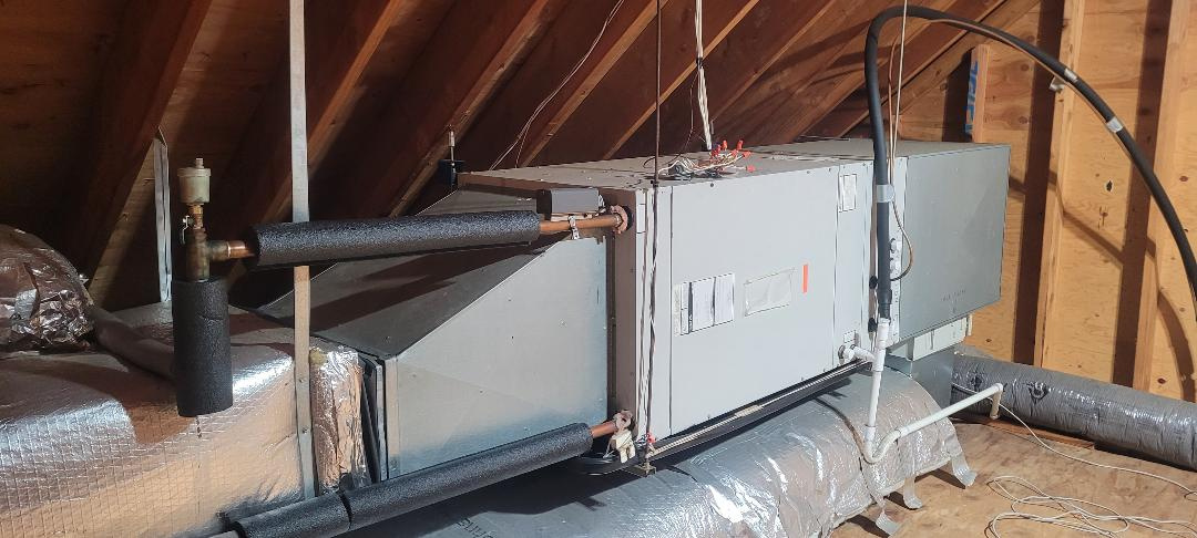

    Just a crazy thought. Could I drain the upstairs heating system in the unconditioned attic while I am away for 2 weeks in the winter and not put glycol in the system? Just simply drain that loop? I realize I would not have heat in that loop, but wouldn't that make it safe or am I totally off base? Thanks.
    @clydesdale I live in MA where our design temp is 0 deg. We occasionally see-5—10 maybe 2-3 timeas a winter. We used 30% glycol with water and never froze anything up. Even equipment that was outdoors. Two much is harder to pump and slows heat transfer. Freezing point and bursting point is two different things. It may get slushy thats about it
    hot_rod Posts: 28,708
    you could drain the part of the system prone to freeze. You would need two valves to isolate that section then repressurize the balance of the system. to keep it going
    Any brand of cleaner will work, Fernox, Rhomar, Axiom, sentinel
    If you don’t use an aerosol can you will need to pump it in.

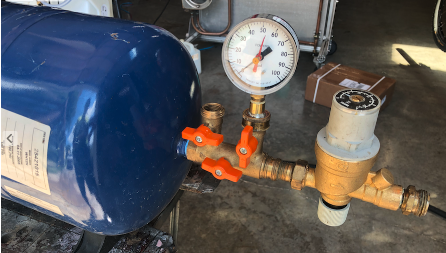

    The next question is that I have these bleeders in two spots on the boiler and one in the attic. I have had a few people say that they hate the concept of one in the attic and that it can cause me more trouble than it is worth. Any thoughts on these bleeders and how will I be purging the air when I do the glycol? It sounds like the expansion tank kit with bleeder has something special to remove the air. Thoughts? See the pic below for the two bleeders I have on the boiler. THANKS!!!!
    I can't see enough of this component, it looks to be some sort of air purger?
    If you did want to repipe you want a microbubble type air purger, not a cast iron ramp. The are much more efficient and no piping requirements like the cast iron type. They work much much better with glycol systems that don't give up air easily.

  • Great info, thanks. I happened to speak with a plumber yesterday, who works with boilers, and he stated that he often does glycol changes in about 10-15 minutes. He pumps it into the boiler hose bib and then runs the drain hose out the basement via a window and has someone outside who will tell him when the hose starts flowing the color red from the glycol. He says he purges the air from the purge valve on the boiler. He also stated that he hates having these purge valves in the attic, like I have. See the pic below. I think the idea is that they can leak. But, I have one at the top of the garage heater, and one by the hot water heater also. He suggested that I close the one in the attic completely, so it cannot leak glycol out. Thoughts on these?
    pecmsg Posts: 7,634
    I agree with the plumber. I do not like auto vents with glycol. Especially in areas that are not monitored regularly.
    In that picture there is a valve below the air bleeder. Close it when you're not there.
    nate379
    You do want to have a high point vent on that air handler. If the auto vent is a concern just put a ball valve with a hose connection. No need to put any type of bleeder valve. Use a short washer hose and a small bucket to purge.
    Auto vents do work fine with glycol, but in a location where you cannot easily access them a manual valve may be adequate. It is over a long period of non use that an air bubble could rise to that highest point. Especially if you do not have a good purger back at the boiler that is pulling the micro bubbles out. First start up every fall is when you may need to burp a bubble out.
