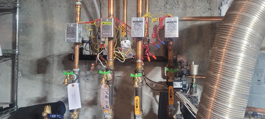

    I imagine I can inject the Sentinel cleaner in any one of these hose bib valves for the 3 zones and hot water heater? Or do I inject it in the hose bib at the bottom of the boiler? Can I pump the glycol in through any of the 4 as well? My thought was to use one of the two 1 inch copper pipes in the middle going to the 2 main heating zones. The left garage heater zone and right hot water heater use 3/4. Thanks!
    pecmsg Member Posts: 6,744
    you also need to let the air out without loosing any glycol.
    a picture further away would help
  • clydesdale
    clydesdale Member Posts: 72
    I will get you that pic. Here is the pic of the boiler bib
  • clydesdale
    From a distance.
    hot_rod Member Posts: 26,485
    Yes any of those hose connection ball valves will work to squirt the cleaner in.
    Power off. Pump glycol in the very bottom boiler valve. Close all the ball valves below the zone valves. Manually lock open all zone valves.
    This method fills the boiler, goes around the zones and purges from the valves below the zone valves. Do one zone at a time. You want the glycol to come back air free, even purge until the milky color goes away. It should come back looking just like it does in the bucket.
