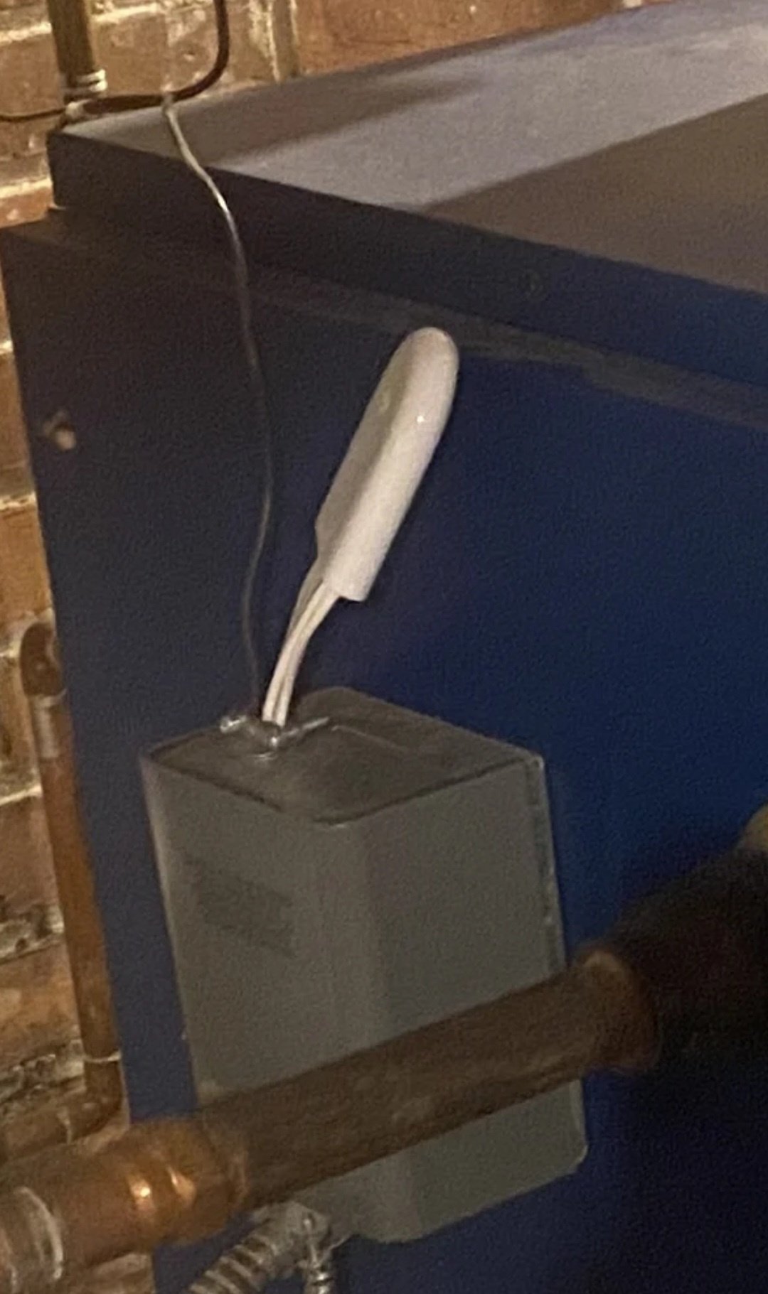

    The aquastat model is a ra89a 1074. Looking at a line drawing it appears this is just a relay. I understand your approach but need to investigate the correct model
    109A_5 Member Posts: 3,956
    Yeah that is just a relay, I was not sure. So you would need an aquastat or change the piping (which would be better). Waiting for the boiler water to cool down may take too long when you need the heat the most.

    Follow the thermostat wire from the RA89. Does it go directly to the thermostat?
    Again, I don't understand how it ever worked. You say it did. So the question is, did it work fine before the Magic Nest Common Maker?
    EBEBRATT-Ed Member Posts: 20,144
    Both pipes should be down low. @DanHolohan also shows a method of piping both HW supply and return to a single tapping by using a DT bushing if two tapping's are not available.
    What is that sensor sticking out of the RA 89A. Looks like a temp stat?
