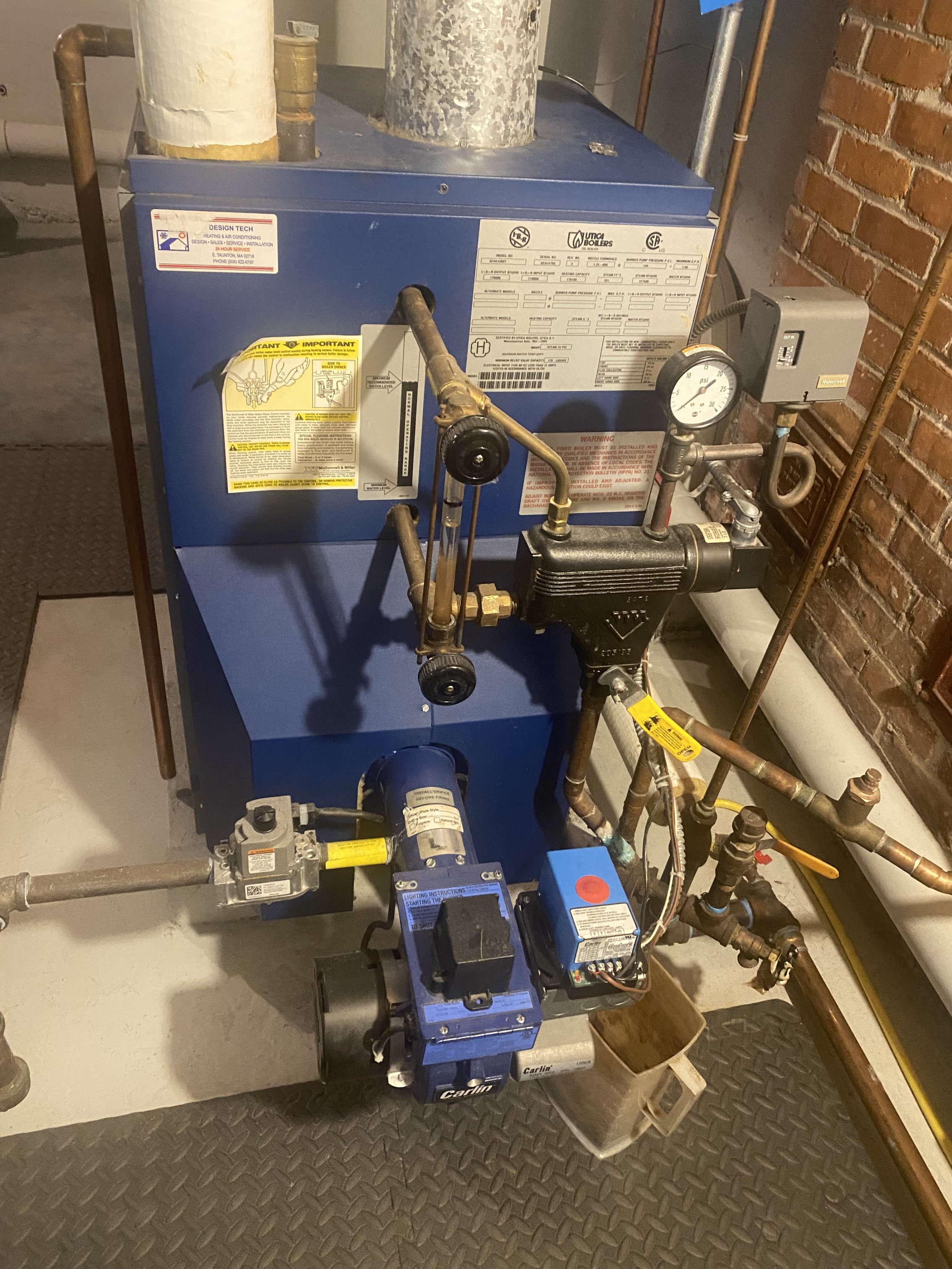

I have a Utica star fire steam boiler sfh4150st with a tankless coil for domestic hot water and a hot water loop supporting a new addition. My issue is with the loop bubbling & flashing when the boiler builds a head of steam. I’m thinking of adding new aquastat that can control both high and low however I am not aware of a unit that will shut down the circulator at 200 degrees.

    Can you post a few picture of the boiler and controls and the hot water loop connected to the boiler?

  • I understand the best practice when installing a loop on a steam boiler unfortunately I did not

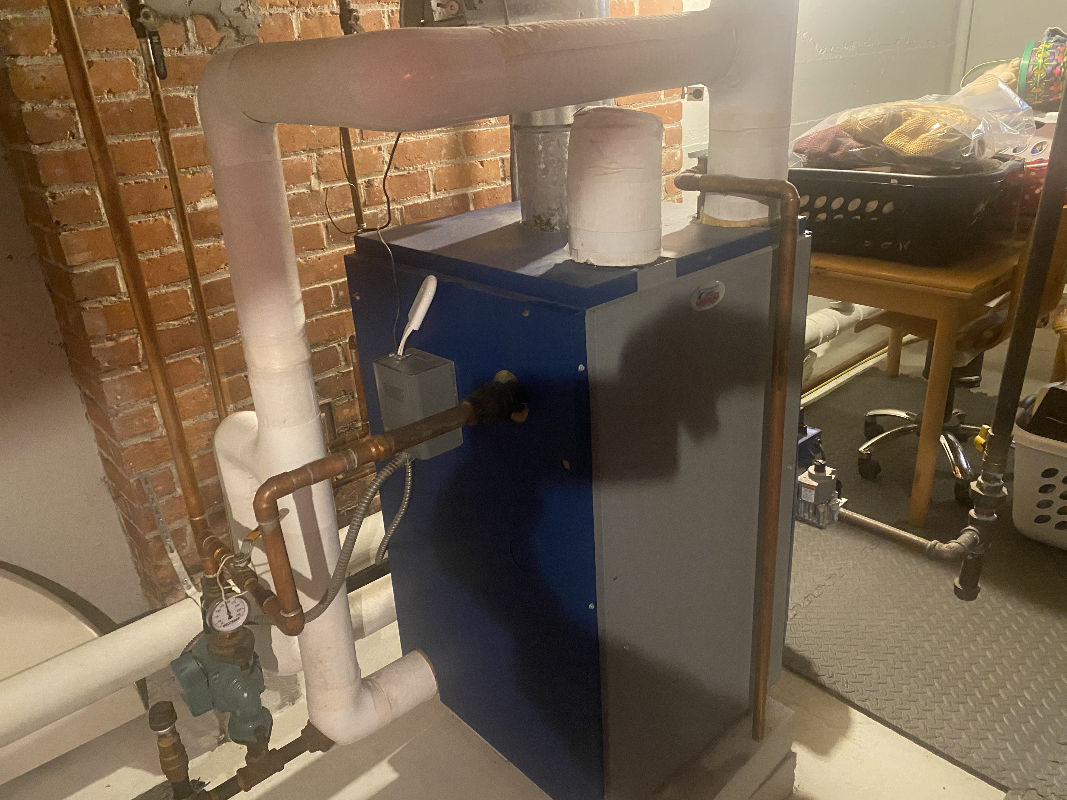

    do the initial install. Please note the ball valve that is tied off the loop, not sure if that was a Utica best practice 25 years ago .. I have attached the requested picture
    HVACNUT Posts: 7,784

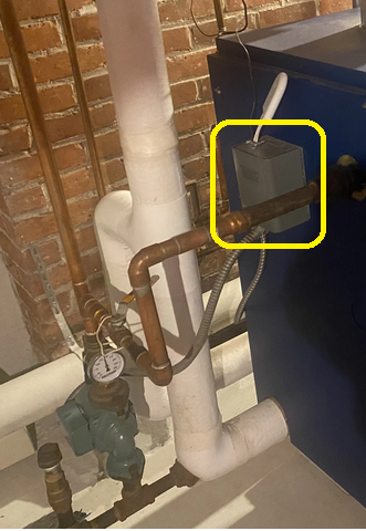

    Why are there Tee's above and below the circulator? The piping back to (or from) the boiler off the bull of the Tee looks like its above the water line.

    I can't comprehend the piping with the Tee's above and below the circulator if its a simple baseboard loop. And to me, the one pipe looks like its piped at steam level into the boiler. I never piped a hydronic loop off a steam boiler, but I thought supply and return should be down low on the boiler taps. A wye strainer because its piped down low. And no iron body circulator? For some reason I remember hearing that.
    The current aquastat is a Honeywell L4006A, which is "open on temperature increase". I don't think the aquastat is the issue.

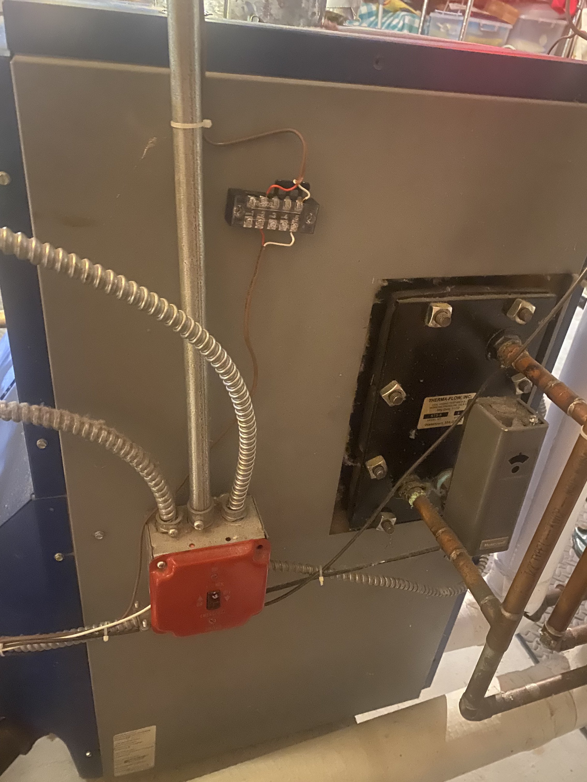

    Follow the thermostat wire from the RA89. Does it go directly to the thermostat?

    Both pipes should be down low. @DanHolohan also shows a method of piping both HW supply and return to a single tapping by using a DT bushing if two tapping's are not available.
    What is that sensor sticking out of the RA 89A. Looks like a temp stat?

    The BoilerMate seems like the most expensive method possible. What aquastat are you swapping, I don't see one to swap. You could add an aquastat to the RA89A relay circuit.
