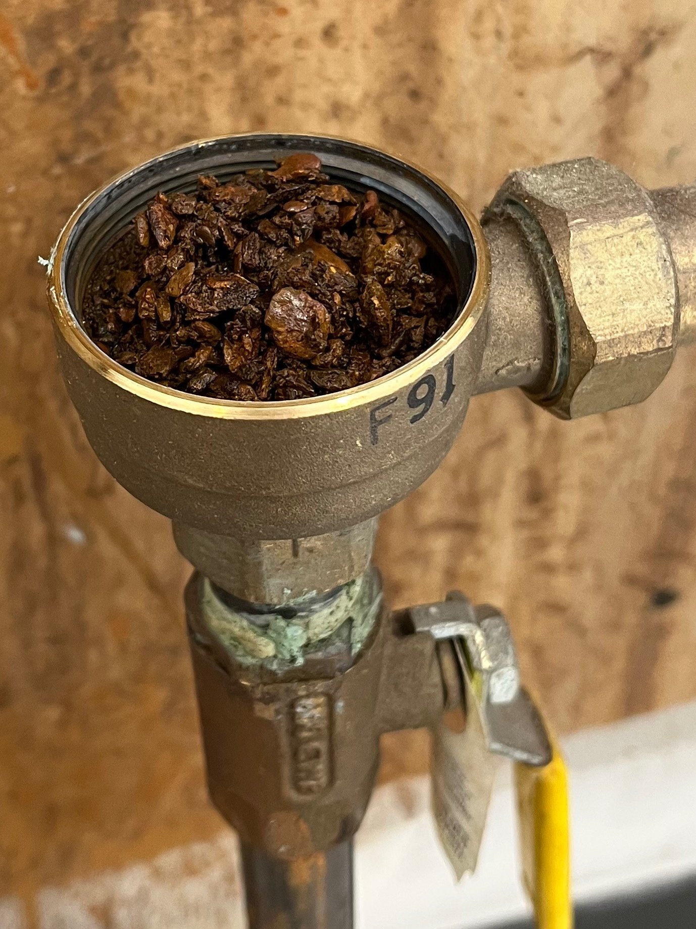

Since I enjoy the steam system in my own home and reading HeatingHelp, I thought I would see if I couldn't do some simple repair myself. It seemed like the steam trap (a Hoffman 17C) might have failed closed; I thought maybe I could replace the cage unit myself. Before buying a new cage, I opened the trap. (There are shut-offs on both sides of the radiator.)
This is what I found inside ...
As you can see, it's full of debris. I cleaned out the trap out as best as I could, but now I'm wondering if the radiator (just a long pipe remember) is full solid of debris. Is it worth buying a cage? Any thoughts on how I should go about getting this radiator hot again?

    Are they raisins?

    No, it seemed like metal or mineral flakes to me. There was also a fine sludge below. I didn't have any tools (except a pencil) to explore deep cleaning out at the time.

    All seriousness aside:
    I would take an educated guess (because you are an educator) and say that it is rust from inside the pipe radiator. Steam should not make that much rust, so it has to be from the condensate.  It may have been happening since the radiator was installed.
    How easy would it be to have that radiator removed by the maintenance department at the school and have it pressure cleaned?  High pressure steam or water with a gritty mix forced thru that pipe radiator might be needed. You may need to take it off site somewhere?

    Try removing the debris with a nitrile glove and see if the radiator heats any better.
    You could try a stainless steel pull through cable with a bronze brush the same diameter as the pipe interior made for cleaning rifle bores. Otis Tec is what the Army uses.

    does it heat if you dig that stuff out, put the lid on the trap and turn the valves on? don't leave it that way because it will put steam in the returns but it will tell you if it is working. how high above the boiler is that? that stuff might have been washed in there if the system flooded for some reason.

    can you borrow a shop vac and suck that out? doesn't look like there's any pressure under that trap body, make sure both ball valves operate in case you find some steam pressure, then if you're worried about sending steam thru to the returns, consider sacrificing the supply ball valve and setting it mostly closed to operate as a quasi orifice, throttle your heat if it flows at all,

    @mattmia2 My classroom is only one floor above the boiler. I'd like to think the debris was the result of a one-time flood, not a chronic problem.
    My initial cleaning out of the trap today didn't get the steam flowing, but I didn't have anything but pencils and wrenches at hand. I'll bring some better tools for cleaning the trap tomorrow and see if we can get some steam flowing through.
    I'm afraid the school wouldn't look kindly on what would be seen as "tinkering" with school property, so I'm reluctant to share this investigation with the principal or superintendent. But if I can fix the radiator with some knowhow from you all and little work on my part, I still feel I ought to try.

    Unfortunately it seems that the radiator (a pipe) is also blocked up to an unknown degree by sludge and mineral flakes like fine crushed stone.

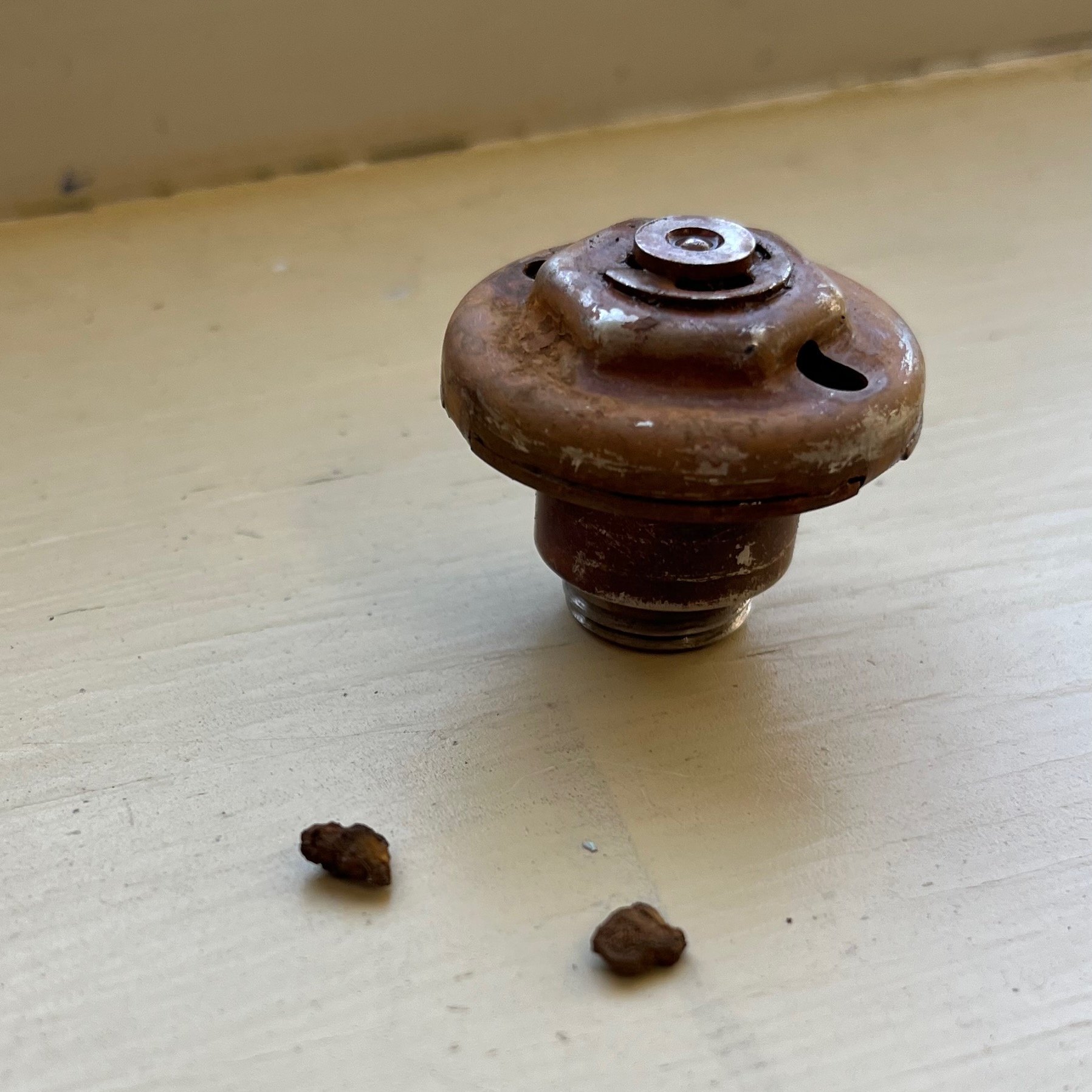

    Here's a picture of the existing cage unit. I was expecting a spring with it, but there was none. Is that normal?
    mattmia2 Member Posts: 16,117
    the cage unit looks ok, the bellows expand out the bottom and close the seat. the spring is probably more a way of making a few cage units fit a bunch of different proprietary body designs by changing the spring.
    are you sure the boiler was firing and if there is a zone valve, that was open during your test? that seat is the smallest part of the return piping so debris that got past there probably didn't block it up.
    you can also try opening the supply with the cover off and see if steam gets in to the emitter and works its way to the trap.
    you could have the pitch of the piping trapping water in the supply blocking the steam or in the return keeping the air from getting out of the emitter.
