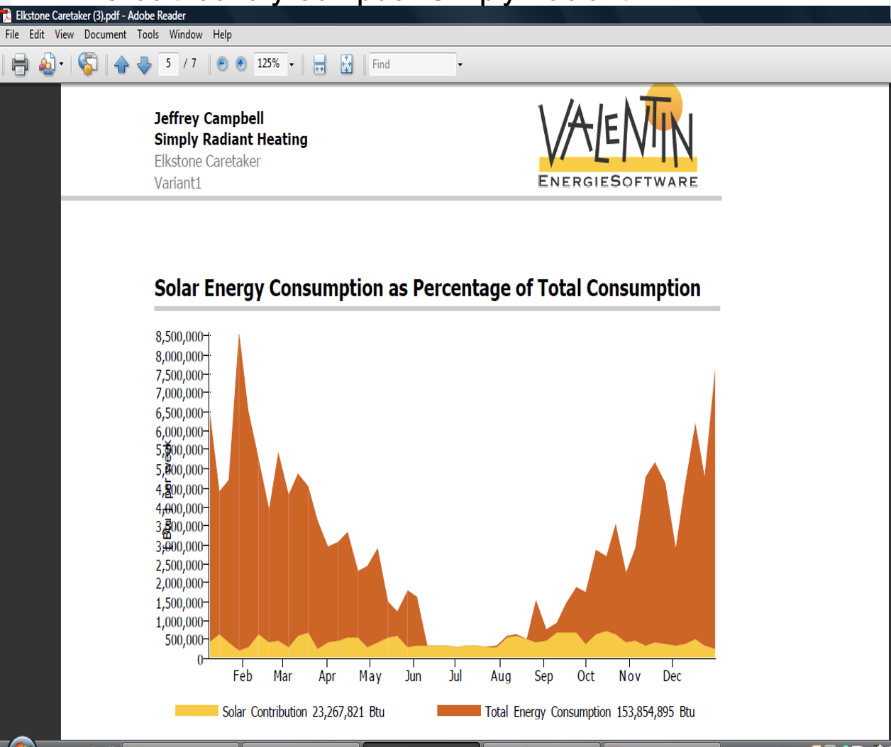

I'm getting solar panels. I'll let you know how it goes in this discussion thread.
What went into my decision:
- At the end of this year, the 30% federal tax credit on installation cost is going away thanks to a big bill that recently passed. So I'm doing it partially out of spite.
- NJ's PSE&G just had a big electric rate increase
- NJ still has 1:1 net metering (where they will give me full credit for every kW I send to the grid). I believe I get locked into that for something like 15 years.
- NJ has an SREC system where I will get $85 for every MWh that I generate. Also 15 years.
I'm using a place called NJ Solar Power, they are primarily a commercial solar installer, but they do (for now) have a residential division.
One interesting thing is they don't use a micro-inverter system where each panel gets its output converted to AC…they run the DC from all the panels into a central inverter located on the ground (SolarEdge). I'll let you know how that goes, but I like a single converter from high voltage DC to AC.
Here is the solar profile for my house on the left, it's not bad due to my 10:12 south-facing roof. But the large dormer interrupts it. My neighbor to the right has an ideal situation. High roof, good angle and direction. You can see your own solar profile at https://sunroof.withgoogle.com

How many panels are you having installed? How many kw? Do you have an electric car?
We have 17 panels, 5.78 kw and use only half of what we generate since we haven't decided on which electric car to get. Won't get a Tesla.

18 panels, if the town will approve it. 7.83 kW
I made sure to get my EV car (Nissan Leaf) a few years ago (plus the HP water heater and the induction stove) so that it would all count on my annual usage.
This is because in NJ, in order to get the 1:1 net metering, I can't install more solar capacity than my annual electrical usage (they don't want us being power plants). So I wanted to make sure my usage over the last year was near its reasonable maximum. I did not plug in a hair dryer in my garage for the last year to bump it up higher (although I considered it 😅).
When 1:1 net metering is removed by NJ (it's only a matter of time) and my lock-in runs out, I will be looking at a battery but for now the grid is my battery.

I have 6200w installed with a Sunny Boy single inverter. This inverter will supply 2000w in the event of a power outage, but you have to manually switch it

The ship has probably sailed, single inverter would work for your right neighbor but your install would work much better with micro inverters. Partial shading is the bane of PV arrays.
You can still make the current setup work well if they can get an inverter that has multiple MPPT inputs (ie SMA Sunny Boy Inverter SB6.0 ) and try to break up the arrays so partial shading will only effect some of the strings instead of all of them.

@Kaos these panels (all panels) have 2 or 3 sections, each with a diode, that allows shaded panels to allow the current from the other panels to pass through.
Also, these panels each will have an optimizer that will maximize the power regardless of shading.

As long as you have multiple MPPT channels (or optimizers) and they don't do anything silly like wire east facing panels in series with west facing ones, it will work well.
