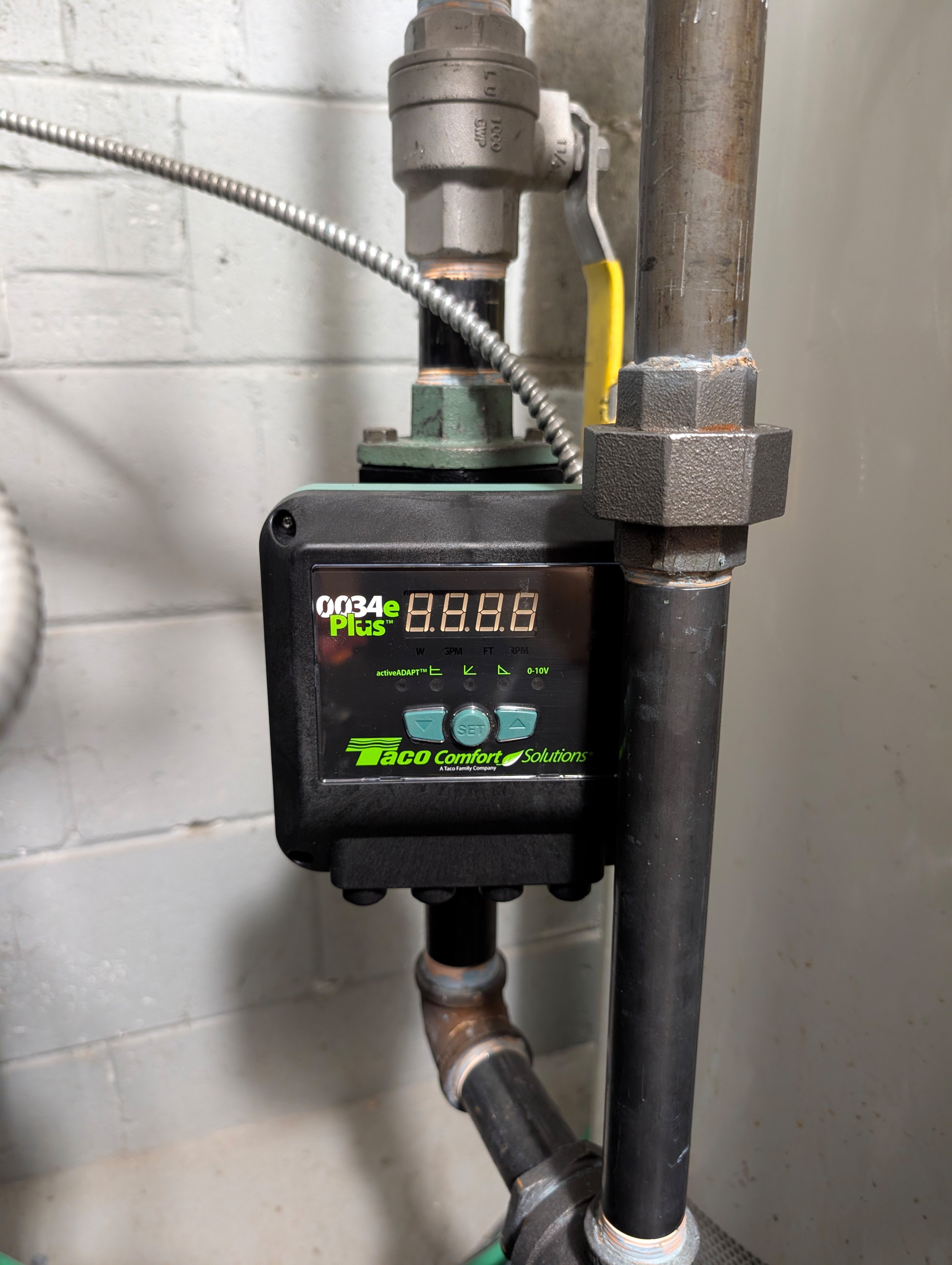

    So I ordered a Taco 0034eplus. Will report once i install it.
    I want to convert to "pumping away", which will entail adding zone valves which are restrictive, and I also needed a thermal bypass like the ESBE VTC511. I don't think the Taco 0026e would handle it. Certainly not if i used the typical 10CV zone valves.
    Also looks like the plus version of 0034e has a plethora of curves and a lcd readout, hopefully i can figure out my system curve once and for all using it, and the previous readings from 0015e

    I installed the beast. Flow rates at various settings i tried:
    100% - 20.1gpm (27GPM shown pump)
    50% - 10.7gpm (14.5GPM)
    60% - 11.8gpm (16.5GPM)
    65% - 13gpm (17.5GPM)
    63% - 12.5gmp (16.5GPM)
    C1 (constant pressure of 6ft) - 11.4gpm (15.5GPM)
    C2 (constant pressure of 12ft) 16.8gpm
    0015e did 9.4gpm at Medium (constant pressure of 10ft) and 9.4gpm at High (fixed speed, max curve).
    If i look at the High curve, at 9.4gpm the head is 8.4feet or so.
    If i solve for head at 10.7GPM which is 11ft according to the manual (50% settings using the new pump)
    H2​=H1​×(Q1​Q2​​)2
    H2​=8.4 ft×(9.4 GPM10.7 GPM​)2
    H2​≈10.88 feet which is pressure close to 11ft.
    Conclusion: I don't understand constant pressure setting and it shouldn't be used to extrapolate head/gpm.
    To pump at 12.6gpm my system needs 15.09 feet of head using the formula above and at this setting the pump consumes 39W. Taco 0015e consumes a maximum of 44wats and couldn't pump more than 9.4gpm with my system.
    Jamie Hall Member Posts: 26,843
    Two more or less random comments. On is minor — the formula you are using is approximately correct. The actual exponent is 1.83, not 2.
    Thee other is that the power consumption of two different pumps is only rather poorly related to a given combination of head added and flow — it also depends, a lot, on the detail geometry of the both the impeller and the volute, and different pumps can be surprisingly different — even with the same layout dimensions. Further, if one or both of the two is electronically commutated, pretty much all bets are off. The exact details of pulse width, amplitude, and frequency can be very different — resulting in different power deamnds.

    The energy consumption readout can probably be trusted, however the GPM and head displayed on the pump were way off (much higher gpm, much lower head) compared to the ultrasonic.

    Literally just installed it, this system is slow but there doesn't seem to be a difference.
    I need to throttle / balance, I wanted to get the GPM right first.
    hot_rod Member Posts: 26,607
    I have measured an 80% error in flow readings from various ECM circs. I would not bet the farm on the displayed flow rate.
