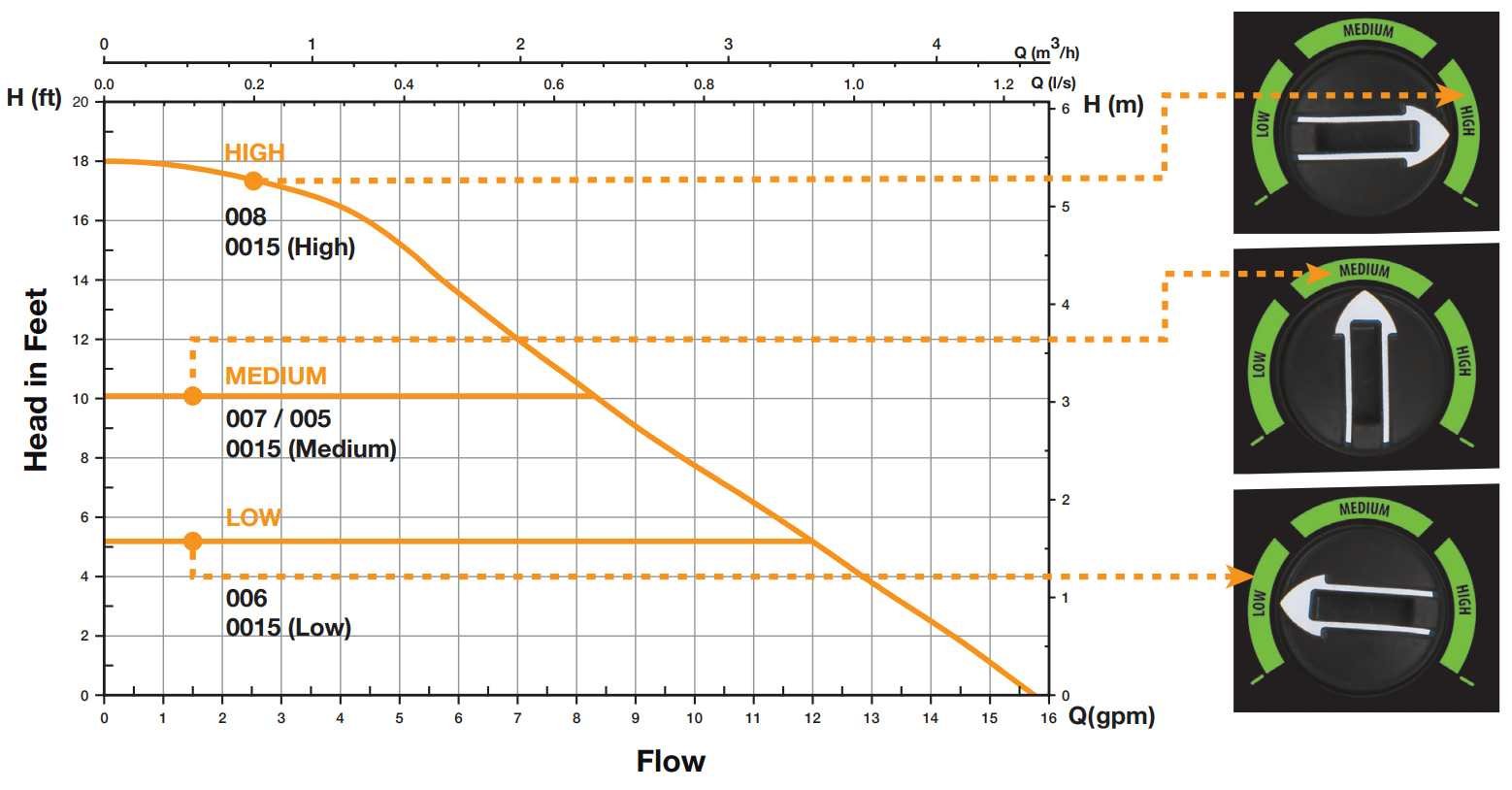

I've been told for years my pumps are under powered so i got a fancy Keyence Ultrasonic (accurate to 2% apparently) meter to see what's going on.
Boiler is 180,000BTU net and i have a monoflo system with a single 2" supply, which splits into two zones.
18 gpm is design at 20F delta T.
Zone 1 > Two 1-1/4 split returns (70% of the BTUS, or 12.6 gpm design)
Zone 2 > One 1" return (30% of the BTUs or 5.4 gpm design)
There is a Taco 0015e on each return.
At low (5 Feet of Head constant pressure)
Zone 1 - 8.35 gpm
Zone 2 - 4.4 gpm
At mid (10 Feet of Head constant pressure)
Zone 1 - 9.4 gpm (25% less than 12.6GPM design
Zone 2 - 6.3 gpm
At high
Zone 1 - 9.4 gpm same as mid
Zone 2 - 6.4 gpm almost same as mid
At high neither zone flows any faster than at medium, how can it be?
Using (Head 1 / Head 2) = (Flow 1 / Flow 2)^2 at
say 8.35 gpm at 5 feet of head, i can't arrive at 9.4 gpm and 10 feet of head,
shouldn't i be able to ?
Furthers radiators don't heat enough,
i want to replace both pumps with a single pump on the supply to
get close to design, before i balance the system. So I'm trying to figure out
which single pump to get.

    If you dont get any more flow on high speed then medium speed that tells me you out of head caacity at least on the larger zone.
    On zone 1 if your flow of 6.3 gpm and head of 10' is accurate (which I doubt) to get 12.6 gpm that you want you would have a head of 40'. So something is way off.

    You are GPM limited bumping up the setpoint only increases the amount of head the pump is capable of but won't increase the flow.
    You need bigger pumps. Something like the 0026e will work.
    You might be able to re-use the 0015 on the split return if you run them in parallel but might still be a bit small. Bigger pump (0026 or 0013) is the guaranteed fix with enough oomph that you can crank it if some rads are still lacking flow.

    I have a Taco 0015e ECM, it's curves are in the first post. It's set to Mid, it's my understanding the head is a constant 10 at that setting, am i wrong?
    The flow meter shows the GPM, it's my understanding with those two variables any
    other flow/head can be calculated, but it doesn't work for the other known flow/head combination.

    if the numbers Ed posted are reasonable, you need more pump, the 0015 isn’t going to get what you want
    The 0026 not a cheap date or equivalent.
    Maybe find an older style non electronic pump
    a 26-99 Grundfos would cover that load

    I installed the beast. Flow rates at various settings i tried:
    100% - 20.1gpm (27GPM shown pump)
    50% - 10.7gpm (14.5GPM)
    60% - 11.8gpm (16.5GPM)
    65% - 13gpm (17.5GPM)
    63% - 12.5gmp (16.5GPM)
    C1 (constant pressure of 6ft) - 11.4gpm (15.5GPM)
    C2 (constant pressure of 12ft) 16.8gpm
    0015e did 9.4gpm at Medium (constant pressure of 10ft) and 9.4gpm at High (fixed speed, max curve).
    If i look at the High curve, at 9.4gpm the head is 8.4feet or so.
    If i solve for head at 10.7GPM which is 11ft according to the manual (50% settings using the new pump)
    H2​=H1​×(Q1​Q2​​)2
    H2​=8.4 ft×(9.4 GPM10.7 GPM​)2
    H2​≈10.88 feet which is pressure close to 11ft.
    Conclusion: I don't understand constant pressure setting and it shouldn't be used to extrapolate head/gpm.
    To pump at 12.6gpm my system needs 15.09 feet of head using the formula above and at this setting the pump consumes 39W. Taco 0015e consumes a maximum of 44wats and couldn't pump more than 9.4gpm with my system.
