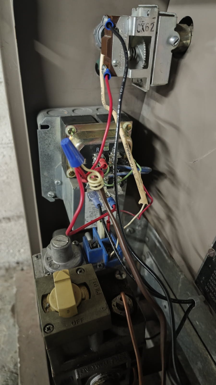

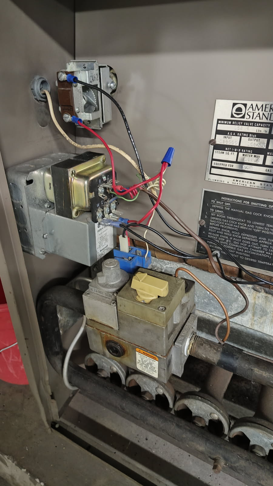

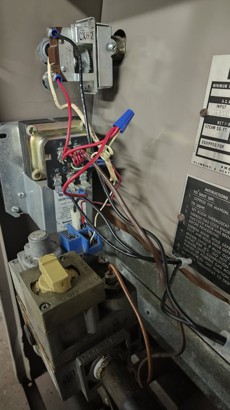

    you need to measure the ac voltage across the various controls to figure out which one is open. if the control is closed the voltage will be more or less 0. my bet is on the thermostat having a very wrong heat anticipator setting. after it shuts off, does it fire again in 5-10 minutes? with a standing pilot i don't see much else that could do this other than an unusual defect in the wring or the contacts of a control. if it had electronic ignition i could see a couple other ways what you're describing could happen.
    can we see a picture of your actual controls, especially the gas train, not just some random picture off the internet that you think is the same?

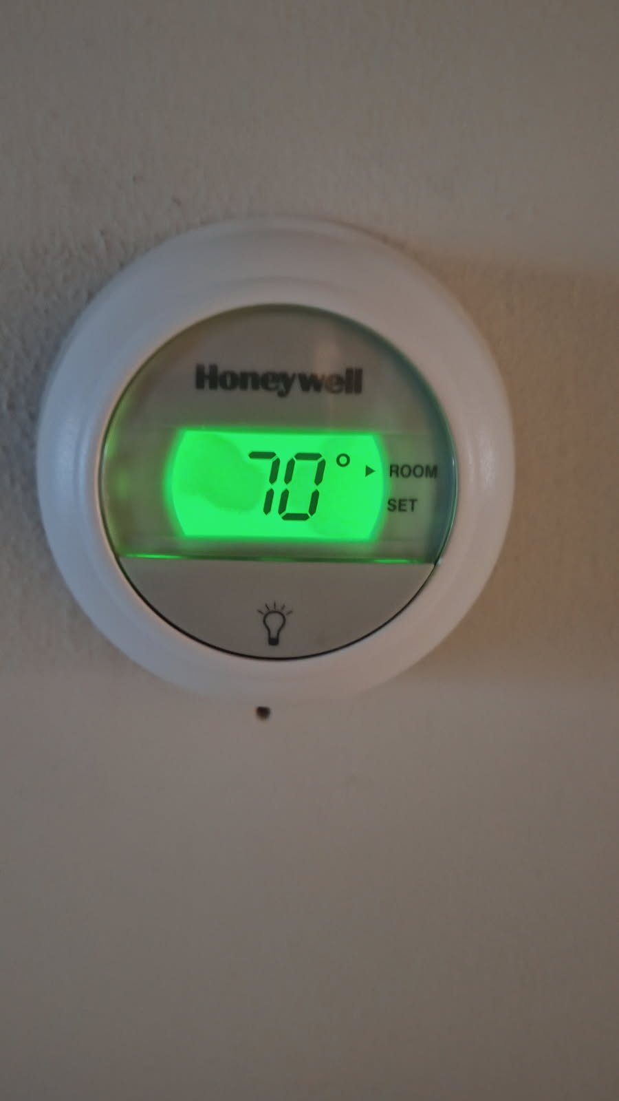

    Matt - i am working on uploading pics. I think you are spot-on in regard to the anticipator. I will inc a pic of the stat as well. Current stat is honeywell, round digital. T8775A1009. (I also tried with an old honeywell with traditional mercury switch…behaved same). will hopefully have photos soon…

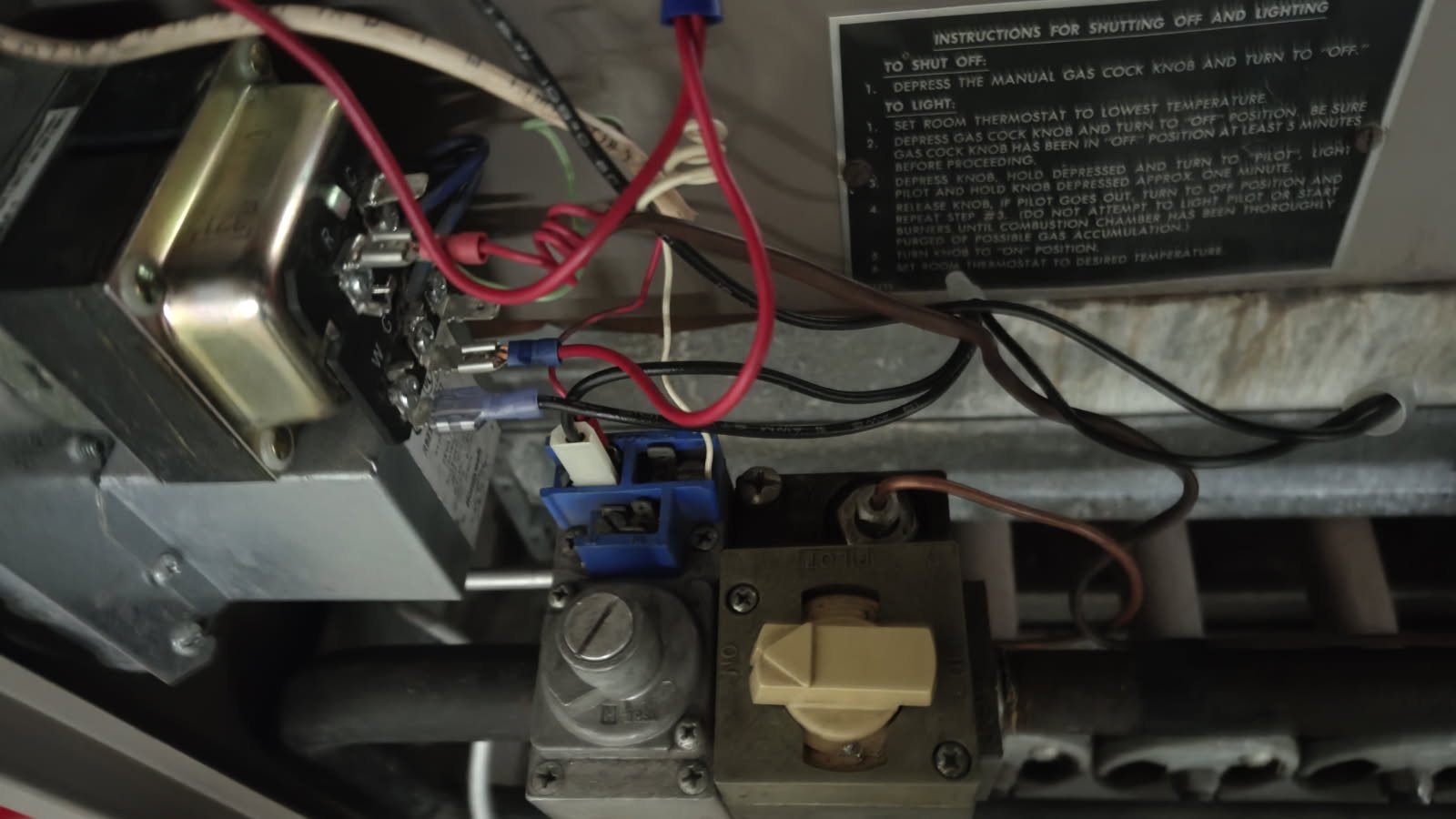

    Gas Valve wiring. I forgot to mention that there is a power vent wired into the gas valve. This is the control wiring that you see. Works as intended.
    mattmia2 Member Posts: 17,760
    the proving switch on the powered vent is highly suspect here, possibly bad but more likely doing its job.
    an electronic t-stat won't short cycle in the way i was thinking.

    In regard to the thermostat…I too was thinking of relocating it
    is this a converted gravity system or a newer system with ci radiators and smaller piping?
    if it fires for an extended period if you turn the t-stat up a couple degrees it is something about where the t-stat is located or how it is configured or possibly that the system is massively oversized.

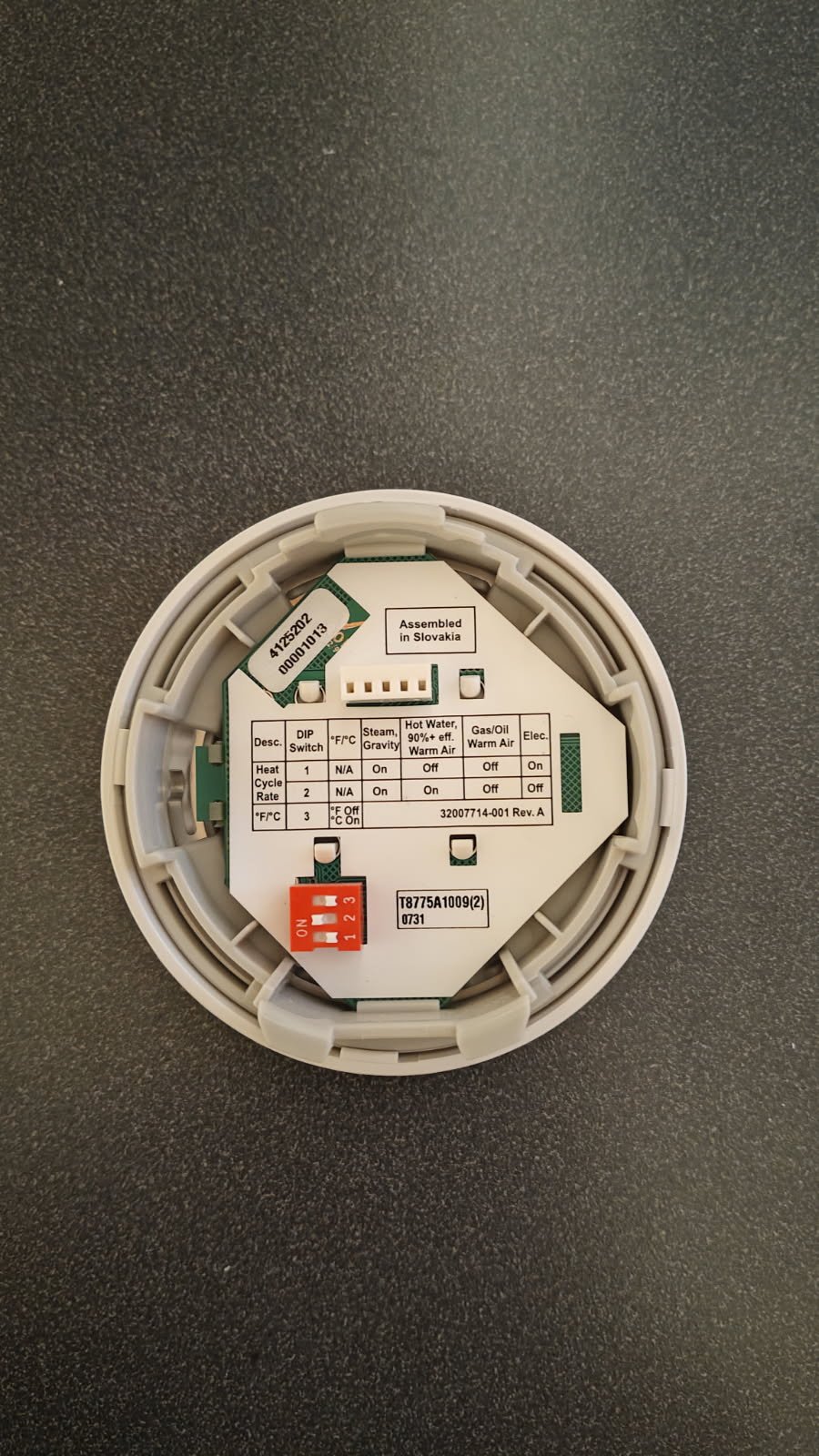

    I read you on the T-stat location and will give relocation a try…not clear on "configuration" (I manipulated dip switches in all combinations and it produces the same results)

    dip switch 1 and 2 on would be the correct setting for your system.
  • Yellowlab
    Yellowlab Member Posts: 22
    Did the easy thing for now Matt. Flipped dip switches per your suggestion. Love my old house but not the inefficiencies…
