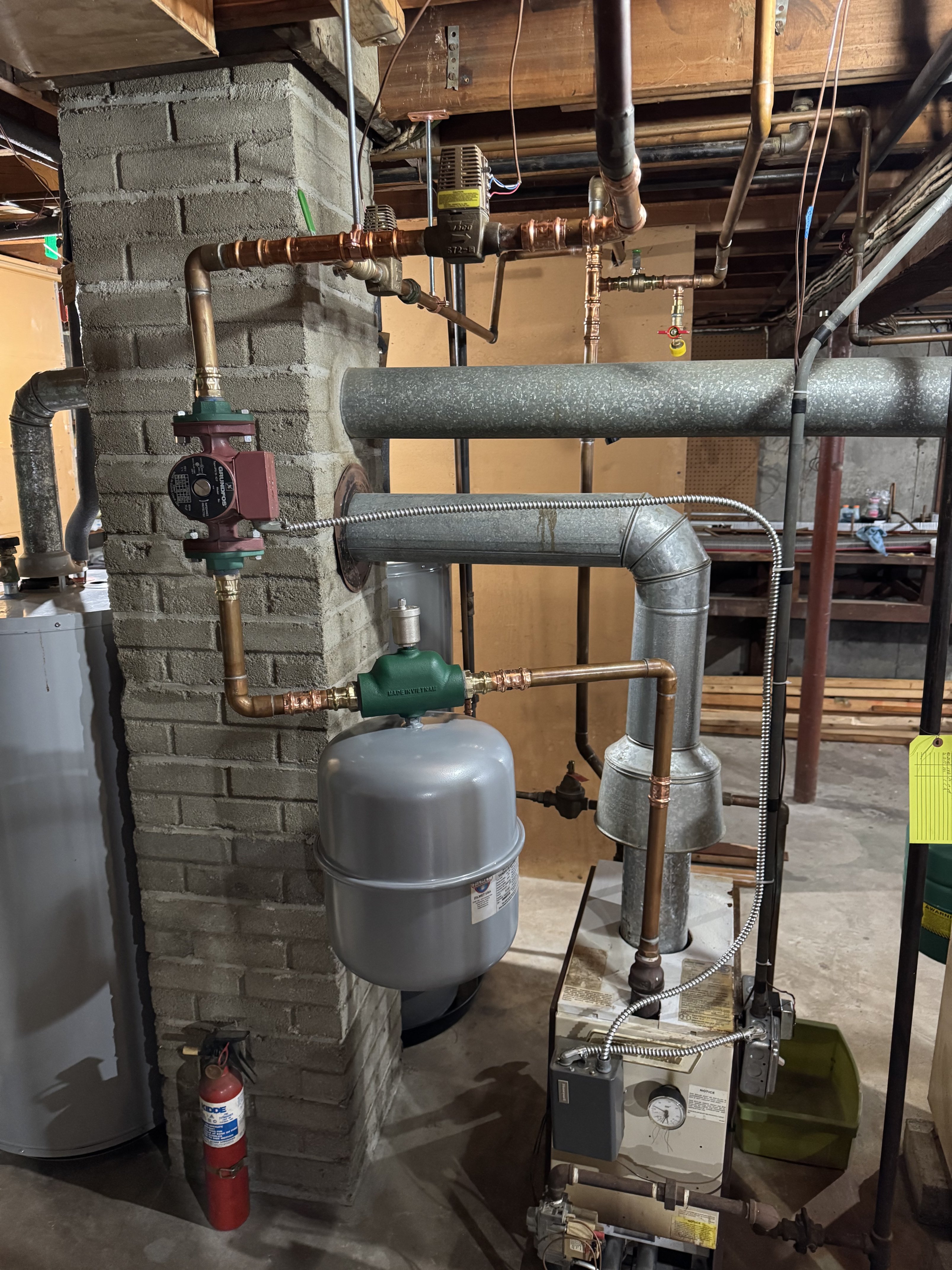

I recently removed a few baseboard units from closets and took the opportunity to replace the steel expansion tank (which was noisy) and an old, rusty air scoop with a clogged vent—likely 70 years old—in my hydronic system (HydroTherm HC-85-C boiler). The circulator is on the return side, and the expansion tank is on the supply side.
I also shut off the basement zone and initially replaced the steel tank with a 4.4-gallon diaphragm expansion tank (photo attached). After purging air and running the system, the boiler pressure occasionally rose above 20 psi. Two days later, after about an hour of operation, the pressure relief valve discharged (over 30 psi), and the boiler pilot shut off.
I then upgraded to a 6.3-gallon tank, but the issue persists. The tank appears fine upon inspection. Even when idling overnight, the pressure continues to rise. I’ve been monitoring the system and manually discharging pressure through the relief valve. Could a faulty auto-fill valve be the cause? I tried isolating it by closing the inlet valve, but the problem persists. Also, the boiler’s pressure remains in the low 20 psi even after the thermostat temperature is reached and the boiler idles and starts cooling down.
Many online sources suggest mounting the expansion tank on the return side (the “point of no pressure change”) while keeping the air scoop on the supply side with its tank port capped. Does this configuration make sense for my setup, or is it time to call a plumber?

    Wrong expansion tank location. Are both zone valves in use? Do you have 2 thermostats? Why are the manual ball valves closed? What type of radiators are you using? Are there monoflow tees in the basement that lead to the radiator returns?

    This looks like a high head circ, is it pumping towards the boiler. In any case the expansion tak needs to be connected on the inlet side of that circ.
    A slow creep in pressure could be a fill valve leaking past.

    A few things:
    1. What did you set the precharge air pressure to on the expansion tank?
    2. Are you sure that the shut off valve before the fill valve is holding?
    3. Could there possibly be a check valve in the pump? If so, when the zone valves close and the pump stops, the boiler is then isolated from the expansion tank and there’s no place for the water to expand into. There should never be a check valve when you have zone valves.
    4. Moving the expansion tank connection to the return, upstream of the circulator, would be a good for helping to remove air from the system, but I doubt that it would have any effect on your issue.
    5. An MBR, like a SpiroVent would have been a much better choice than the air scoop.
    The most likely culprit is the fill valve, but I’d like to see some pics of the piping where you removed the radiators.

    I see that the expansion is on the other side of the zone B zone valve. This will be a problem.
    Look at the red arrow in the boiler that originates at the circulator. You also need to understand the concept of the Point Of No Pressure Change (PONPC starts at time stamp 21:30 in this webinar). Or you can "take my word for it" for now and watch the entire webinar when you have time With that information in the back of your head, the system that is full of water with no circulator operating will be about 15 PSI in the basement. When the circulator operates the pump creates a pressure difference between the inlet of the pump and the outlet of the pump. When zone B is open the pump will push against the 15 PSI in the expansion tank. So if we account for the pressure drop thru the boiler at about 1 PSI that means the pump discharge is at about 16 PSI. If the pump is producing 6 PSI of pressure difference, that means that the inlet to the pump has dropped to 10 PSI.
    However when the B zone is closed and the A zone is open, the pump is no longer pushing against the PONPC of 15 PSI. It is now pulling away from the PONPC thru the entire zone B loop with all the pressure drop of that zone B piping system. Now that will be the 15 PSI of the expansion tank PONPC minus the pressure drop of the entire zone B piping all the way back to the closed zone valve. That long run of piping and radiators may have a pressure drop of more than 15 PSI at the pump inlet. When that happens the boiler will change pressure to 0.0 PSI at the pump and 6 PSI at the outlet of the pump to the ability for the system to remove air and if that may also be causing the second floor radiators to actual operate under a vacuum since the will be operating below the minimum static pressure to keep the higher floor radiator air free and eliminate pump cavitation.  You can stop watching at about time stamp 28:39

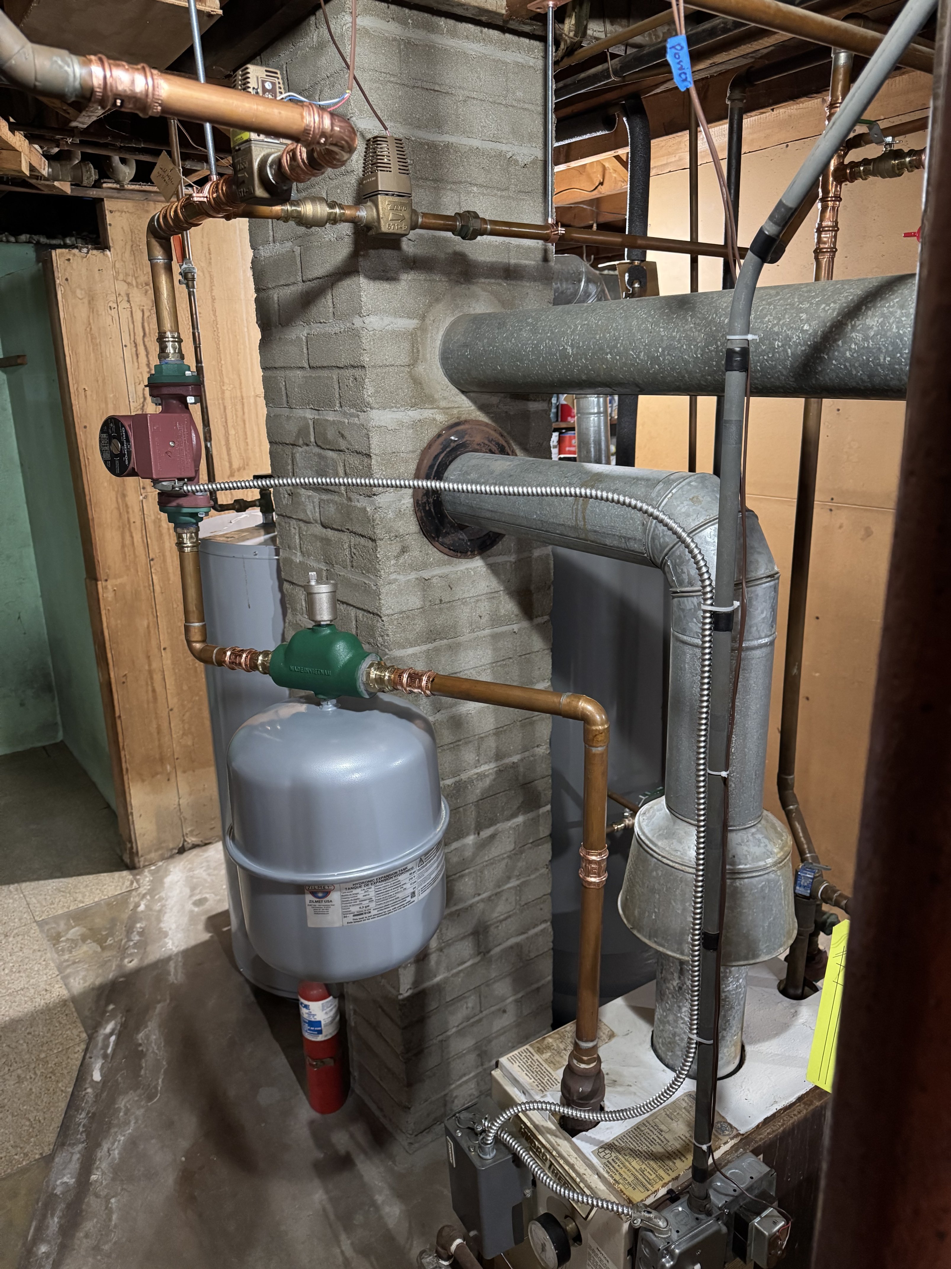

    Below are some pictures of the redesign. I reworked the piping and installed new electrical wiring and thermostat connections. It’s been running great for the past four days. The boiler pressure is holding steady around 18–20 psi.
    Based on what I’ve observed, the system overall is working much better and noticeably quieter than before, when it had the old steel expansion tank. Down the line, I plan to add a few more ball valves to isolate certain components and make maintenance easier.
    Thanks @EdTheHeaterMan and everyone else who provided input!
    I’m planning to complete the plumbing for the basement zone soon using PEX and baseboards. Any suggestions or things I should keep in mind?

    EdTheHeaterMan Member Posts: 12,542
    I like it.
    now you can watch the boiler gauge to see if there is an increase in the operating pressure.
