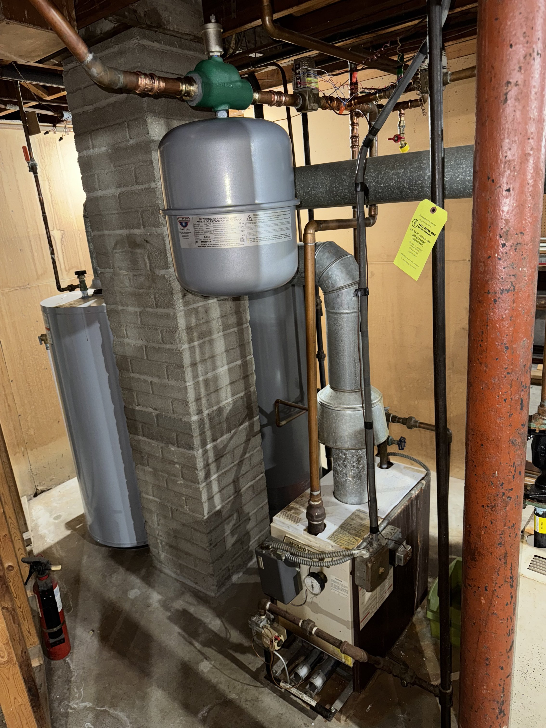

I recently removed a few baseboard units from closets and took the opportunity to replace the steel expansion tank (which was noisy) and an old, rusty air scoop with a clogged vent—likely 70 years old—in my hydronic system (HydroTherm HC-85-C boiler). The circulator is on the return side, and the expansion tank is on the supply side.
I also shut off the basement zone and initially replaced the steel tank with a 4.4-gallon diaphragm expansion tank (photo attached). After purging air and running the system, the boiler pressure occasionally rose above 20 psi. Two days later, after about an hour of operation, the pressure relief valve discharged (over 30 psi), and the boiler pilot shut off.
I then upgraded to a 6.3-gallon tank, but the issue persists. The tank appears fine upon inspection. Even when idling overnight, the pressure continues to rise. I’ve been monitoring the system and manually discharging pressure through the relief valve. Could a faulty auto-fill valve be the cause? I tried isolating it by closing the inlet valve, but the problem persists. Also, the boiler’s pressure remains in the low 20 psi even after the thermostat temperature is reached and the boiler idles and starts cooling down.
Many online sources suggest mounting the expansion tank on the return side (the “point of no pressure change”) while keeping the air scoop on the supply side with its tank port capped. Does this configuration make sense for my setup, or is it time to call a plumber?

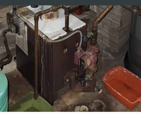

    This looks like a high head circ, is it pumping towards the boiler. In any case the expansion tak needs to be connected on the inlet side of that circ.
    A slow creep in pressure could be a fill valve leaking past.

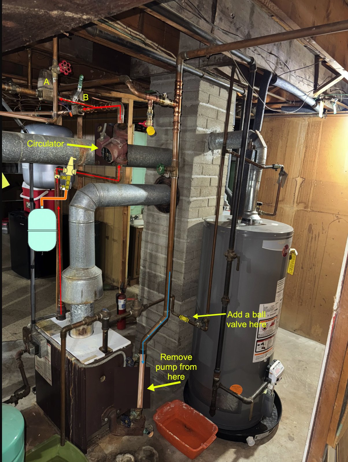

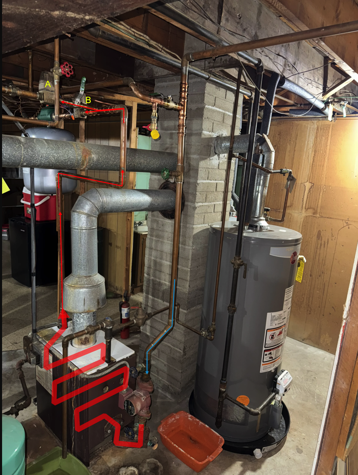

    I see that the expansion is on the other side of the zone B zone valve. This will be a problem.
    Look at the red arrow in the boiler that originates at the circulator. You also need to understand the concept of the Point Of No Pressure Change (PONPC starts at time stamp 21:30 in this webinar). Or you can "take my word for it" for now and watch the entire webinar when you have time With that information in the back of your head, the system that is full of water with no circulator operating will be about 15 PSI in the basement. When the circulator operates the pump creates a pressure difference between the inlet of the pump and the outlet of the pump. When zone B is open the pump will push against the 15 PSI in the expansion tank. So if we account for the pressure drop thru the boiler at about 1 PSI that means the pump discharge is at about 16 PSI. If the pump is producing 6 PSI of pressure difference, that means that the inlet to the pump has dropped to 10 PSI.
    However when the B zone is closed and the A zone is open, the pump is no longer pushing against the PONPC of 15 PSI. It is now pulling away from the PONPC thru the entire zone B loop with all the pressure drop of that zone B piping system. Now that will be the 15 PSI of the expansion tank PONPC minus the pressure drop of the entire zone B piping all the way back to the closed zone valve. That long run of piping and radiators may have a pressure drop of more than 15 PSI at the pump inlet. When that happens the boiler will change pressure to 0.0 PSI at the pump and 6 PSI at the outlet of the pump to the ability for the system to remove air and if that may also be causing the second floor radiators to actual operate under a vacuum since the will be operating below the minimum static pressure to keep the higher floor radiator air free and eliminate pump cavitation.  You can stop watching at about time stamp 28:39

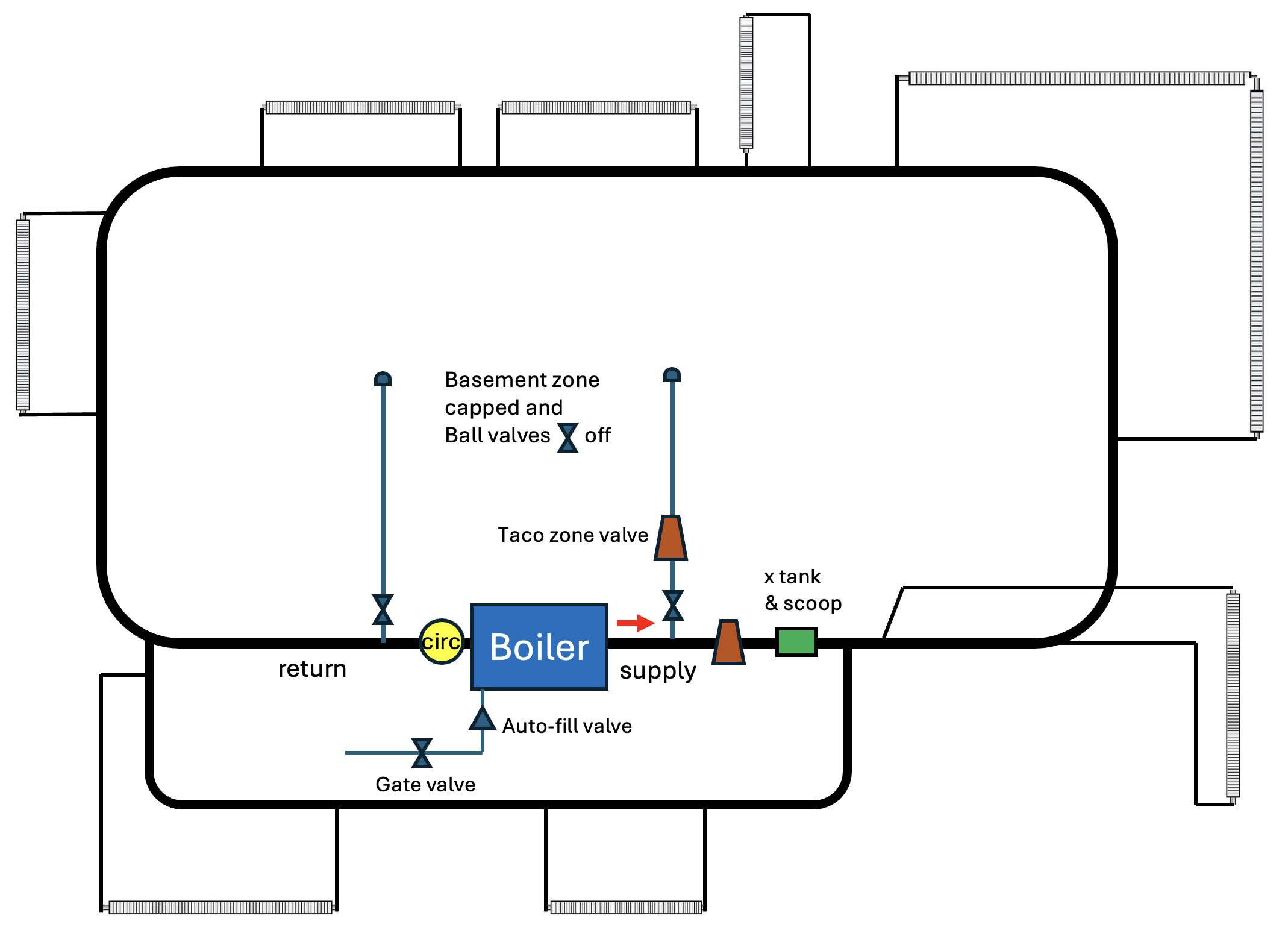

    Only one zone is in use. Yes, I'd have 2 thermostats. The closed ball valves are for the basement zone, which is not in use (will be expanding this in the future). Baseboard radiators. Yes, there are monoflow tees installed for the radiators. Please see the a rough sketch of the system layout below (apology in advance if I am not using conventional plumbing symbols).

    While you have the pump out to check if there is a IFC valve you may as well redesign the near boiler piping. It looks quite easy to do.

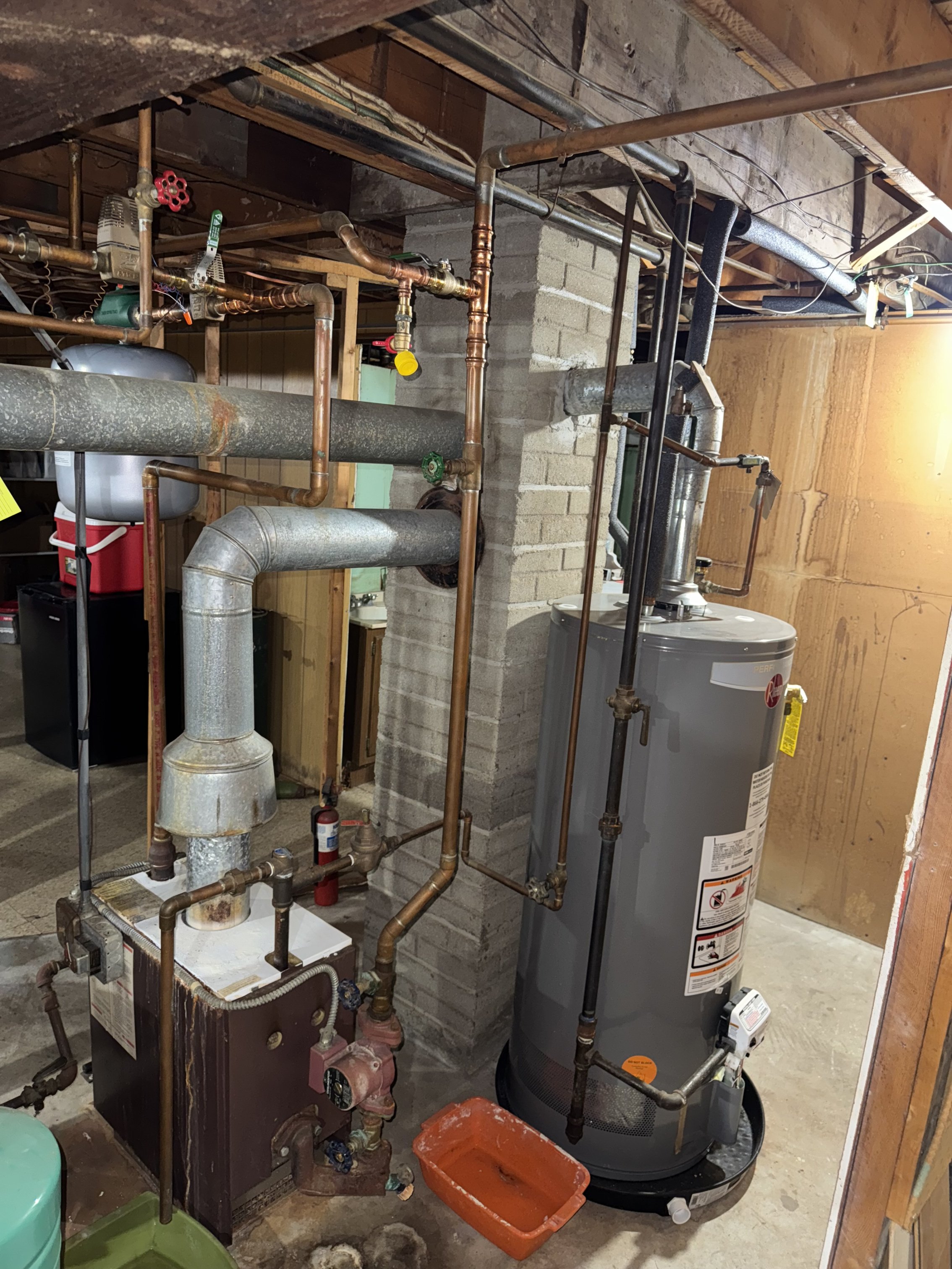

    Yesterday, I implemented your suggestion and everything seems to be working fine. Boiler pressure is right around 19-20 psi during operation and 18-19 psi while idling.
    I installed the x-tank directly underneath the air scoop and am noticing that the top portion of the tank (water) does get hot, about the same temp as the scoop itself. Is this normal? Or should I install something like a 4” brass niple fitting between the x-tank and the scoop?
    I will share pictures once I finish cleaning up the wiring for the stat and power.
    That is normal and you need not do anything about it
