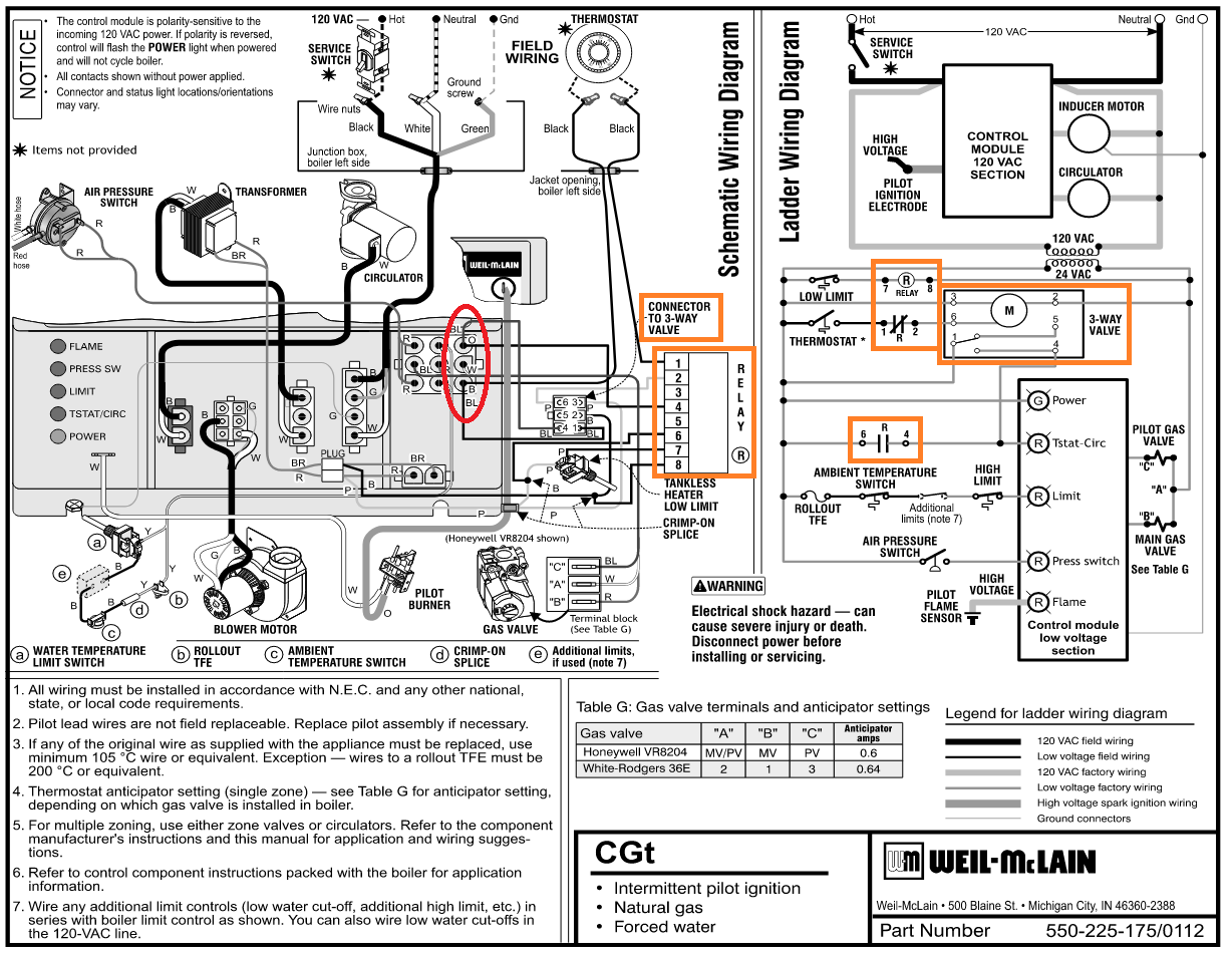

Integrated domestic hot water and baseboard hot water. Stopped responding to thermostat. Will only do constant full on baseboard hot water heat, will not cycle off. Replaced thermostat. Checked thermostat connection to furnace. Is next step replacing control board?
    109A_5 Member Posts: 3,479
    Were both the domestic hot water and the baseboard thermostat / aquastat wires disconnected at the boiler ? Does the control board seem like it is actually receiving a call for heat ? What is the actual boiler model ?

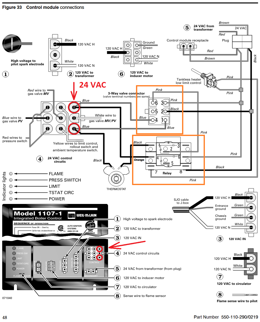

    Looking at the wiring diagram, before I condemned the Control Module, if you have a multi-meter I'd verify there is 24 VAC between the two pins circled in Red below. 24 VAC equals no call for heat. The other way (better than just disconnecting the thermostat wires at the boiler) is unplugging the relay and the connector to the 3-way valve (Orange boxes). The thing is if the relay (pins 4 to 6) or the 3-way valve (pins 1 to 4) has a defect staying closed there could be an erroneous call for heat.

    Weil mclain says replace the 3 way valve and the control panel, that they discontinued this model because of these very problems.
    From the other end of a phone line that is an easy recommendation, might as well recommend replacing the whole boiler with one that does not have those issues.
    Replacing the 3 way valve and the control panel may resolve 99% of the issues, however other things could be at fault, like the relay and the wiring.
    But when the boiler is out of warranty and at the customers expense what do they care ?
    Also their experience may have proven that Plumbers and HVAC Technicians are not strong electrical control troubleshooters, as far as issues internal to the boiler and the 'Parts Cannon' or 'Shotgun' repair strategy more often than not works to get the boiler working again.
    In my opinion if the control panel is in fact defective the parts to repair it may be under $10 or a bad solder joint just needs repair. If you replace everything it could be you learn nothing unless an analysis is done later.
    I like finding the exact issue and just replacing / repairing the defective issue.
    You could make the argument that replacing everything freshens things up, however it is at the customer's expense.
