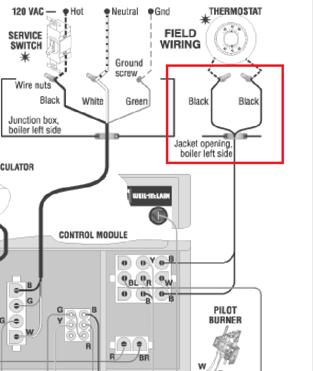

    109A_5 Posts: 4,761
    Looking at the wiring diagram, before I condemned the Control Module, if you have a multi-meter I'd verify there is 24 VAC between the two pins circled in Red below. 24 VAC equals no call for heat. The other way (better than just disconnecting the thermostat wires at the boiler) is unplugging the relay and the connector to the 3-way valve (Orange boxes). The thing is if the relay (pins 4 to 6) or the 3-way valve (pins 1 to 4) has a defect staying closed there could be an erroneous call for heat.

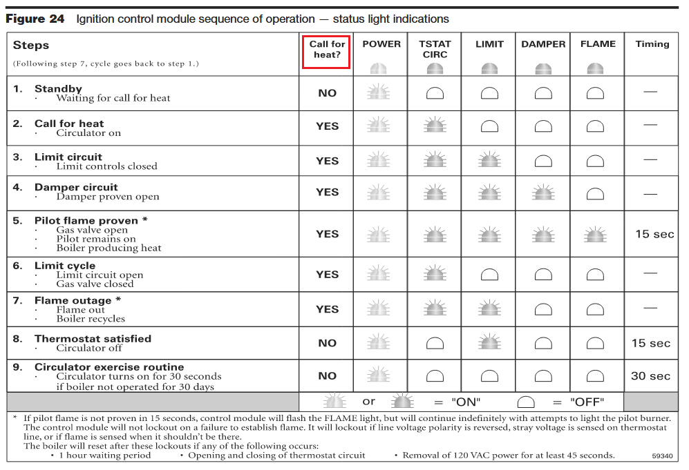

    That seems like a new symptom, I did not find that symptom mentioned earlier in the thread. You are referring to the circulator that the boiler's control board has control over. How many circulator are in the system ?
    What LEDs are presently on ?
