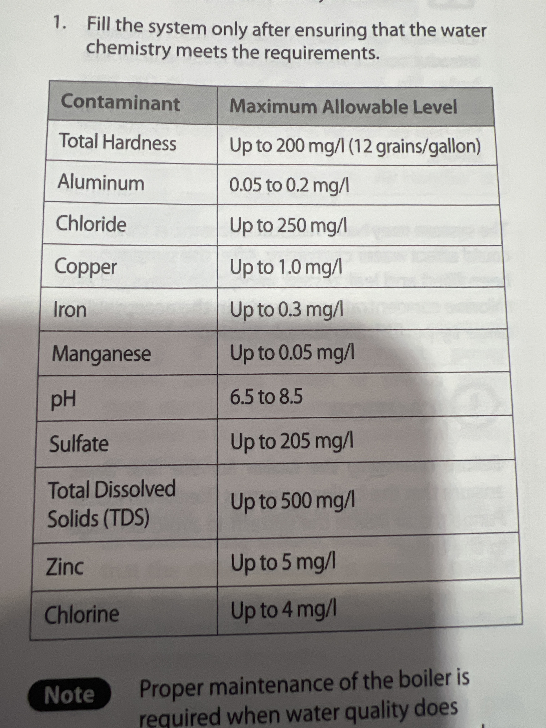

    Your boiler manual will have a water quality spec for those levels. If it is out if wack bring in some water. Walmart and others sell ro water take a few 5 gallon jugs

    Our municipal water varies from a TDS of 100 on a good day to 1200 at its worst.
    So the advise seems to be
    • Check Hardness, TDS, PH and Cl of local water, dilute it with clean water if necessary.
    • Add Cleaner before draining and add an inhibitor during refill.

    Water requirements for Navien seems to be very permissive, I’m not complaining 😀Just not use soft water.
