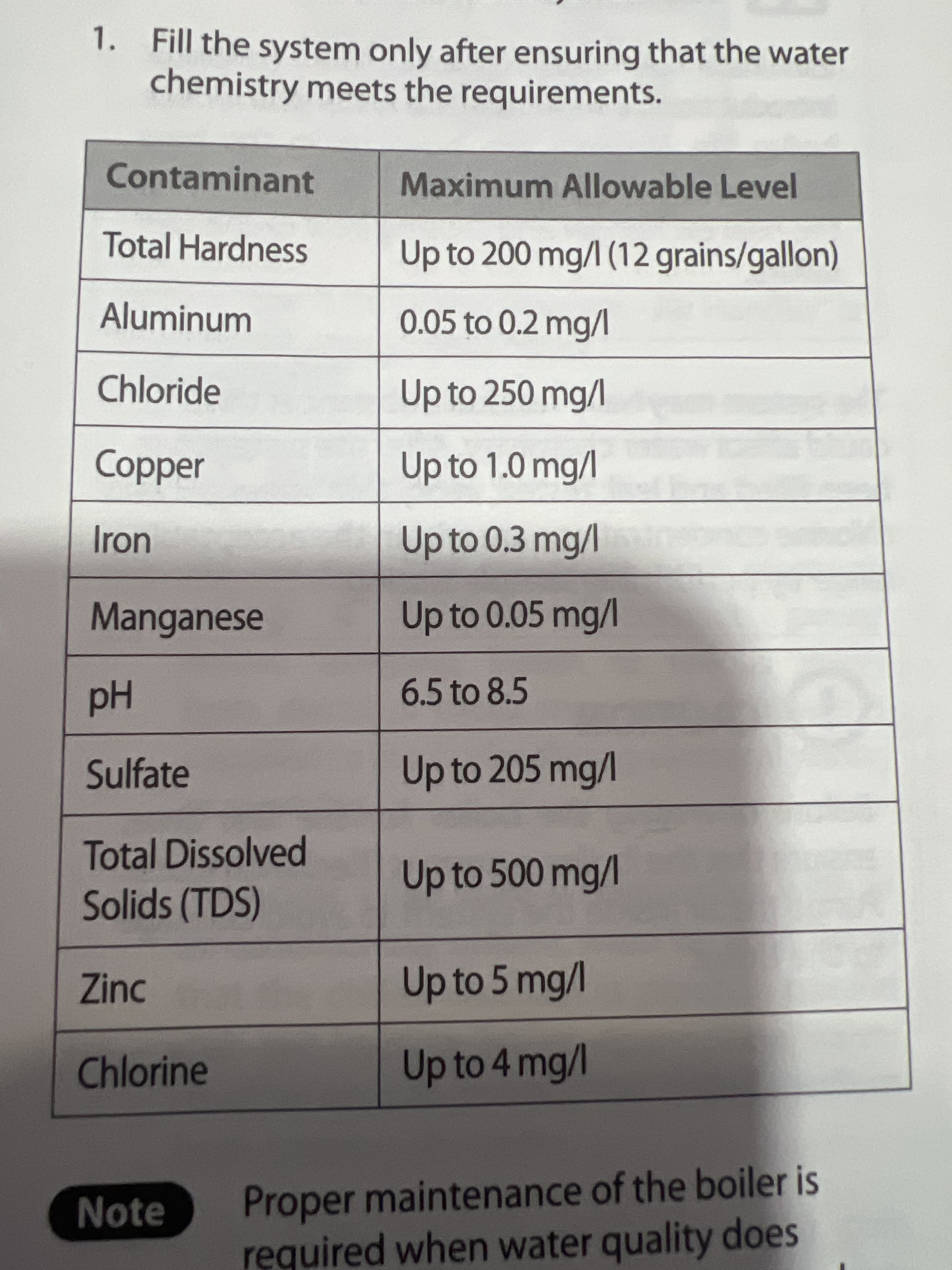

Your boiler manual will have a water quality spec for those levels. If it is out if wack bring in some water. Walmart and others sell ro water take a few 5 gallon jugs

Our municipal water varies from a TDS of 100 on a good day to 1200 at its worst.
So the advise seems to be
- Check Hardness, TDS, PH and Cl of local water, dilute it with clean water if necessary.
- Add Cleaner before draining and add an inhibitor during refill.
