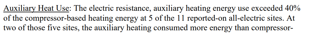

@Kaos , it’s an interesting theory, but per the study: “Most of the all-electric sites had very few hours with outdoor temperatures below the compressor lockout temperature.” This is the maximum outdoor temperature at which the auxiliary heat source operates, so it will not run unless it’s very cold out. The auxiliary heater ran 4.8% of the time on average at these sites.
“Additionally, all the sites were in dry climate zones where the need to defrost the outdoor coil would be much less than that of heat pumps installed in humid or marine climate zones.” We could expect the efficiency to be worse on the east coast, especially near the Atlantic or where it is more humid in the summer.

» it will not run unless it’s very cold out. The auxiliary heater ran 4.8% of the time on average at these sites.
That's 420 hours or 18 days of super cold where we're using resistive electric heating.

Thank you, @mattmich - I should have been more clear as that is actually 4.8% of the time the systems were monitored during the study, not of the entire year, but still about 200 hours in a heating season. The vast majority of the energy consumption is from the compressor.
To your point about stressing the grid, adding heat pumps will need to triple the size of the residential grid power supply in cold climates, and adding electric vehicles for each home will move it to 4X - that's a lot of pizza. Some states like Maine have electric grids that are already "winter peaking", using more electricity in winter than summer.

The 2.1 COP is the average system heating results in the study - I'm sure you saw the below chart and the supporting data in Table 11. Even a quick glance shows the average is not the 3.0 COP you claim. Sometimes I feel like you are just trying to troll me…

The heat pump graph you pulled shows exactly what I was talking about. The data clearly shows the energy use from aux drops the seasonal COP down. These units won't lock out till like -30F in most cases but will need to use aux heat (that is heat pump plus aux at the same time) if the heat pump is undersized.
The efficiency of most systems (some outliers for sure) is about 3 COP if you take out aux heat (blue bars). Some sites didn't have aux heat (ie #3) and is close to 3. The text even say that most units hit their HSPF2 efficiency in the field (HSPF2 of 10 is about seasonal COP of 3).
If you re-run your fuel cost with 82% boiler and 3 COP HP, the cost difference will be noise. If power cost go up, with a heat pump you can always add PV to offset cost but you can't make oil (or at least not easily) at home.
