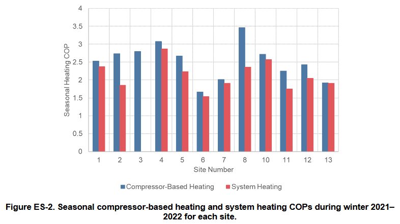

    @Roger Can you post the section with the seasonal COP of 2.1
    Most of the stuff I quickly read said efficiency as expected based on manufacturer data. For most this means COP around 2 at 5F, not seasonal COP of 2.

    The 2.1 COP is the average system heating results in the study - I'm sure you saw the below chart and the supporting data in Table 11. Even a quick glance shows the average is not the 3.0 COP you claim. Sometimes I feel like you are just trying to troll me…

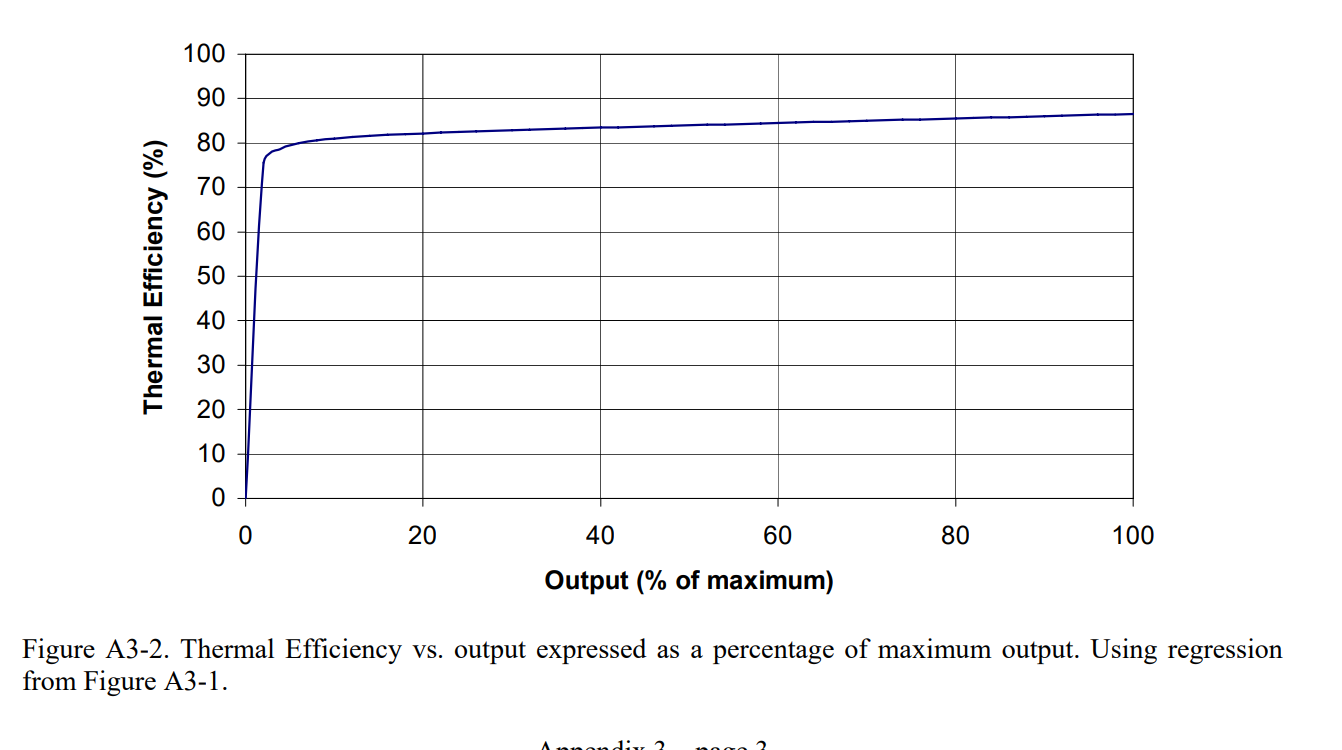

    @Roger I took a quick look at that DOE study I'm guessing in the boiler is #3. Here is the part load numbers for the unit:
    Which is pretty good, most likely you will see about low/mid 80s efficiency in the real world assuming 2x to 3x oversize.

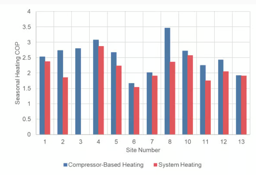

    The heat pump graph you pulled shows exactly what I was talking about. The data clearly shows the energy use from aux drops the seasonal COP down. These units won't lock out till like -30F in most cases but will need to use aux heat (that is heat pump plus aux at the same time) if the heat pump is undersized.
    The efficiency of most systems (some outliers for sure) is about 3 COP if you take out aux heat (blue bars). Some sites didn't have aux heat (ie #3) and is close to 3. The text even say that most units hit their HSPF2 efficiency in the field (HSPF2 of 10 is about seasonal COP of 3).

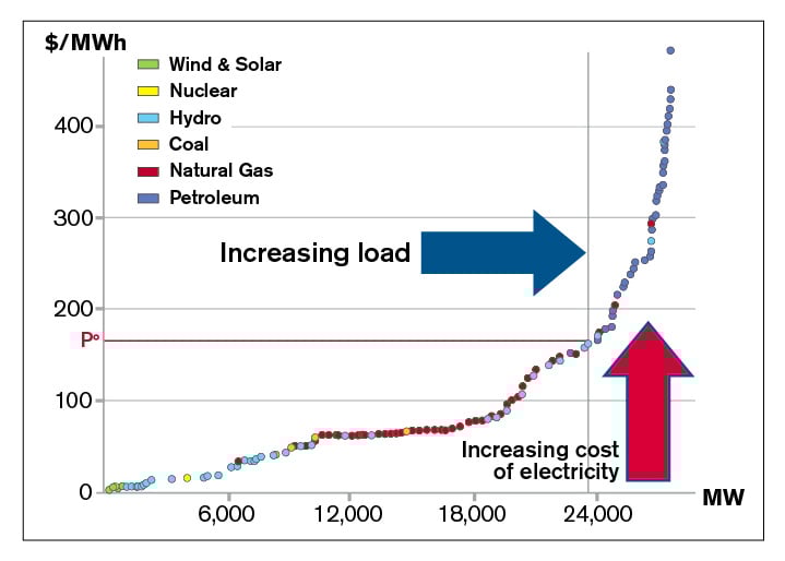

    @Kaos , tripling or quadrupling demand will have an outsized impact - "when heat pump loads push up grid loads and costs, power plants win big while all ratepayers end up paying more, which is reflected in the 'energy supply' component of a consumer’s electricity bill." Article and graph. A 10% increase in electrified homes drives a respective 30% increase in demand. Full electrification will drive a 3X to 4X increase in residential demand, which is more than a bit intimidating to contemplate.
    The heat pump chart you are referencing shows the impact of auxiliary heat, defrost cycle losses and more in the red bars which results in an average 2.1 COP annually; the blue bars are not inclusive of the full analysis and should not be used to present an artificially high performance level. Although the blue bars should not be used, the average is 2.5 COP, and at a glance you can tell it is not the 3 COP you posted (still trying to troll me?). In addition to comfort, the expense of winter heating is a primary reason why there is a 60% to 80% heat pump drop out rate.
    The low mass, thermal purge 87.5 AFUE boiler referenced has an 85.3% annual heat and hot water efficiency with an oversizing factor of 3, not the 82% you posted (see table 3).

    @Roger I appreciate the load vs. wholesale chart. But why are we assuming no generation will be added? That's what the chart implies. If other states can support high kwh/capita with low rates, what's so special about other states that they cannot?
