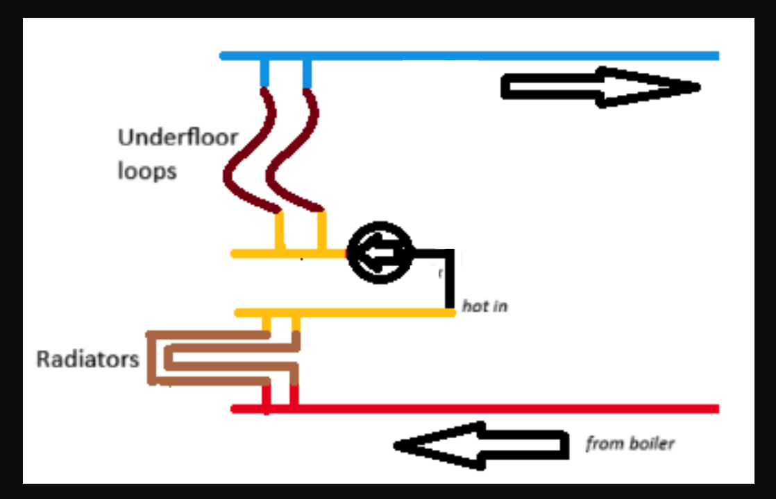

I am replacing non oxygen barrier pipe (polybutylene) for underfloor heating in a section of my house with 2 small bedrooms and an open concept space for dining room / office. Boiler output temp varies from 120 to 180 depending on demand / outside temps.
I don't have good access to the bedrooms to replace piping without significant tear-out and repair, so planning on putting baseboard radiators in them instead (8 feet of radiator per room). The open room will remain underfloor heat, with two loops approx 200 feet per loop. Underfloor piping will be sandwiched between subfloor and premium laminate flooring, so low temperature setting in floor. Because the total space is less than 1000 feet and has similar heating needs, one zone seems to make sense. I'd like to use a single circulator pump, since a standard pump supplies enough flow to run the radiators and the two loops. However, there does not seem to be a "textbook" way of providing separate temperatures without two pumps.
What I'm wondering is if something like this would be worth trying. I need to do the calculations to be sure, but I don't think the water returning from radiators will have lost enough temperature to drop below target temperature for underfloor. Apologies up front for the poor drawing.

    In your drawing how would the radiators return to the “blue” return piping?

    " In your drawing how would the radiators return to the “blue” return piping? "
    I would say through the underfloor loops.
    To me, the added (?) circulator (circulator sizing ?) hopefully creates an added parasitic flow through the cold port of the mixing valve (Violet arrow) to lower the Underfloor supply temperature, assuming the return temperature is low enough to do so.
    If that is the only circulator in that loop the rooms with the radiators may go through wider temperature swings.
    "open room will remain underfloor heat"
    What limits the water temperature to this zone now ?
    If making them two different zones is like major construction, I'd try it and see how it works out, if it fails well you know what you need to do.

    Radiators would not return directly to the cold side. Rather they would return through the hot inlet of the mixing valve, through the radiant floor loops, then on to cold.

    As drawn, it can't work.
    There is nothing to drive cold water flow through the mixing valve. Water needs a pressure differential to flow, the pressure at the tee on the outlet is going to be lower than at the mixing valve, nothing is going to cause water to flow in that direction. Mixing valves don't suck.
    With no cold water flow, the mixing valve will shut if the water presented to it is warmer than the set point. The entire flow of the circuit flows through the mixing valve, so when that happens the entire circuit shuts off, dead-heading the circulator. Depending on the circulator type that might be something you want to avoid.
    The only way this can work with one circulator is if the two parts are in series. There is some chance — although vanishingly small — that both parts can deliver their optimal performance with the same flow. If not, you can put a bypass pipe with balancing valve on the part that needs less flow.

    As drawn by OP, the setup will work. The key is to have only a reasonable delta T across the high temp loop. 8' of baseboards won't drop the temp much and won't be all that much extra pressure drop. Essentially the baseboard will look like an extra long supply pipe to the low temp zone.
    I wouldn't bother with any bypass, get baseboards with adjustable louvers for local temperature control. If you want to get fancy, you can get a zone valve as a bypass with a local thermostat (you'll need a valve on the baseboard to add a bit of restriction for this to work).
    8' of baseboard is on the small side if you want to use lower water temps. I would go for a bit longer, never hurts.

    In the original drawing, what would make any water flow down from the tee drawn in blue? To the extent there's any pressure difference, the pressure at the tee is going to be lower than at the mixing valve, water will want to flow up there.
  • DCContrarian
    DCContrarian Member Posts: 1,261
    Here's what I see as the fundamental problem with this layout: the water flow through the radiators is going to be the same as through the in-floor tubing. Which means that the control strategy for both has to be the same. But the optimal control strategies are very different. So even if you could get it working where the flows and temperature drops are what you want, it's not going to be able to deliver consistent comfort.

    @EdTheHeaterMan The setup doesn't need the same flow as the extra heat now comes from higher supply temperature, instead of 4gpm 10f delta, you run 2gpm 20f delta. With a modcon, higher supply temperature is free as long as the RWT is about the same which would be in case of a series setup.
    @DCContrarian The pump creates a low pressure at the inlet, depending on the position of the mix valve, it will "suck in" water from the blue T without issues. Control can be a challenge but as long as the baseboard emitters are oversized, you can always close the louvers on it to reduce output. You don't have individual control of the series zone, but could be set up to get a reasonable balance.

    There is a lot of ideas being floated here. I would like to know what @hot_rod, @109A_5, @mattmia2, @Kaos and @DCContrarian think regarding diagram B and Diagram C below. Without more input from @inaun I can only make assumption that in my illustration A = something that has been working fine for years and now has 2 bad poly tubing loops that need to be addressed.
    The poly tubing does not have an oxygen barrier
    That means that the boiler and all the accessories are not cast iron or steel. They all must be made of Copper, Bronze or Stainless steel. Can we all agree on that?
    Trying to fix the "failed tubing" heated area with copper baseboard it the lowest cost way to replace the heat in the rooms that no longer have working floor heat. Can we agree on that?
    What @inaun wants to do is the lowest cost way that will work. One of the ideas floated is to use the existing circulator to move heated water through both the baseboard and the radiant floor tubing with no actual control over the flow rate except for the manifold connections from the working tubing loops, as illustrated in diagram B above. I personally don't see it providing 10,000 BTU of heat in the way that diagram A is providing. 10,000 BTU of heat (2 GPM @ 10° ∆T) You can not get the same amount of heat that 4 poly tubes can provide when you are trying to put that same amount of heat thru 2 poly tubes. It ain't gonna happen.
    Does anyone thing that you can? Really?
    Does anyone think that diagram C is not going to work? If not, why not? With the proper relay you can operate both pumps with the same thermostat. It is just gonna cost a little more to buy a new bronze or stainless pump and a relay to operate it. Not ideal for keeping cost down, but when the temperature drops to design temperature, @inaun will find out too late that diagram B was a mistake.

    @EdTheHeaterMan personally I would go with your recommended 'C' option with each circulator being its own sub zone (I believe they are separate rooms), since that will most likely provide the best comfort control. If for @inaun that is not doable i'm just providing other ideas / options. As I stated early on in this thread the OP's original idea may have issues as far as comfort control.

    At that point you have to delink the two rooms, put each on its own circulator and thermostat or other control mechanism.

    Thinking more about my previous comment, it occurs to me that if you have two radiators in series, the relative amount of heat each one puts out is proportionate to the temperature at their midpoint. So if water is leaving the boiler at 180F, returning at 100F, and the midpoint is at 120F, the first radiator is going to have three times the output of the second one. There's just no way around it, heat delivered is flow times temperature change times 500.
    Since the point of the radiators is two replace two underfloor circuits, I think it's safe to assume we want the outputs to be roughly equal. Which means the upper limit on the water is going to have to be pretty low to keep the underfloor within range.
    Going back to @EdTheHeaterMan 's diagrams above, I'm thinking the way to go is something like diagram C, but instead of using a thermostatic mixing valve just using a tempering valve. That way the outdoor reset on the boiler still affects the water temperature but you can have hot water going to the underfloor circuit and mixed down.

    @DCContrarian what is the difference between a tempering valve and a mixing valve?
  • DCContrarian
    Sure, what I mean is a non-thermostatic valve that just mixes the two sides in a constant proportion. So as the outdoor reset modulates the leaving water temperature the mixed water temperature changes proportionally. The goal is to be getting the benefit of outdoor reset at temperatures the underfloor can use.
    EdTheHeaterMan Member Posts: 11,174
    is such a valve available at a reasonable cost @DCContrarian ? I know of a motorized valve from Taco that will take the already reset water for the higher temperature radiators and reduce it to a lower temperature reset for the floor heat. “ Resetting the reset”
    that valve plus the accompanying outdoor and pipe sensors and accessories will cost the OP over $800.00. Dollars plus whatever labor and markup might be included to make the project well past the $2000.00 mark (just guessing not an actual price quote). That is probably not an option in this case since the OP was trying to get it done using only one circulator.
    I believe my 2 circulator suggestion with an inexpensive tempering/mixing valve fits the bill here
    What do you think?

    Maybe I've been misunderstanding all along, but when the OP talked about a mixing valve I assumed it was a thermostatic mixing valve.
    I think we're on the same wavelength, I'm talking about a simple valve where you set the balance of the flow and forget about it, something like this:
    https://www.supplyhouse.com/Bluefin-ASV050-1-2-Brass-Anti-Sweat-Valve-w-Nuts
    That's not exactly right but it was the quickest thing I could find. You could even just have a tee and balancing valves inline on the hot and cold supplies. The idea is that it's going to keep roughly the same proportions of hot and cold regardless of temperature — and roughly is good enough.
