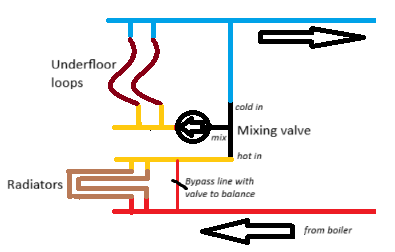

Multiple temperatures on single zone with single circulator pump?
I am replacing non oxygen barrier pipe (polybutylene) for underfloor heating in a section of my house with 2 small bedrooms and an open concept space for dining room / office. Boiler output temp varies from 120 to 180 depending on demand / outside temps.
I don't have good access to the bedrooms to replace piping without significant tear-out and repair, so planning on putting baseboard radiators in them instead (8 feet of radiator per room). The open room will remain underfloor heat, with two loops approx 200 feet per loop. Underfloor piping will be sandwiched between subfloor and premium laminate flooring, so low temperature setting in floor. Because the total space is less than 1000 feet and has similar heating needs, one zone seems to make sense. I'd like to use a single circulator pump, since a standard pump supplies enough flow to run the radiators and the two loops. However, there does not seem to be a "textbook" way of providing separate temperatures without two pumps.
What I'm wondering is if something like this would be worth trying. I need to do the calculations to be sure, but I don't think the water returning from radiators will have lost enough temperature to drop below target temperature for underfloor. Apologies up front for the poor drawing.

    I should have also noted this is just one zone in a larger system. The feed and return are from/to the primary loop.
    hot_rod Posts: 28,705
    what about using panel radiators and running one low temperature system. The lower the boiler operating temperature the better the efficiency. Even with cast or non condensing boilers
    Do you have a heatloss number for all the rooms? That would help size and select heat emitters
    In your drawing how would the radiators return to the “blue” return piping?

    I thinking that will be an interesting balancing act between emitter dissipation and the heat loss of the different rooms. You don't want one room 65 degrees and the other 72 degrees. You may need other 'local' control(s) to modulate or bypass the hotter room, assuming the boiler's zone thermostat is in the cooler room.
    " In your drawing how would the radiators return to the “blue” return piping? "
    I would say through the underfloor loops.
    To me, the added (?) circulator (circulator sizing ?) hopefully creates an added parasitic flow through the cold port of the mixing valve (Violet arrow) to lower the Underfloor supply temperature, assuming the return temperature is low enough to do so.
    If that is the only circulator in that loop the rooms with the radiators may go through wider temperature swings.

    Thanks. That was my first thought, then I looked at the cost of panel radiators compared to baseboard for the size I'd need running at lower temperature. Not in the budget.
    Radiators would not return directly to the cold side. Rather they would return through the hot inlet of the mixing valve, through the radiant floor loops, then on to cold.

    1) Will the mixing valve open too much on the cold side to properly flow the radiators? If this does happen, the valve should close cold side back down fairly quickly to satisfy need for higher temp in the floor loops. But the radiators would then "surge" as they rely on draw from hot side of the valve.
    2) Will the water temp from the radiators in real-world follow calculated loss to deliver sufficient temp to the floor (especially considering the output temp of the boiler varies…again in theory all good since boiler temp is higher in cold weather…but theory and reality don't always match!
    If this seems like something worth trying, I can do so knowing I might need to add the second pump if it does not work. I'll be working with PEX, and set up the layout to facilitate that modification without too much headache.
    But…if it's one of those "no way that's going to work" things…

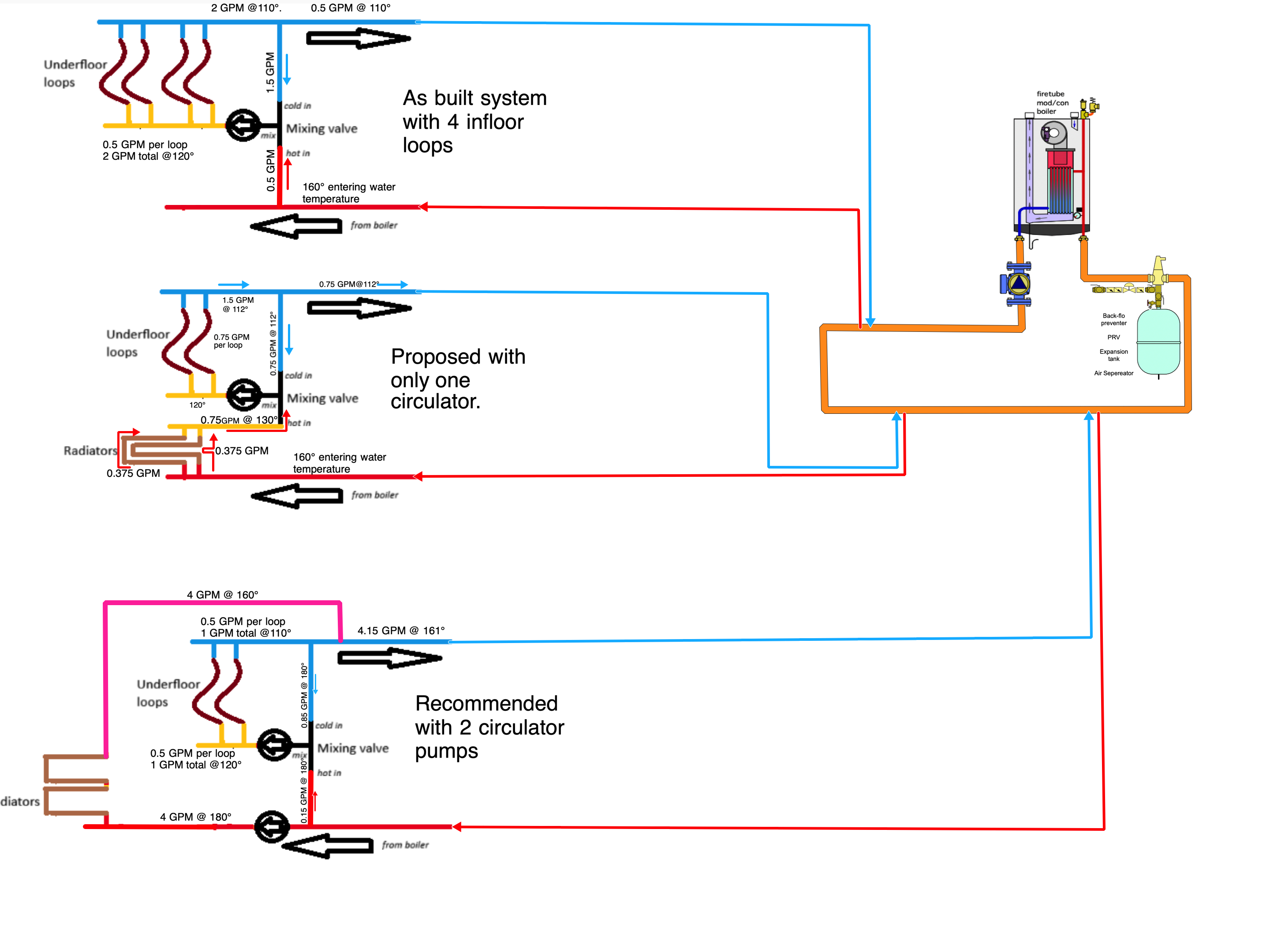

    I can only guess that since you have non Oxygen Barrier tubing, the boiler is a non ferrous material like stainless steel and the pump is stainless steel or bronze. I learned this the hard way by installing a cast iron boiler to replace a GloCore Stainless steel boiler on a non barrier tubing system. It was a disaster. After 2 years of operation, the tubing was caked with mud from all the oxygen entering the system and causing the CI Boiler to turn to rust. Once I figured out the floor heat was non barrier tubing, I needed to flush all the tubes individually with high pressure water (and there were 4 zones with 16 or more loops per zone) then I purchased a stainless steel heat exchanger to separate the boiler from the floor system. I could go on forever about that job, but needless to say I learned an expensive lesson there.
    So now you have a 4 loop zone that has 2 loops that you need to replace for some reason. Your 3/4" fin tube low cost baseboard radiators will be a good choice however you need a second circulator in order to get the proper flow thru the baseboard radiators and you need to get the lower temperature loop to operate independently of the high temperature loop. I can illustrate this using hypothetical flow rates and temperatures using your drawing
    The exact temperatures and flow rates will vary based on your actual as-built system.  The temperatures and flow rates are for illustration purposes only.
    I am guessing that the zone you are referencing may have looked like the top zone in this illustration. Radiant loops on average have a flow rate of 1/2 GPM and the low temperature should not go over 120° With that in mind that zone will circulate about 2 GPM under normal steady state conditions. the temperature drop across that floor will be about 10°. So that is how I guesstimated the temperatures and flow rates
    Looking at the second (middle) zone is your proposed piping arrangement with only one circulator. The pump will have only 2 of the original 4 loops to push water thru.  Since that pump will end up a little higher on the pump curve, let’s say that the pump will try to force ¾ GPM thru that remaining two loops and that will be a total of 1.5 GPM to the zone.  But that is thru the radiant floor loops after it gets mixed.  So how does that hot water get to the mix hot in port?  You pull it thru the baseboard radiators and that 160° water will drop in temperature as it goes thru each of the two radiators.  As those radiators give off their heat from the 160° supply water, the exiting water from those radiators may drop below the 120° needed for the low temperature floor….  But let's not consider that possibility and think positive.  The water now entering the HOT inlet to the mix valve might be 130° and you will need to mix the 112° return water into the mix valve cold inlet to get the 120° low temperature.  The reason the return from the radiant floor is only 112 is because it moved thru the floor faster at ¾ GPM as a result of your redesign.  Now that lower temperature Hot water will need less Cold water to mix to get 120° the numbers might look like this:
    112° at .75 GPM and 130  @ .75 GPM will get you 120° 1.5 GPM so the hot water entering the zone is no longer 2 GPM but has dropped to 1 GPM and the temperature drop is less.  It might work fine in mild weather, but that equals less BTUh delivered to that zone. You will not find this out until the coldest days of the winter when you can least afford to turn off the heat to redesign the system.
    The bottom design will allow you to move 4 GPM 180° water thru the baseboard heaters in order to get maximum capacity from them. The radiant floor will also be able to have the flow adjusted to the 0.5 GPM for each of the two remaining loops. You will also need to add a circulator relay and a thermostat in that zone in order to operate the high temperature pump.  The high temperature pump must be stainless steel or bronze since it is located on the system that is connected to the non-barrier tubing.
    If you ever get a new boiler for any reason, you will need to stay away from steel or cast iron boilers, or you will find out the hard way like I did about that problem. Stainless steel heat exchanger, copper heat exchanger, or aluminum heat exchanger boilers are the only ones you can choose from.  But check with the boiler manufacturer before you connect it to your non-barrier tubing system.
    I hope this helps you to understand that your idea, in concept may make sense, but in reality may not work satisfactorily.

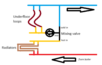

    As drawn, it can't work.
    There is nothing to drive cold water flow through the mixing valve. Water needs a pressure differential to flow, the pressure at the tee on the outlet is going to be lower than at the mixing valve, nothing is going to cause water to flow in that direction. Mixing valves don't suck.
    With no cold water flow, the mixing valve will shut if the water presented to it is warmer than the set point. The entire flow of the circuit flows through the mixing valve, so when that happens the entire circuit shuts off, dead-heading the circulator. Depending on the circulator type that might be something you want to avoid.
    The only way this can work with one circulator is if the two parts are in series. There is some chance — although vanishingly small — that both parts can deliver their optimal performance with the same flow. If not, you can put a bypass pipe with balancing valve on the part that needs less flow.
    I suspect that this system has never worked. As a general note — more to the other readers of the forum — the biggest mistake you can make with hydronics, and we see it all the time, is to assume that things will "just work." People are pouring a concrete slab, and they assume that so long as the put in as much tubing as will fit everything will work out. It won't. These systems need to be engineered.
    I know this is not the answer you want to hear, but before investing any time or money into this system I would do some back-of-the-envelope engineering to determine whether it's actually possible that it could ever work. That means doing a room-by-room heating load calculation and then estimating the heat-providing capacity of the radiators and the in-floor loops, and seeing if there is any combination of flows where both can provide the proper amount of heat needed for their respective rooms. This is important because there is no guarantee that they can; instead, I would say it's rather unlikely.

    As drawn by OP, the setup will work. The key is to have only a reasonable delta T across the high temp loop. 8' of baseboards won't drop the temp much and won't be all that much extra pressure drop. Essentially the baseboard will look like an extra long supply pipe to the low temp zone.
    I wouldn't bother with any bypass, get baseboards with adjustable louvers for local temperature control. If you want to get fancy, you can get a zone valve as a bypass with a local thermostat (you'll need a valve on the baseboard to add a bit of restriction for this to work).

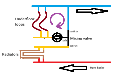

    In the original drawing, what would make any water flow down from the tee drawn in blue? To the extent there's any pressure difference, the pressure at the tee is going to be lower than at the mixing valve, water will want to flow up there.

    Here's what I see as the fundamental problem with this layout: the water flow through the radiators is going to be the same as through the in-floor tubing. Which means that the control strategy for both has to be the same. But the optimal control strategies are very different. So even if you could get it working where the flows and temperature drops are what you want, it's not going to be able to deliver consistent comfort.

    @EdTheHeaterMan The setup doesn't need the same flow as the extra heat now comes from higher supply temperature, instead of 4gpm 10f delta, you run 2gpm 20f delta. With a modcon, higher supply temperature is free as long as the RWT is about the same which would be in case of a series setup.
    @DCContrarian The pump creates a low pressure at the inlet, depending on the position of the mix valve, it will "suck in" water from the blue T without issues. Control can be a challenge but as long as the baseboard emitters are oversized, you can always close the louvers on it to reduce output. You don't have individual control of the series zone, but could be set up to get a reasonable balance.

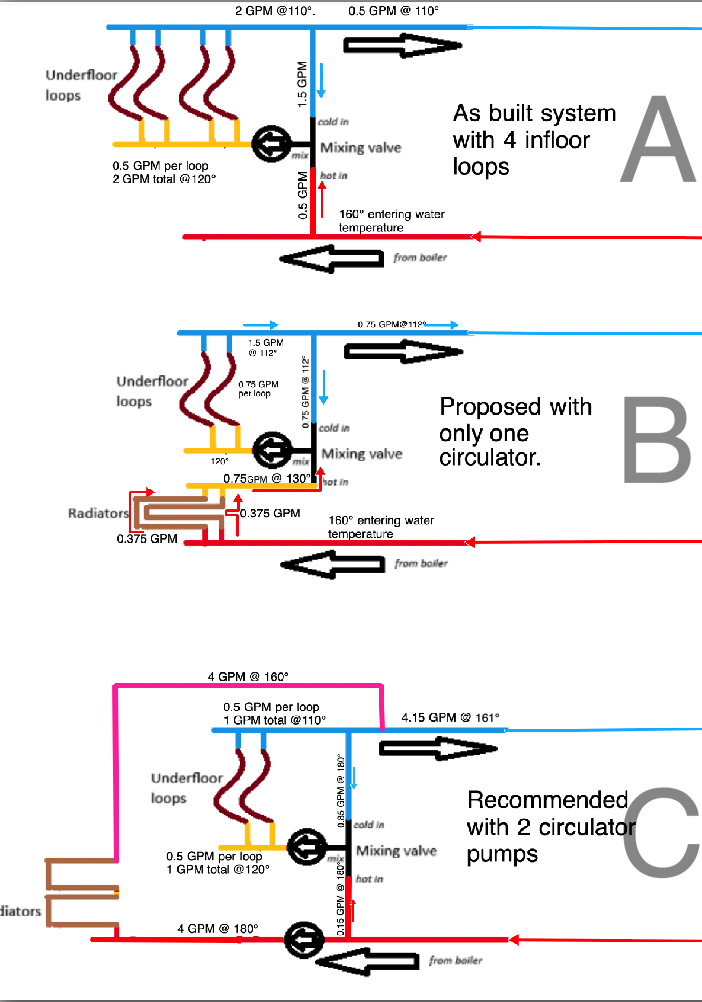

  • There is a lot of ideas being floated here. I would like to know what @hot_rod, @109A_5, @mattmia2, @Kaos and @DCContrarian think regarding diagram B and Diagram C below. Without more input from @inaun I can only make assumption that in my illustration A = something that has been working fine for years and now has 2 bad poly tubing loops that need to be addressed.
    The poly tubing does not have an oxygen barrier
    That means that the boiler and all the accessories are not cast iron or steel. They all must be made of Copper, Bronze or Stainless steel. Can we all agree on that?
    Trying to fix the "failed tubing" heated area with copper baseboard it the lowest cost way to replace the heat in the rooms that no longer have working floor heat. Can we agree on that?
    What @inaun wants to do is the lowest cost way that will work. One of the ideas floated is to use the existing circulator to move heated water through both the baseboard and the radiant floor tubing with no actual control over the flow rate except for the manifold connections from the working tubing loops, as illustrated in diagram B above. I personally don't see it providing 10,000 BTU of heat in the way that diagram A is providing. 10,000 BTU of heat (2 GPM @ 10° ∆T) You can not get the same amount of heat that 4 poly tubes can provide when you are trying to put that same amount of heat thru 2 poly tubes. It ain't gonna happen.
    Does anyone thing that you can? Really?
    Does anyone think that diagram C is not going to work? If not, why not? With the proper relay you can operate both pumps with the same thermostat. It is just gonna cost a little more to buy a new bronze or stainless pump and a relay to operate it. Not ideal for keeping cost down, but when the temperature drops to design temperature, @inaun will find out too late that diagram B was a mistake.

    @EdTheHeaterMan personally I would go with your recommended 'C' option with each circulator being its own sub zone (I believe they are separate rooms), since that will most likely provide the best comfort control. If for @inaun that is not doable i'm just providing other ideas / options. As I stated early on in this thread the OP's original idea may have issues as far as comfort control.
    Messing around with louvers throughout the heating season sounds very irritating to me, I'd rather automate the process.

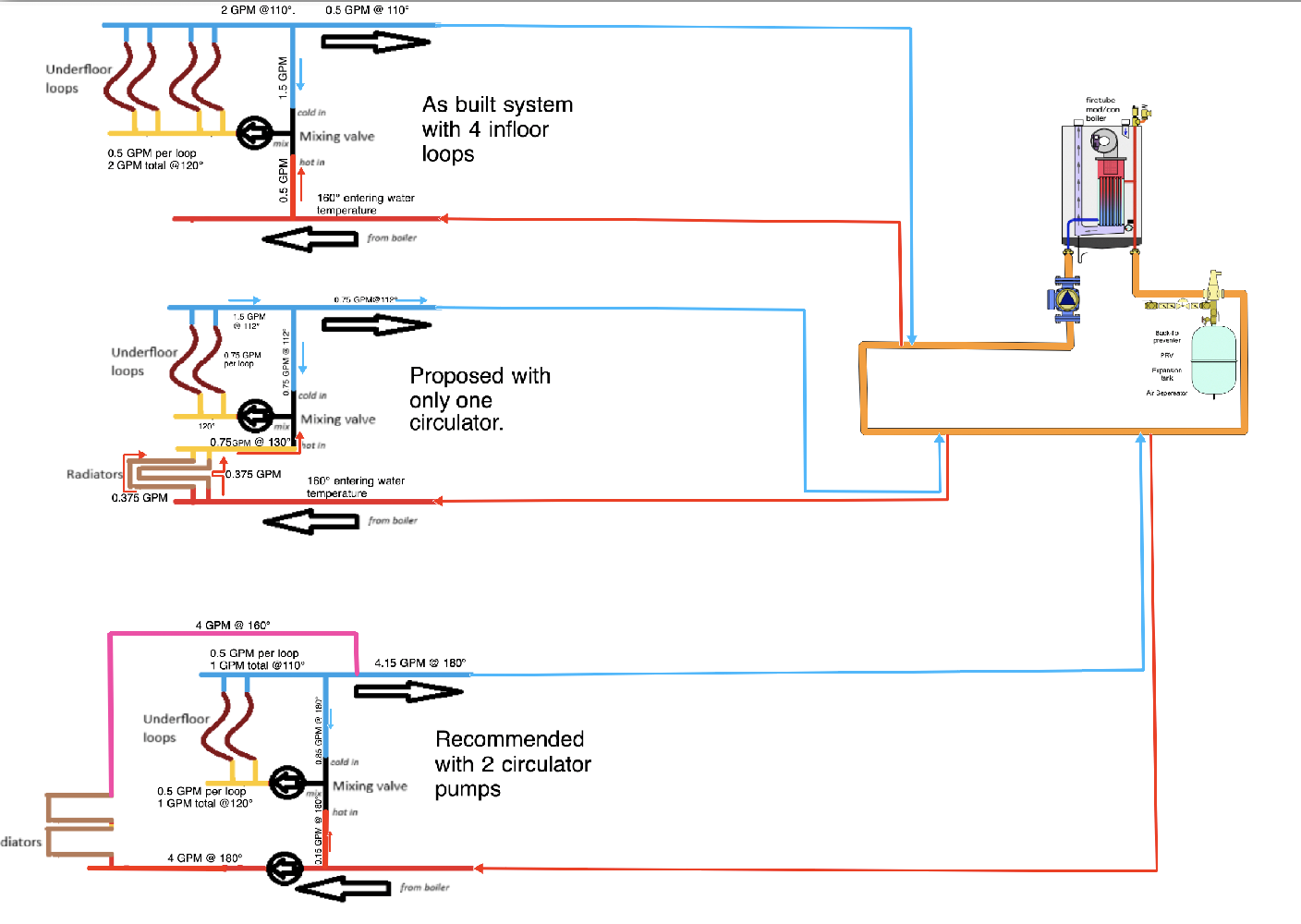

    So based on the fact that the boiler has ODR for the rest of the zones, all that is needed is to remove the mixing valve? Is this how you see it @DCContrarian
    And what water temperature would you select for a design day to operate two 8 ft sections of Baseboard radiators piped parallel to each other? Then what water temperature would you expect to enter the radiant floor tubing in this case?
    I still believe that you need two circulators to get it to work properly.

    @DCContrarian what is the difference between a tempering valve and a mixing valve?
  • DCContrarian
    DCContrarian Posts: 1,588
    Sure, what I mean is a non-thermostatic valve that just mixes the two sides in a constant proportion. So as the outdoor reset modulates the leaving water temperature the mixed water temperature changes proportionally. The goal is to be getting the benefit of outdoor reset at temperatures the underfloor can use.
  • is such a valve available at a reasonable cost @DCContrarian ? I know of a motorized valve from Taco that will take the already reset water for the higher temperature radiators and reduce it to a lower temperature reset for the floor heat. “ Resetting the reset”
    that valve plus the accompanying outdoor and pipe sensors and accessories will cost the OP over $800.00. Dollars plus whatever labor and markup might be included to make the project well past the $2000.00 mark (just guessing not an actual price quote). That is probably not an option in this case since the OP was trying to get it done using only one circulator.
    I believe my 2 circulator suggestion with an inexpensive tempering/mixing valve fits the bill here
    What do you think?
  • DCContrarian
    Maybe I've been misunderstanding all along, but when the OP talked about a mixing valve I assumed it was a thermostatic mixing valve.
    I think we're on the same wavelength, I'm talking about a simple valve where you set the balance of the flow and forget about it, something like this:
    https://www.supplyhouse.com/Bluefin-ASV050-1-2-Brass-Anti-Sweat-Valve-w-Nuts
    That's not exactly right but it was the quickest thing I could find. You could even just have a tee and balancing valves inline on the hot and cold supplies. The idea is that it's going to keep roughly the same proportions of hot and cold regardless of temperature — and roughly is good enough.
  • So you want to repurpose a toilet tank device for radiant floor heat. Is this a normal industry practice? This is the first time I'm ever hearing about it. Have you actual experience with this design? You should write a white paper on the proper way to make it work. I believe that there are not too many experienced professionals with this as part of their wheelhouse of design options. Perhaps you can get together with @ethicalpaul and make a video on the features and benefits of non thermostatic mixing valves on radiant floor design
  • DCContrarian
    In my post I said that's not the right piece, just the first one I could find.
    What would you rather? A thermostatic mixing valve with outdoor reset? So they can fight each other?
    While they look identical
    A mix valve has two inlets, one outlet
    A diverter has one inlet, two outlets
    They serve opposite functions, they can be thermostatic, motorized or manual
