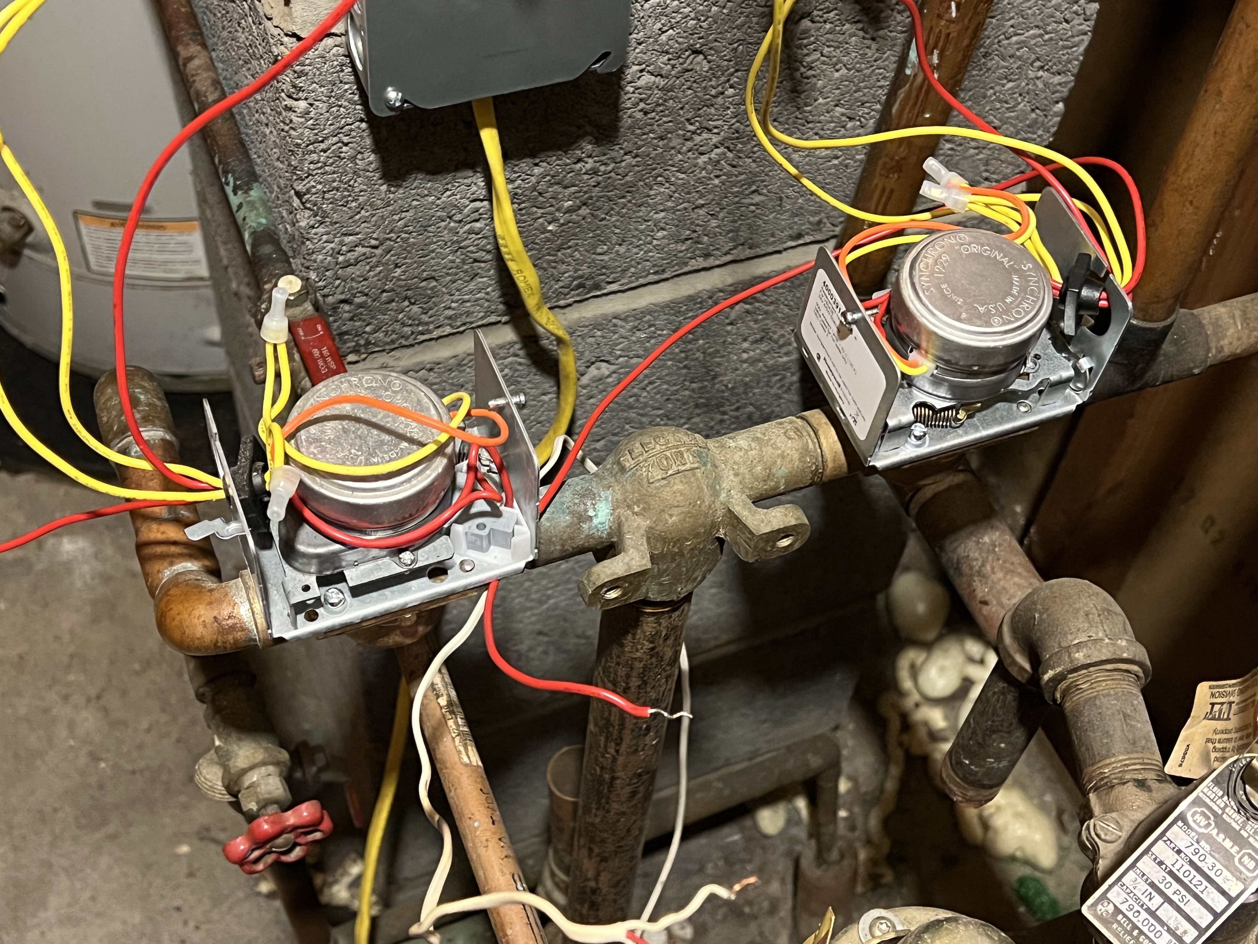

The zone valve 4 wires seem to control the motor and end switch separately.

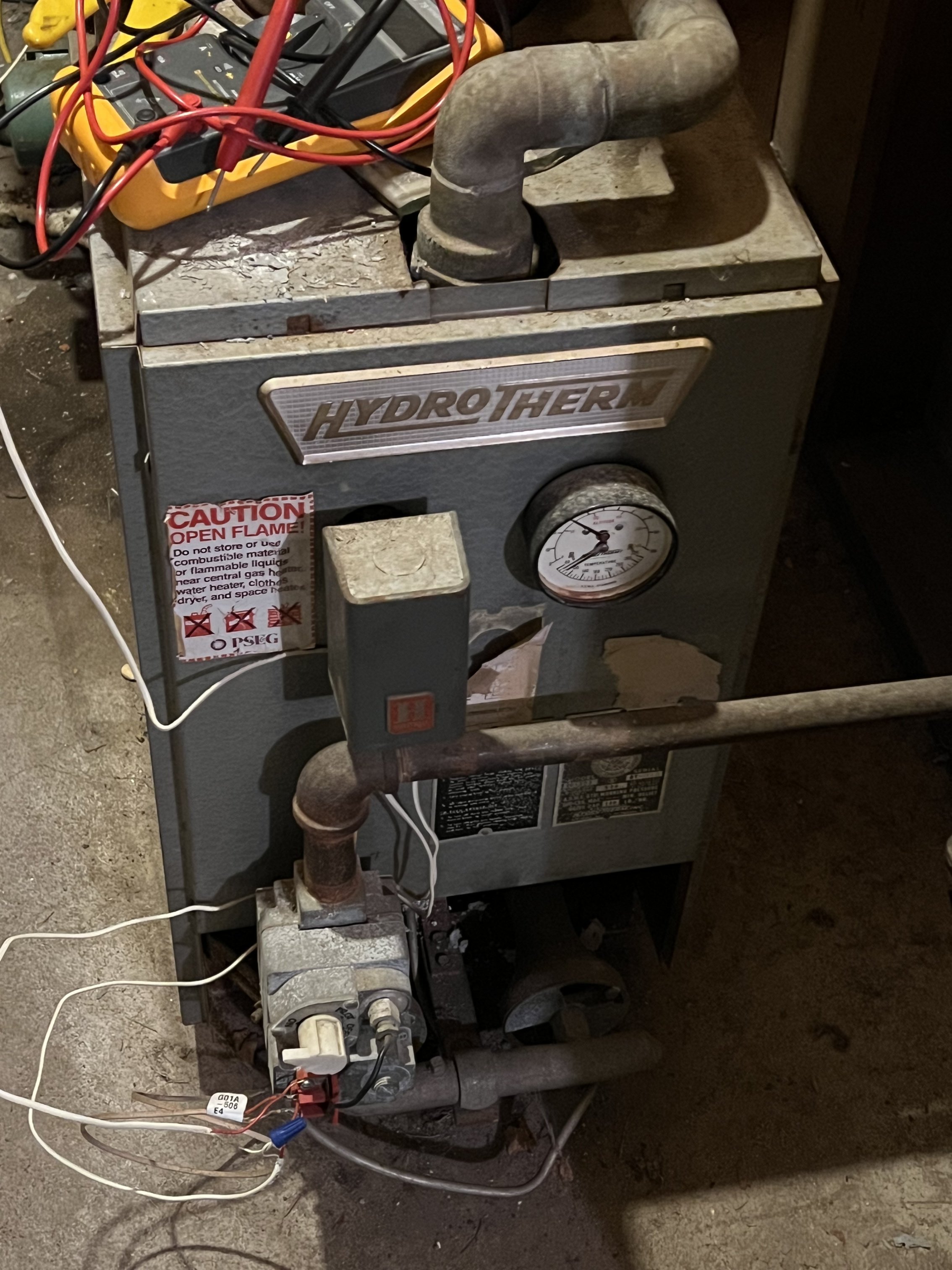

I seem to recall the gas valve (attached photo) may be a milli-volt control but I am not certain.

    X1,X2 should make and break the millivolt circuit to the gas valve.

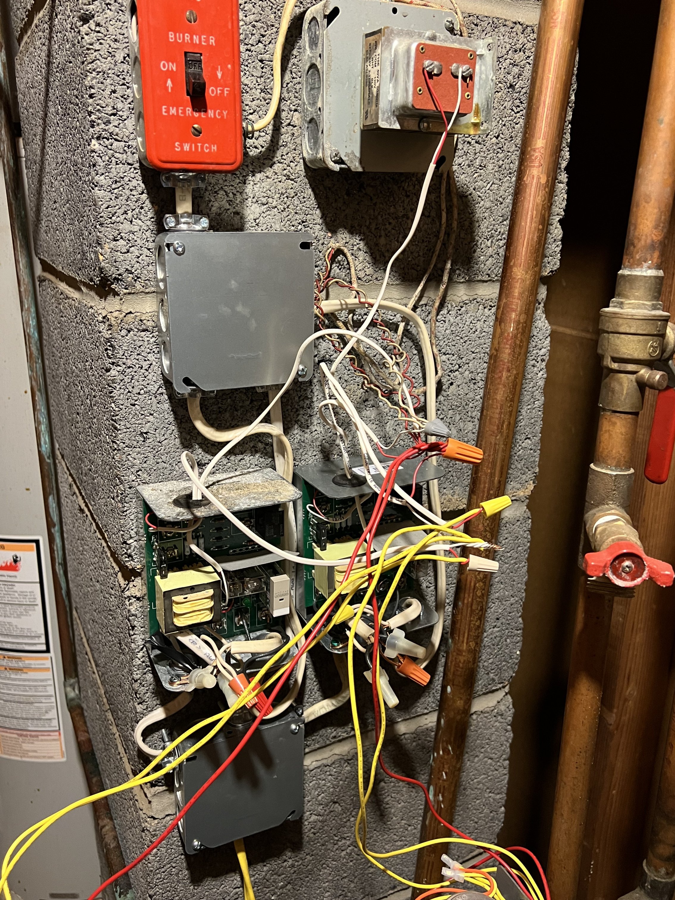

    Thanks for the feedback! Additional photos of remaining elements of the heating system below.
    It seems to me the A/B and X1/X2 terminals are simply a relay connecting a circuit to a relay controlled by the R8845U via. thermostat.
    For the zone valve motor I would think I connect transformer hot (red) to A, zone valve yellow (motor wire hot) to B, zone valve yellow wire (motor wire common) to transformer common (white)?
    If the gas valve is millivolt, what is the power source? Is there another transformer internal to the R8845U?

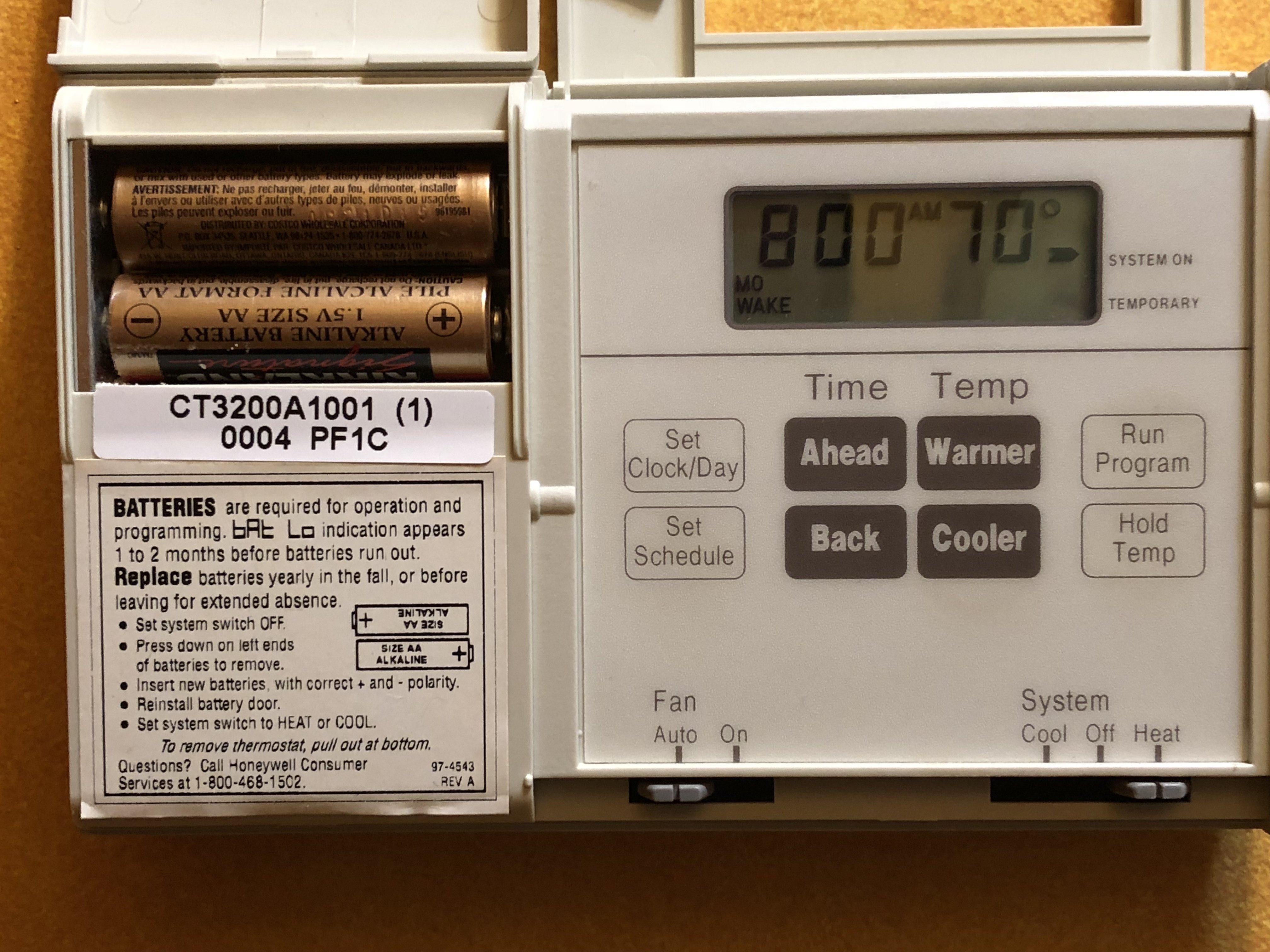

    The Honeywell thermostats (one for upstairs, one for downstairs).
    The main switch, 24V transformer, two R8845U units.
    The two Honeywell 40003916 zone valves.

    The furnace.

    The powerpile/milivolt gas valve system is its own power source — the power pile itself (sort of a takeoff on a thermocouple) generates a very small voltage proportional to its temperature — which is sufficient,, if it's warm enough — to open the gas valve. So… the powerpile is heated by the pilot flame, and when the circuit through the gas valve is closed the gas valve opens and the burner operates.
    No outside transformer needed!
    However. It's pretty weak. So any problems in the wiring — or the switch calling for heat — can defeat it.
    Therefore… use the X1 and X2 contacts, which are intended for very low voltage and very low current (there is a reason that Taco notes they are for powerpile/millivolt use!) rahter than A and B terminals which are intended for switching literally hundreds of times the voltage and current (120 volts at several amperes) of the X1 and X2. but which may have much too much resistance to switch the millivolt power.

    The yellow wires on the zone valve are the motor, they open the valve when they get 24vac.
    The red wires are the end switch on the zone valve. They are likely in parallel on the thermostat input of the circulator relay. The end switch closes the relay and the relay turns on the circulator and fires the boiler.

    Looks like you have a multimeter, good. It looks like there is 4 voltages in use with your system.
    3 VDC the thermostat batteries.
    The pilot generated millivolt system nominally about 0.750 Volts DC no load. Will be less under load of the gas valve.
    120 VAC, for the Circulator Pump and the primary side of the transformers used to produce the 24 VAC.
    24 VAC, thermostat control wiring and Zone Valves and parts of the R8845U relay.
    Basically when the thermostat(s) call for heat (contacts close) it should provide power to the Zone Valve motor. (the 24 VAC is provided by the transformer near the Red cover plate safety switch).
    When the zone valve motor fully opens the zone valve the zone valve's End Switch closes.
    The closed End Switch then activated the respective R8845U relay.
    The R8845U relays do two things, switches the circulator pump on and switches on the Gas Valve powered by the millivolt Powepile. They should be wired so either thermostat call for heat energizes the circulator and the boiler's burner (the Gas Valve).
    When the thermostat is satisfied and opens its switch everything releases.
    BTW you really only needed one R8845U relay. Since the Zone Valve End Switches could be paralleled to control one R8845U relay. Either way will work. The logical 'OR' that is needed (two zones and one boiler & circulator) can happen at either of two places on the input to one R8845U relay or the output of two R845U relays.

    Let's try again. You MUST use the X1/X2 terminals to control the gas valve on the boiler. That's a millivolt system, and must not be connected to anything else.

    I am now seeing why the chronic failures are probably happening.
    Looking closer at your existing wiring, I can see why there is some confusion. The way it is presently wired the operational sequence is wrong. It looks like the millivolt system part is controlled by the Zone Valve's End Switches (which they may not be rated for millivolt service) and the one side of the millivolt system looks like it is tied to the 24 VAC wiring (Red wires), which is kind of scary since if you apply 24 VAC to the millivolt Gas Valve it may permanently damage it.
    The way it should be, is with the isolated X1 / X2 relay contacts ONLY controlling the millivolt part of the system.
    This minimizes any parasitic resistance from excessive wire, connections, splices and inappropriate switching equipment in the millivolt part of the system. With a brief look at the specs of a same or similar Zone Valve, the Zone Valve's End switch does not appear to be rated for milivolt service.
    Also when the isolated X1 / X2 relay contacts ONLY are controlling the millivolt part of the system, Gas Valve damage from miss-wiring, unintentional application of a higher inappropriate voltage, etc. is now much harder for this type of accident to happen.

    After wiring up the 24V circuit as recommended the system is working. I had also forgotten to check the pilot which had gone out at some point. Either thermostat can again turn on the zone valve, pump, and furnace for the proper zone.
