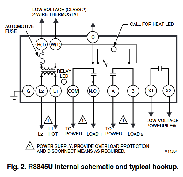

I’ve been maintaining my ancient Hydrotherm furnace ever since I bought my house. Every few years I research and get it working but it eventually fails. Last attempt I installed an R8845U to control the two Honeywell zone valves, the baseboard water pump, and the furnace (gas valve and furnace switch). This worked fine until only one of the thermostats would turn the system on.
I did a query on grok AI assistant) which insisted I need an R8845U for each of the two zones. I installed a second and wired up the 120V no problem. Each thermostat can control the baseboard pump correctly.
The 24V circuit is more confusing to me. Grok insists I use the A B terminals / relay in the R8845U (I had previously used the X1 X2 terminals / relay).
The zone valve 4 wires seem to control the motor and end switch separately.

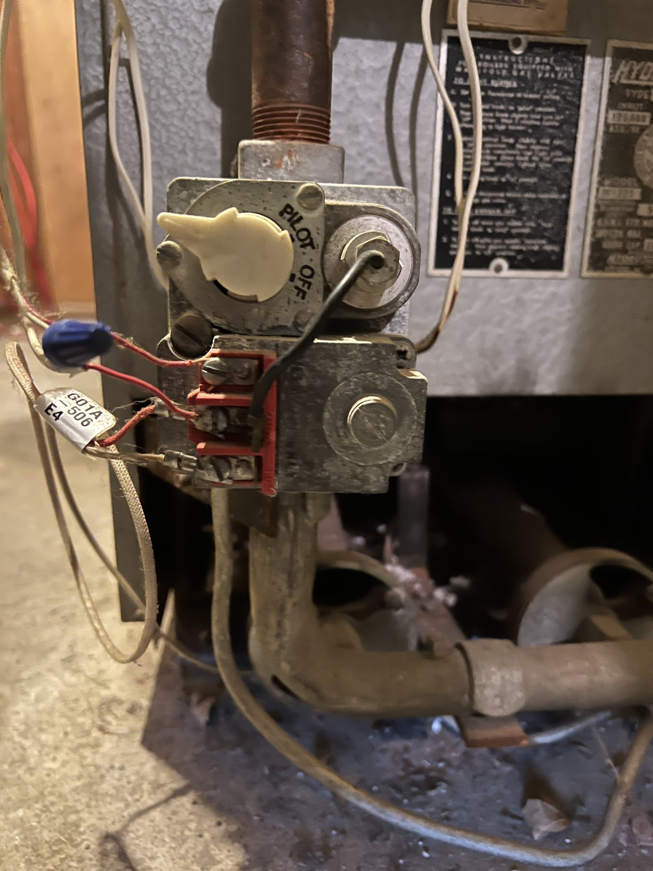

I seem to recall the gas valve (attached photo) may be a milli-volt control but I am not certain.
Any help is greatly appreciated!

    From your pictures it does look like a milivolt system as far as the electrical control at the gas valve. The rest, thermostats and relay units are probably 24 VAC which is powered by the 120 VAC building power.
    Millivolt systems are very sensitive to poor connections that create excessive voltage drop. So the wiring of the millivolt part should be set up to minimize unneeded connections.

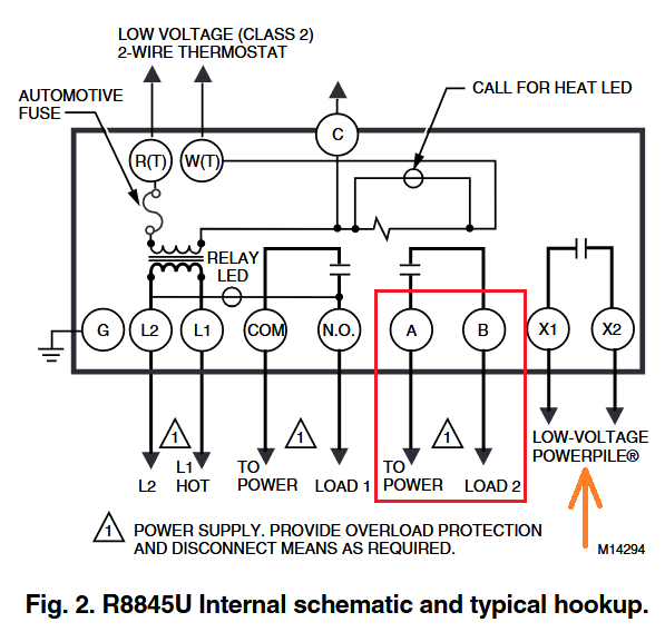

    It seems to me the A/B and X1/X2 terminals are simply a relay connecting a circuit to a relay controlled by the R8845U via. thermostat.
    For the zone valve motor I would think I connect transformer hot (red) to A, zone valve yellow (motor wire hot) to B, zone valve yellow wire (motor wire common) to transformer common (white)?
    If the gas valve is millivolt, what is the power source? Is there another transformer internal to the R8845U?

    The powerpile/milivolt gas valve system is its own power source — the power pile itself (sort of a takeoff on a thermocouple) generates a very small voltage proportional to its temperature — which is sufficient,, if it's warm enough — to open the gas valve. So… the powerpile is heated by the pilot flame, and when the circuit through the gas valve is closed the gas valve opens and the burner operates.
    No outside transformer needed!
    However. It's pretty weak. So any problems in the wiring — or the switch calling for heat — can defeat it.
    Therefore… use the X1 and X2 contacts, which are intended for very low voltage and very low current (there is a reason that Taco notes they are for powerpile/millivolt use!) rahter than A and B terminals which are intended for switching literally hundreds of times the voltage and current (120 volts at several amperes) of the X1 and X2. but which may have much too much resistance to switch the millivolt power.

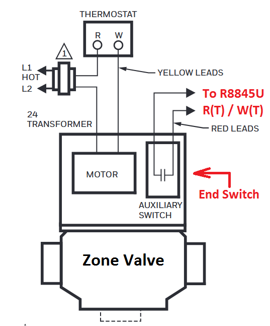

    The yellow wires on the zone valve are the motor, they open the valve when they get 24vac.
    The red wires are the end switch on the zone valve. They are likely in parallel on the thermostat input of the circulator relay. The end switch closes the relay and the relay turns on the circulator and fires the boiler.

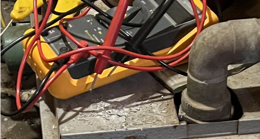

    Looks like you have a multimeter, good. It looks like there is 4 voltages in use with your system.

    Basically when the thermostat(s) call for heat (contacts close) it should provide power to the Zone Valve motor. (the 24 VAC is provided by the transformer near the Red cover plate safety switch).
    When the zone valve motor fully opens the zone valve the zone valve's End Switch closes.
    The closed End Switch then activated the respective R8845U relay.
    The R8845U relays do two things, switches the circulator pump on and switches on the Gas Valve powered by the millivolt Powepile. They should be wired so either thermostat call for heat energizes the circulator and the boiler's burner (the Gas Valve).
    When the thermostat is satisfied and opens its switch everything releases.
    BTW you really only needed one R8845U relay. Since the Zone Valve End Switches could be paralleled to control one R8845U relay. Either way will work. The logical 'OR' that is needed (two zones and one boiler & circulator) can happen at either of two places on the input to one R8845U relay or the output of two R845U relays.

    Let's try again. You MUST use the X1/X2 terminals to control the gas valve on the boiler. That's a millivolt system, and must not be connected to anything else.

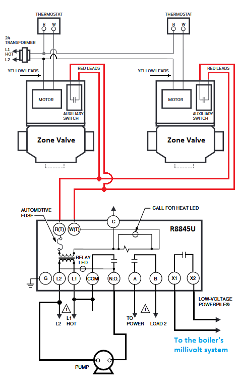

    The way it should work (with more detail and only one R8845U relay used). It is a series sequence of events, and it has a proper order with electrically isolated parts. For safety, functionality and proper logistics.
    When the thermostat(s) call for heat (contacts close R/W) it should provide power to the Zone Valve motor (Yellow wires). (the 24 VAC is provided by the transformer near the Red cover plate safety switch).
    When the Zone Valve motor fully opens the Zone Valve the Zone Valve's End Switch closes. This provides proof that the Zone Valve is open and water can flow. You don't want the boiler firing and the circulator running into closed Zone Valves.
    This proof of an open Zone Valve (one or more) by their End Switch closing (Red wires) is connected to the R8845U relay's R(T) / W(T) terminals. Since you have two thermostats and two Zone Valves typically the Red Zone Valve wires are connected in parallel to provide two paralleled switches connected to the R(T) / W(T) terminals of the R8845U relay. This allows either thermostat via the Zone Valve to trigger the R8845U relay.
    The R8845U relay contacts only turns on the Circulator pump (Load 1) and the burner X1 / X2.
    In your case there is no second load (Load 2), so the A / B terminals of the R8845U relay would not be used and should not be used. Load 1 is the circulator pump. X1 / X2 provides isolated control for the millivolt part of the system. Relay contacts depending on the application are made of different materials and alloys. I suspect (without looking at the data sheet) that the relay X1 / X2 is better suited for the low voltage (millivolt) applications. Plus it is physically isolated away from the high voltage part of the R8845U relay.

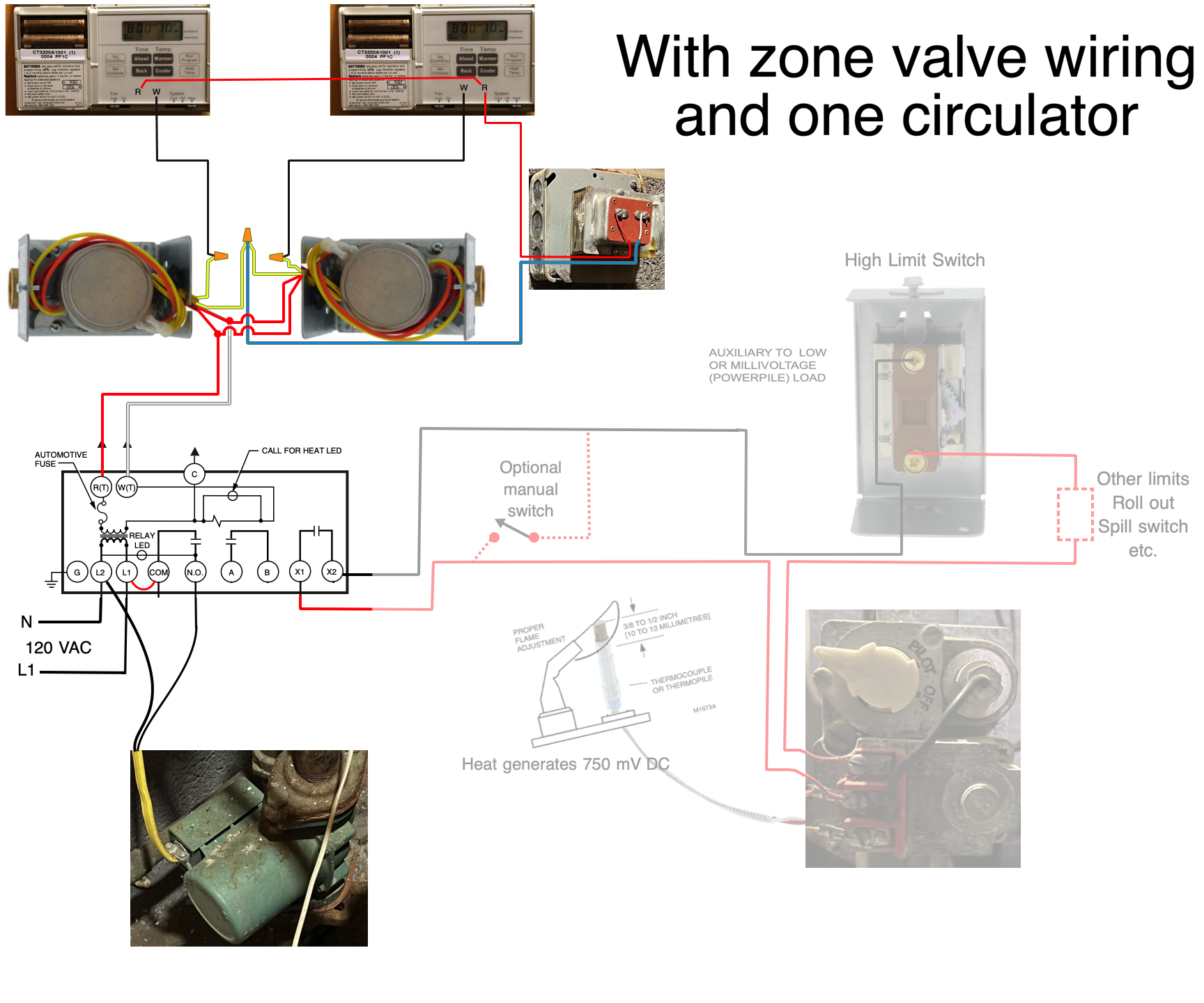

    109A_5 Posts: 4,759
    edited October 2025
    More of an overall wiring diagram using one R8845U relay.
    Think of this control order;
    Thermostat
    Zone Valve
    R8845U relay
    Gas Valve & Circulator

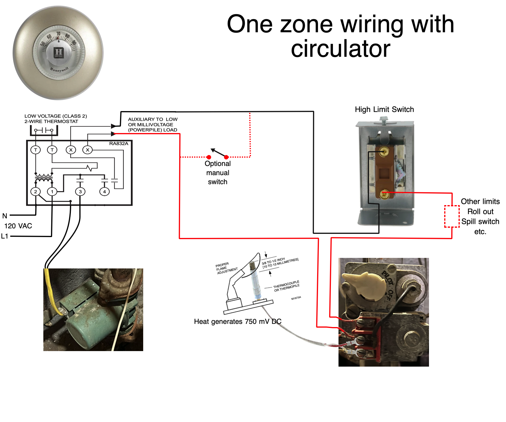

    I am now seeing why the chronic failures are probably happening.
    Looking closer at your existing wiring, I can see why there is some confusion. The way it is presently wired the operational sequence is wrong. It looks like the millivolt system part is controlled by the Zone Valve's End Switches (which they may not be rated for millivolt service) and the one side of the millivolt system looks like it is tied to the 24 VAC wiring (Red wires), which is kind of scary since if you apply 24 VAC to the millivolt Gas Valve it may permanently damage it.
    The way it should be, is with the isolated X1 / X2 relay contacts ONLY controlling the millivolt part of the system.
    This minimizes any parasitic resistance from excessive wire, connections, splices and inappropriate switching equipment in the millivolt part of the system. With a brief look at the specs of a same or similar Zone Valve, the Zone Valve's End switch does not appear to be rated for milivolt service.
    Also when the isolated X1 / X2 relay contacts ONLY are controlling the millivolt part of the system, Gas Valve damage from miss-wiring, unintentional application of a higher inappropriate voltage, etc. is now much harder for this type of accident to happen.

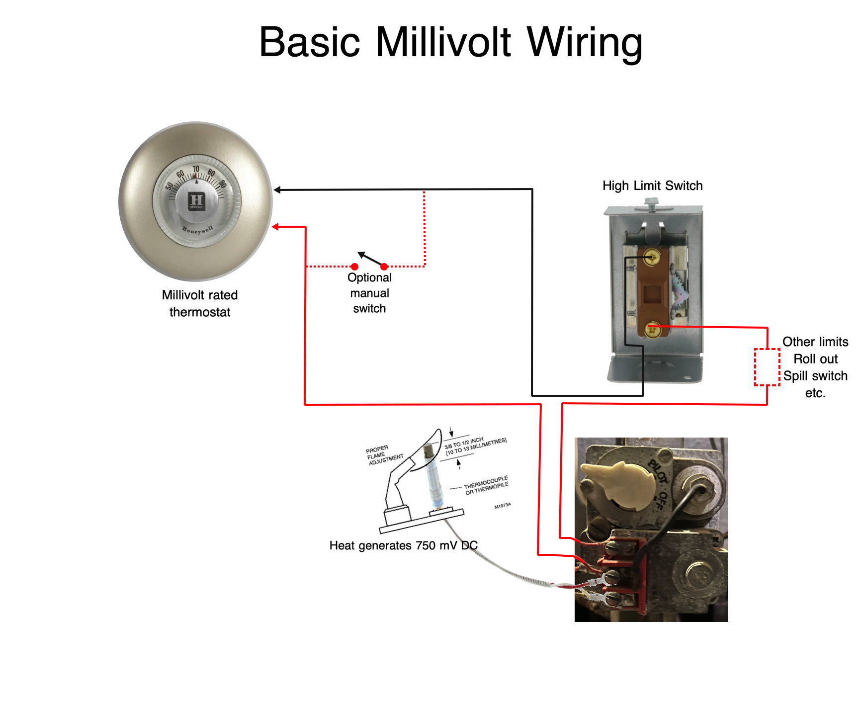

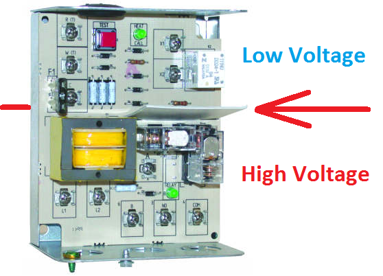

  • Looks like @109A_5 has found your chronic failure problem. The contacts that turn on the gas valve circuit MUST be rated for 750 mV power. Here is a basic circuit that your boiler (not a furnace that sends hot air thru the ductwork) came with from the factory.
    If there was only one thermostat for the entire home, the thermostat would be rated for 750 mV like the Honeywell T86A pictured in the diagram. If that is the original high limit control that should also have mV rated contacts.
    In this set up you could connect this boiler to a gravity radiator system and in the event of a power failure you can still have heat. the 750 mV is generated by the pilot flame touching the Powerpile pilot generator. No other electric source is in the diagram.
    If your boiler was equipped with a circulator from the factory there would have been a switching relay similar to the Honeywell RA832A. There are several contacts on this type of relay but the most important set of contacts are the ones connected to the X X terminals. Those contacts are rated for 750 mV. This is very similar to the R8845U relay that you are now using.
    If you try to use other contacts that are rated for up to 240 Volts AC, you may find that those contacts prove to cause problems with Millivolt circuits because there may be some resistance to the flow of electricity that 24 V., 120v., and higher will overcome with no problem. The 750 mV current may not always make contact and leave you without the gas valve operating as expected. There is one benefit to this design, if you loose power, you can turn on the manual switch on the back of the boiler and get the gas burner to fire. this will cause thermosyphoning, commonly known as gravity heat, to circulate. This may not be as much heat as the circulator pump will move, but it will protect your home from freezing up and having burst pipes.

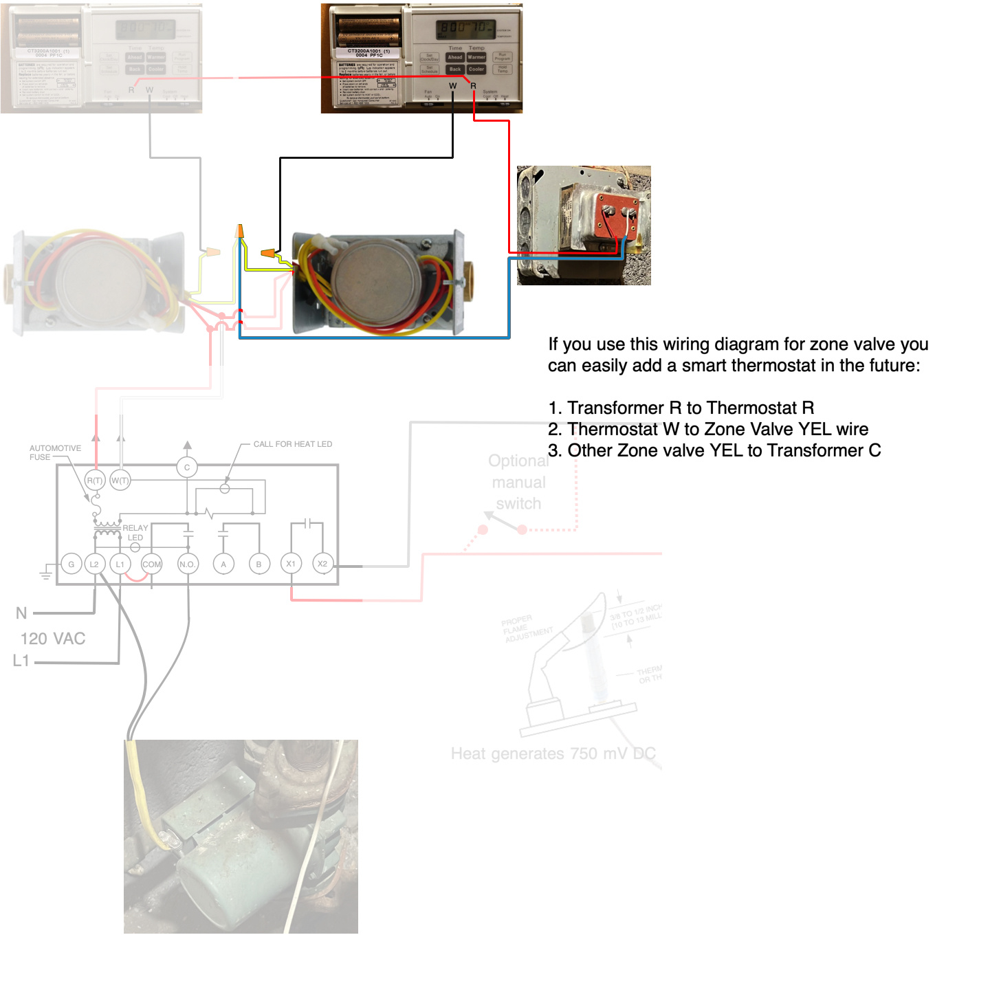

    The next diagram illustrates how YOU should rewire your system to avoid the problems associated with millivolt gas valve and zone valve end switches that may not be rated for 750 mV.
    You can clearly see the 24 VAC transformer connected to the zone valve circuit. Do not use the thermostats to operate separate R8845U relays. You want the thermostats to control the zone valves as the manufacturer of the zone valve intended. Those thermostats will operate the zone valves and the zone valve end switches will operate the one R8845U relay that has the ability to power the circulator and the X X terminals to control the mV gas valve. If you do the zone valve wiring this way, you can still use the gravity heat in a power outage by manually opening the zone valves and set the manual switch on the rear of the boiler to MAN.
    To make it easier to follow, I have faded the wiring that you already understand from the previous two diagrams.
    In order to make the Zone valve wiring a little more simple I will do the same fade out to isolate each circuit here?
    If you follow this wiring diagram for all zone valves then you can add a smart thermostat that requires a C terminal in the future with no problem:
    1. Transformer R to Thermostat R
    2. Thermostat W to Yellow wire on the zone valve
    3. The other Yellow wire on the zone valve to C on the transformer
    Follow the same wiring on all other zone valves.

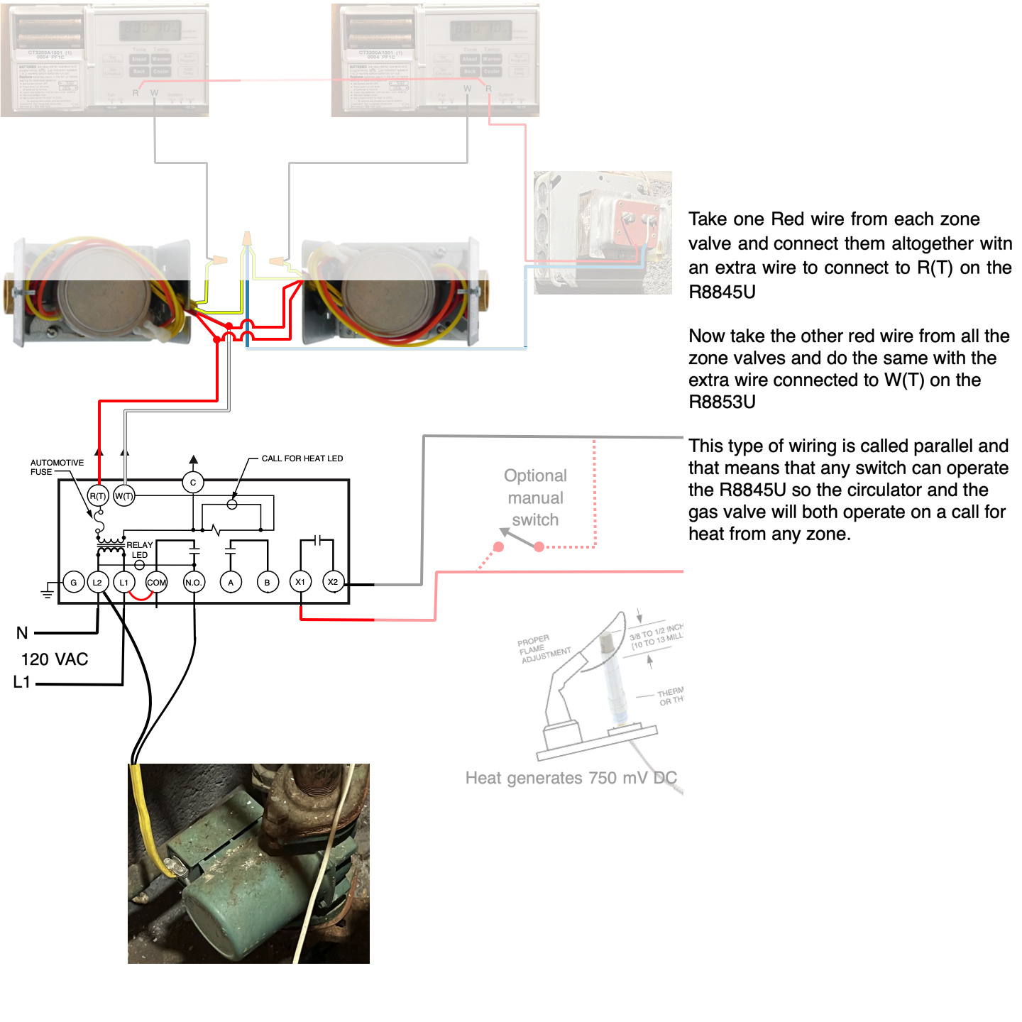

    When the power side of the zone valves are done and operating and tested. you can move on the the end switch side of the zone valve.
    Take one Red wire from each zone valve and connect them altogether with an extra wire to connect to R(T1) on the R8845U
    Now take the other red wire from all the zone valves and do the same with the extra wire connected to W(T2) on the R8853U
    This type of wiring is called parallel and that means that any switch can operate the R8845U so the circulator and the gas valve will both operate on a call for heat from any zone.
    Since I have on way to know how well versed you are in electrical circuitry I took the time to build each section of the boiler system you have one step at a time. I hope this helps you to understand your system better.
    Mr. Ed
    Any Questions?
