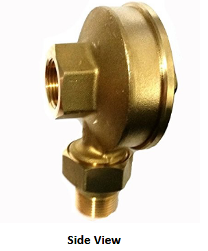

    More venting for the money with the Gorton #2. Have you calculated your venting needs (length and pipe size of the mains)?

    right now…i have a Hoffman 75 at the end of the main (in basement)…..really dont feel like drilling into pipes to add another main…any other suggestion…the Hoffman 75 has not been changed for about 7 years.

    Again, what are the main pipe sizes and lengths. From that we can determine how much venting is needed. Is the current Hoffman vent working? Unless it is seeing very high pressures or getting water thrown up into it the valve should last well past 7 years.
    With no other information and if you are willing to spend $180 on a Hoffman 75 I would just spend $145 on a Gorton #2, get more than double the venting but you would need to add a reducer since the #2 has 1/2" threads whereas the Hoffman had 3/4".

    The main vent, closes when steam gets to it and vents air at the rate of the orifice size. With over 90' of main, you may benefit from faster main venting. So 90' of main between the boiler and the first radiator run-out ?
    looks like there is enough room for multiple main vents. Steam can be detected with a mirror or a chrome tool or knife held up to the orifice. The flow rate is a bit harder, you need a flow gauge adapted to it, maybe you can hear the air leaving.

    Assuming again that you have 2.5" mains (you really need to verify) with ~3cf of air to eliminate (not including the volume in the return which also needs to be vented given your main vent location) I would add at least a Gorton #2 to the Hoffman 75 you already have on that long main. Two Gorton #2's would be better. It should be easy to construct an antler to put multiple vents where that #75 now is at and they could be raised a bit higher above the pipe as well. As @109A_5 said you can monitor a cycle, listen for air being released from the vent and wait for the steam to get to the vent (it will get too hot to touch) and then verify that it is not releasing steam. If it does release steam it is failed/stuck open. If you can't tell whether it is releasing air or don't notice any changes in sound when steam gets to the vent I would take it off and try blowing through the bottom with it upright to make sure it is not stuck closed.

    Hoffman products are very high quality, as are Gorton. The greater air expulsion rate of the Gorton #2, which is in the same price range and close in height, make it the better choice in most cases. Mad Dog
