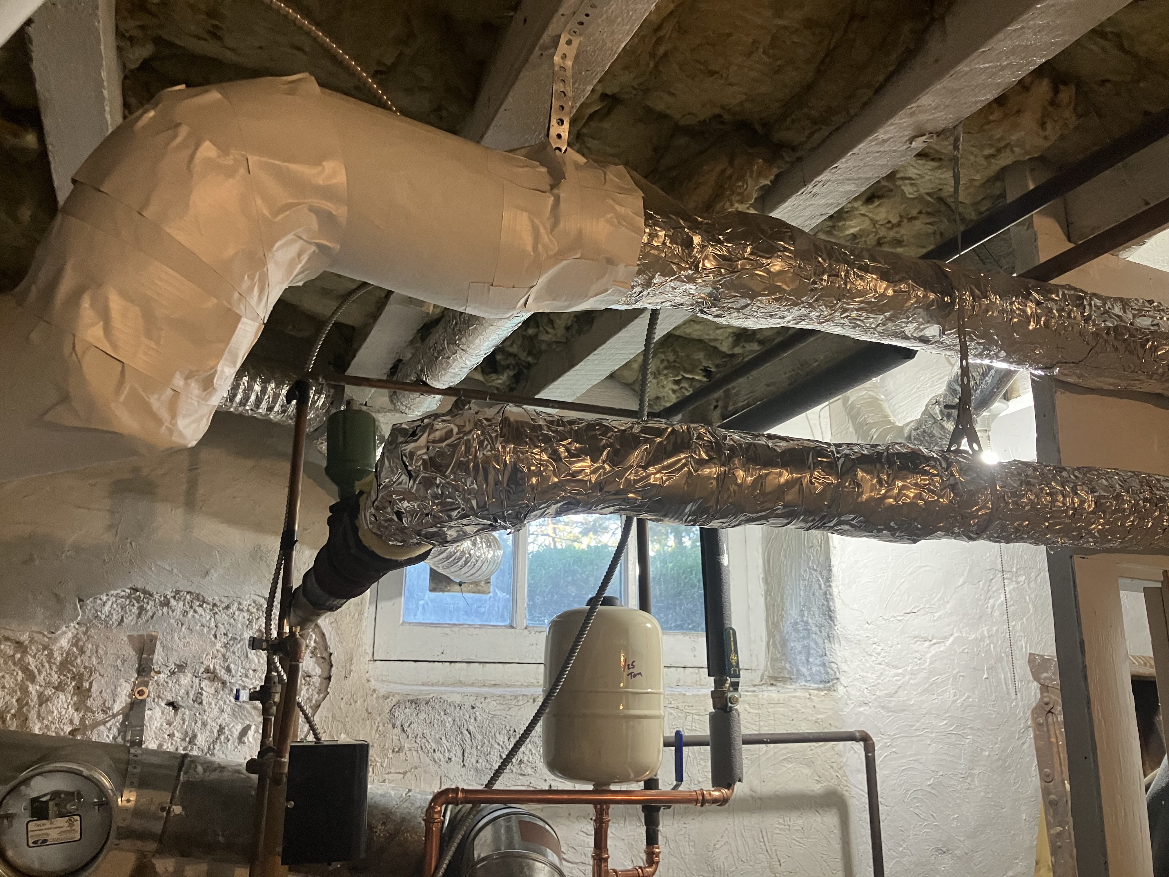

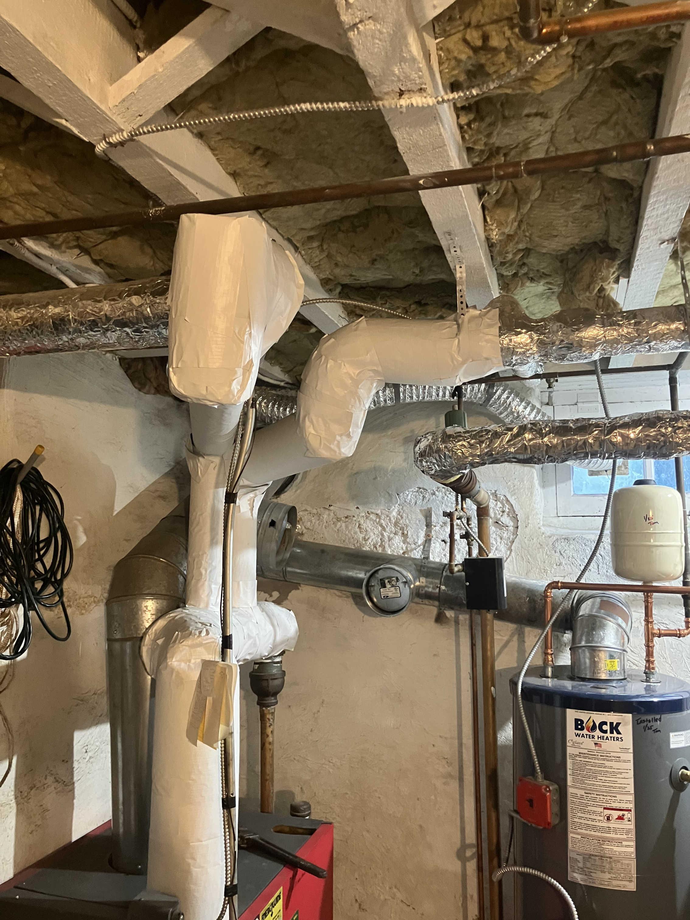

    See photos…so from the boiler…one main ( that is the piping on the far left) goes off and feeds 18 radiators ( 6 on first floor, 7 on 2nd floor and 5 on third floor) and there is 90' of main in the basement before branching off to these radiators. .. the other main (piping in the middle) is about 7'…and it branches off to 3 radiators— one on each floor…no return on the main. now, the piping at the bottom right…is the retun for the main that feeds the 18 radiators and you will see the "green " hoffman". overall the system heats pretty well, but some radiators not getting as warm as expected and some water …all radiators have new vents and all pitched. didnt know if changing the main vent would do anything….and how would i tell if that main vent is working properly? thanks
    109A_5 Posts: 4,759
    edited September 2025
    The main vent, closes when steam gets to it and vents air at the rate of the orifice size. With over 90' of main, you may benefit from faster main venting. So 90' of main between the boiler and the first radiator run-out ?
    looks like there is enough room for multiple main vents. Steam can be detected with a mirror or a chrome tool or knife held up to the orifice. The flow rate is a bit harder, you need a flow gauge adapted to it, maybe you can hear the air leaving.
    " i am getting some water in the radiator valves " Still a bit unclear on this, how do you detect water in the radiator valves ? What kind (brand) of radiator vents are on those radiators ?
    " the other main (piping in the middle) is about 7' " Maybe a counter-flow main and needs to be pitched toward the boiler, if it has no other means of condensate return.

    Assuming again that you have 2.5" mains (you really need to verify) with ~3cf of air to eliminate (not including the volume in the return which also needs to be vented given your main vent location) I would add at least a Gorton #2 to the Hoffman 75 you already have on that long main. Two Gorton #2's would be better. It should be easy to construct an antler to put multiple vents where that #75 now is at and they could be raised a bit higher above the pipe as well. As @109A_5 said you can monitor a cycle, listen for air being released from the vent and wait for the steam to get to the vent (it will get too hot to touch) and then verify that it is not releasing steam. If it does release steam it is failed/stuck open. If you can't tell whether it is releasing air or don't notice any changes in sound when steam gets to the vent I would take it off and try blowing through the bottom with it upright to make sure it is not stuck closed.
    So is there any main vent on the short 7" main or is it being vented entirely through the radiators? Are any of these radiators off the short main getting water in them? Which radiators are getting water? Do the radiators off one of the mains start heating noticeably faster than off the other?

    regarding your question if there is any main vent on the 7' main run …no just the vents on the radiators for those 3…no return just the main branching off to the 3 radiators. Yes..those 3 radiators are the ones that get water and are slower in heating.

    that main does have a pitch before it goes into the wall leading to the other floors and there is no play in riser pipe..all radiators do pitch also back to riser. since that 7' main does not have any return nor any main vents…i guess changing the hoffman 75 main vent for the "other main" wont do anything…any suggestions for that short run?
    109A_5 Posts: 4,759
    " that main does have a pitch before it goes into the wall leading to the other floors "
    Pitched which way ? It need to drain towards the boiler, this appears to be a counter-flow main, steam goes in one direction the condensate goes in the other.
    Your other (longer) main is a parallel flow main the steam and the condensate both go in the same direction.
    At this point venting the long main faster may make the heating of the short main worse depending on the actual problem.
    If steam has to push its way through a main that is pitched the wrong way and trapping condensate that restricts the steam flow.
    You could add a main vent at the riser end of the short main or at the top of the riser.
    You want the mains to vent as fast as possible yet balanced also, so the house heats evenly.
