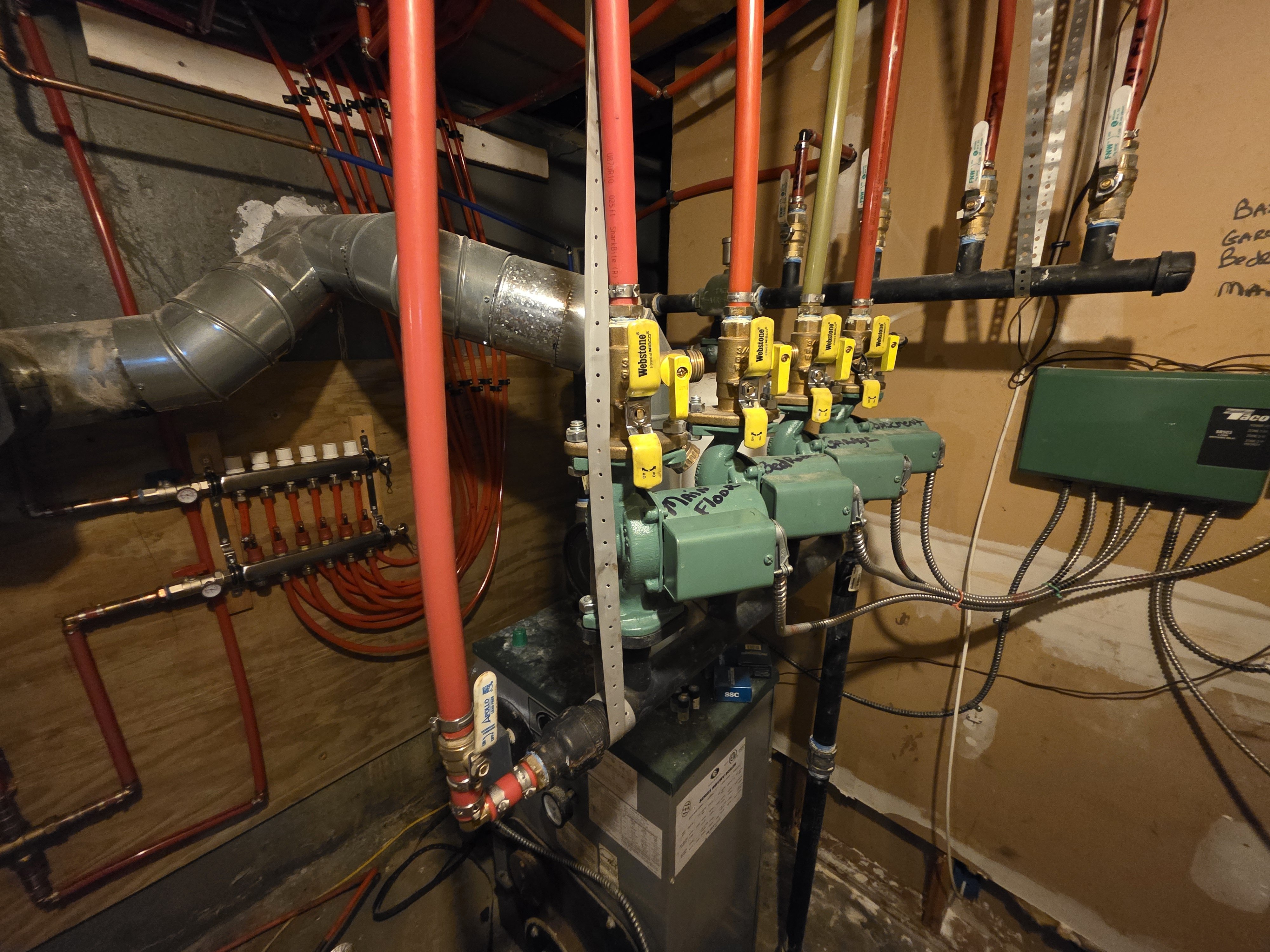

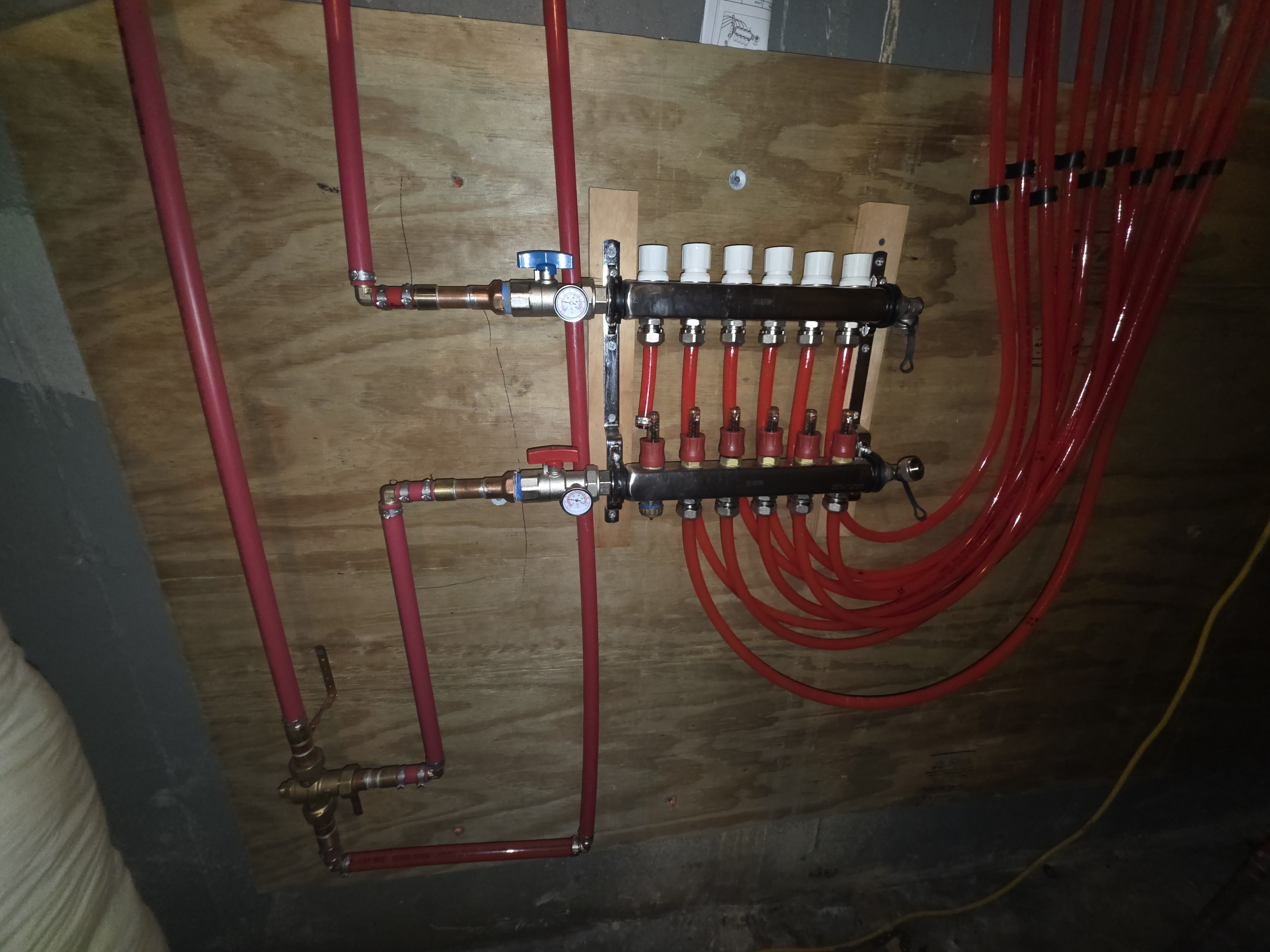

This past winter was doing reno in main part of the house including kitchen/lr/dr/den all one level ranch. Decided to run radiant heating 1/2" pex tubing, 5 loops all approximately 200 feet each loop.
Connection to boiler was completed and we had heated floors but not all the way through. I have a fireplace insert so was able to supplement the heating by burning wood until Spring 2025.

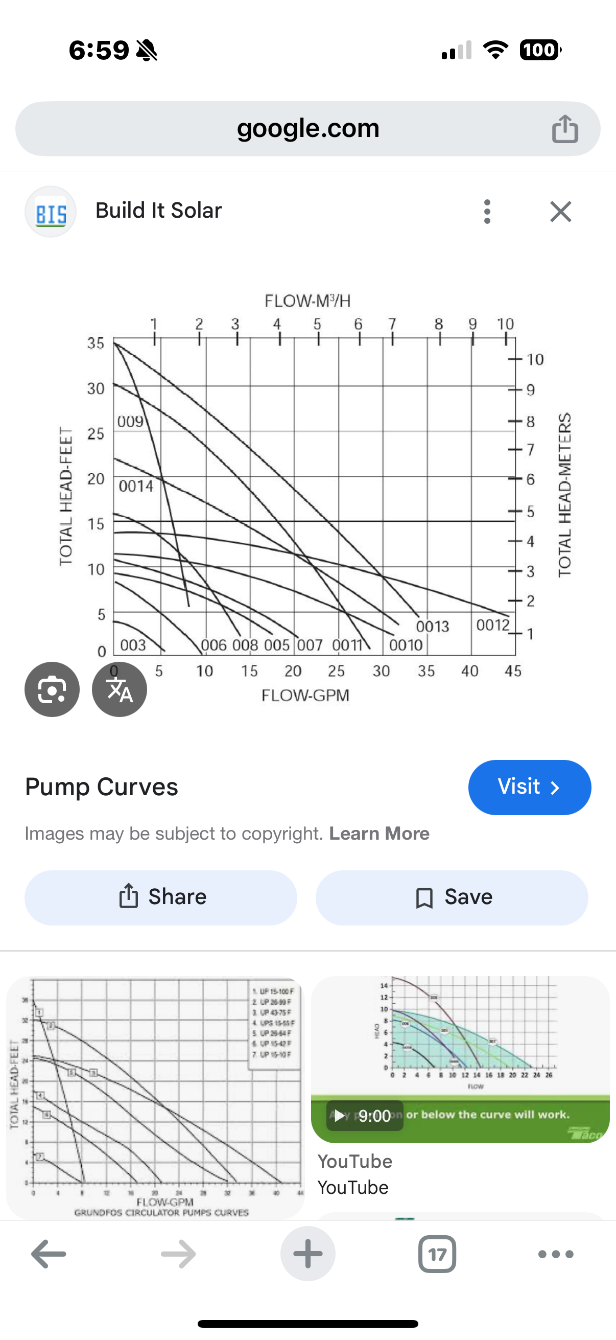

Fast forward to today, Winter is coming and I was thinking of upgrading the circulation pump that runs that zone to push more water through the loops.
I post pictures of my setup. Running a manifold off the boiler with 4 zones total. Rest of house is baseboard heating. Hot water is separate oilfield burner.

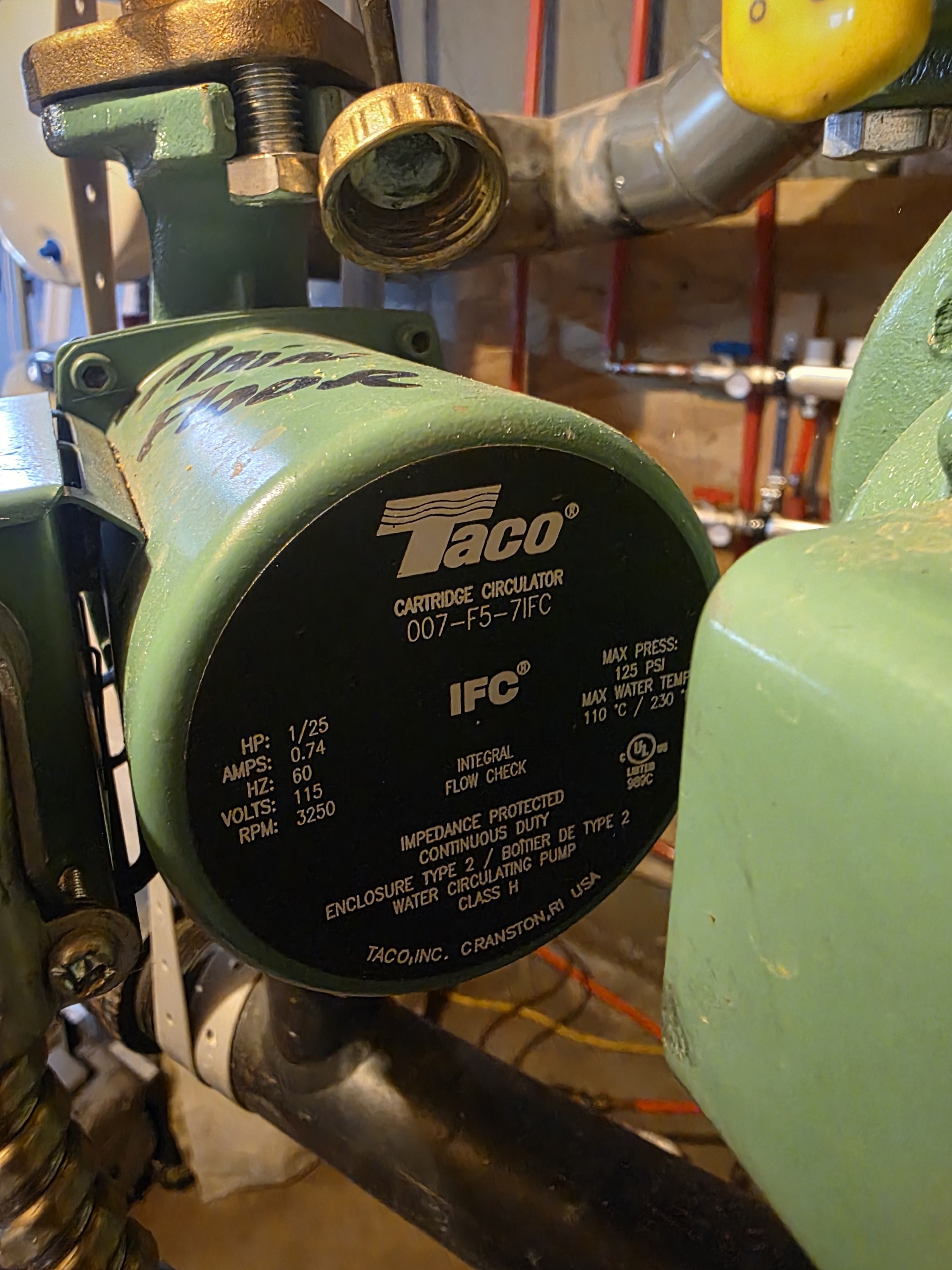

Current circulators are Taco 007 1/25 HP
1/2 pex is set in 2.5" of mud with tile on top
4 zones total. 1 of the zones going to radiant manifold.
Also have taco mixing value 86⁰ to 175⁰
Wanted to install Taco 009 1/8 HP.
How does that sound or will I blow my system up?
Thank you for your expertise in advance.

    I'm not sure your circulator is in the right place in relation to the thermostatic mixing valve(in fact i think it isn't but i'm not an expert on that).

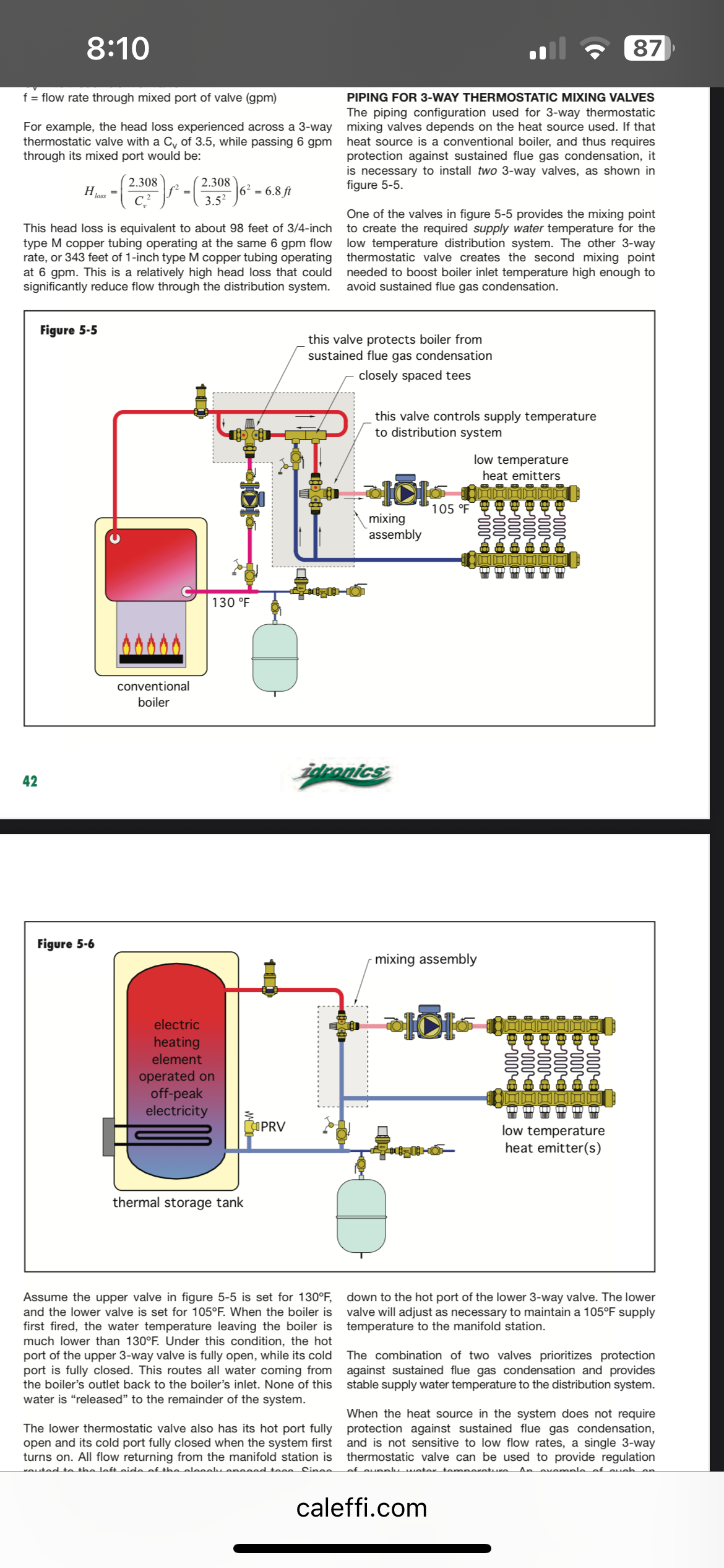

    hot_rod Member Posts: 27,209
    pump away from the mix port on the valve
    the return from the manifold also needs to go back to the boiler
    if you have a cast iron boiler you may need return temperature protection also

    Alan (California Radiant) Forbes Member Posts: 4,675
    edited September 2025
    Yes, with your pump getting very hot, it might be fried. Check the amp draw when it’s running. It should be .71-.76 amps. If it’s different, replace it with it relocated properly.
    But don’t use a Taco 009. As you can see by the 009 performance curve, you won’t get any more GPM; you’ll get less if the pumping head is over 8'.
    I suppose it depends on the design of the valve, not all valves shut off the hot port 100%. ASSE listed scald protection valves can shut off the hot 100%.
    You should pipe up a few demos and report back :)
    Regardless, this is how most if not all three way thermostatic manufacturers require a 3 way thermostatic to be piped, for hydronic mixing use. Piped this way it will work, piped in any other configuration you may not always get the results you expect.

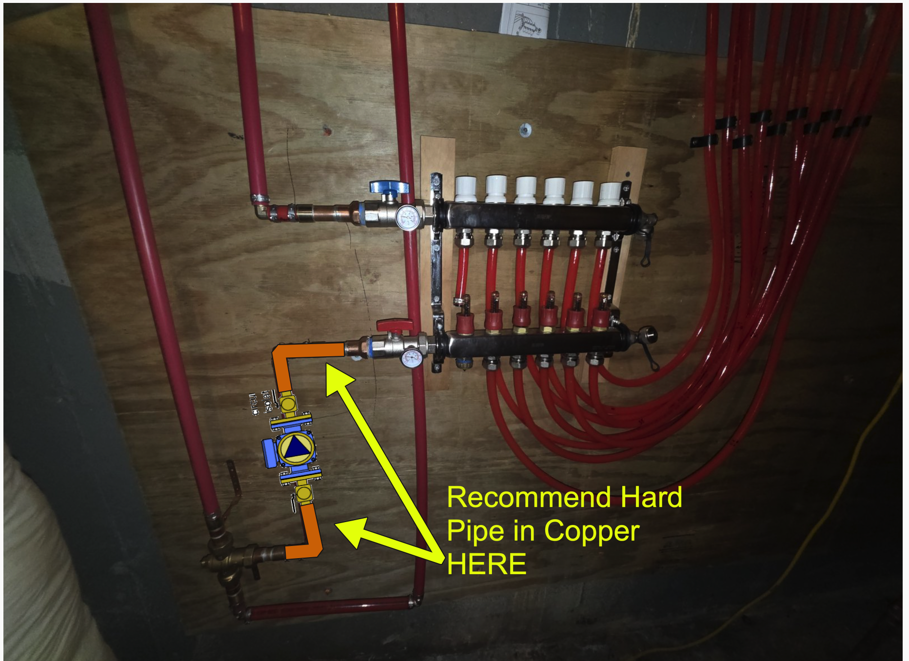

    EdTheHeaterMan Member Posts: 11,927
    Where is the circulator for the Radiant floor zone located? It should be here (see Photo)
    You may not need the circulator on the boiler side of the mixing valve as indicated by @hot_rod

    beatbox82 Member Posts: 13
    @EdTheHeaterMan
    In my first and only build sp far, we left the circulator where it was on the manifold just in front of the return manifold of the boiler. its labeled main in photos.
    Thank you for your input on my situation.

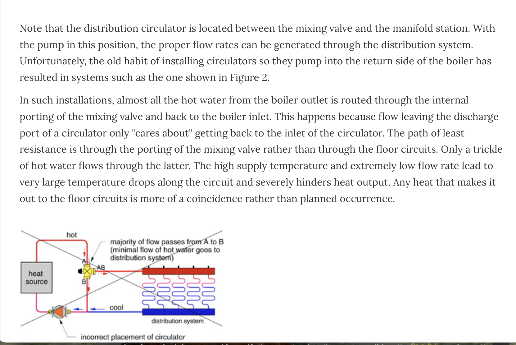

    I see that circulator in your photo. This diagram is how your system might me piped:
    You can see there is not a lot of pressure drop across the mixing valve when the MAIN pump is operating because is pulling equally on the cold inlet of the mixing valve and the return from the radiant floor loops. There is nothing to move the water into the cold side of the mixing valve, so all you get is what might pass thru the mix valve top the radiant loop and the rest of the flow may even go in the opposite direction on the mixing valve cold inlet port.

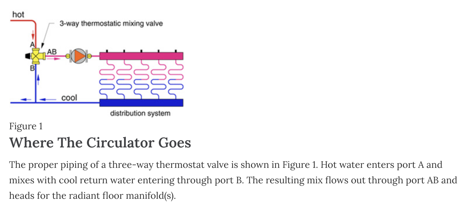

    This next illustration indicates the circulator in the proper location.
    The pump will pull water from both the hot and the cold ports to get the proper water temperature and move it thru the radiant floor tubes. I have also learned that you do not need the circulator pump where you actually have it located. That is because the mixing valve will pull the water from the boiler as needed to maintain the "MIX" temperature you set it for. If it needs more or less hot water that valve will compensate automatically.

    (UPDATE) so the Winter is here. My brother helped me move the circulator pump just after the mixing value which was prescribed by the majority of responses. The floor is getting the necessary hot water to warm up the zone. I had to change the taco pump aswell. The old pump was pulling hot water through the manifold but didn't have the power to push all the loops, all the way through and back to the cold side of the manifold. The pump possibly got burnt up on the old setup before moving it. I now have 120⁰ going out and approximately 90⁰ coming back.
