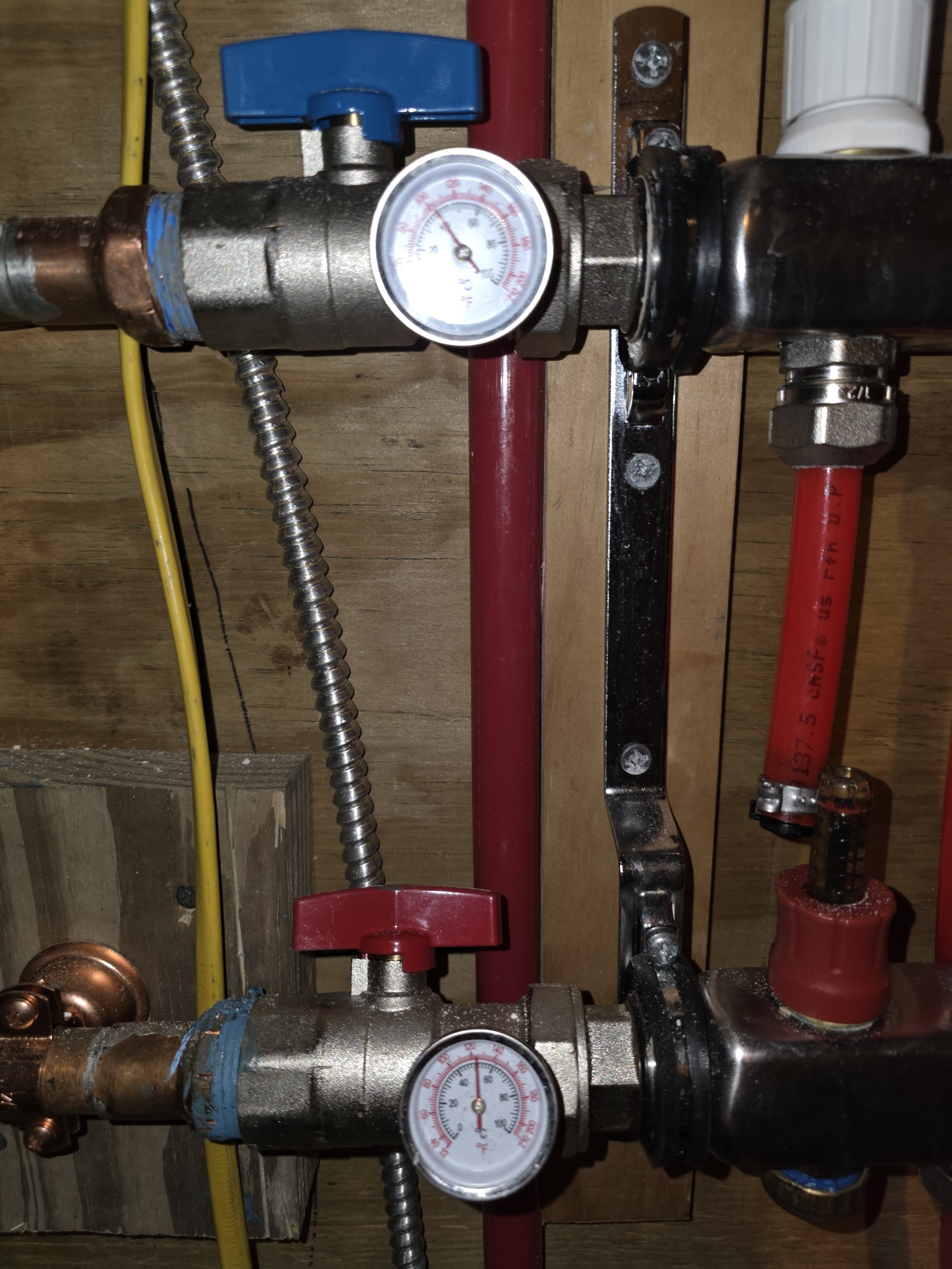

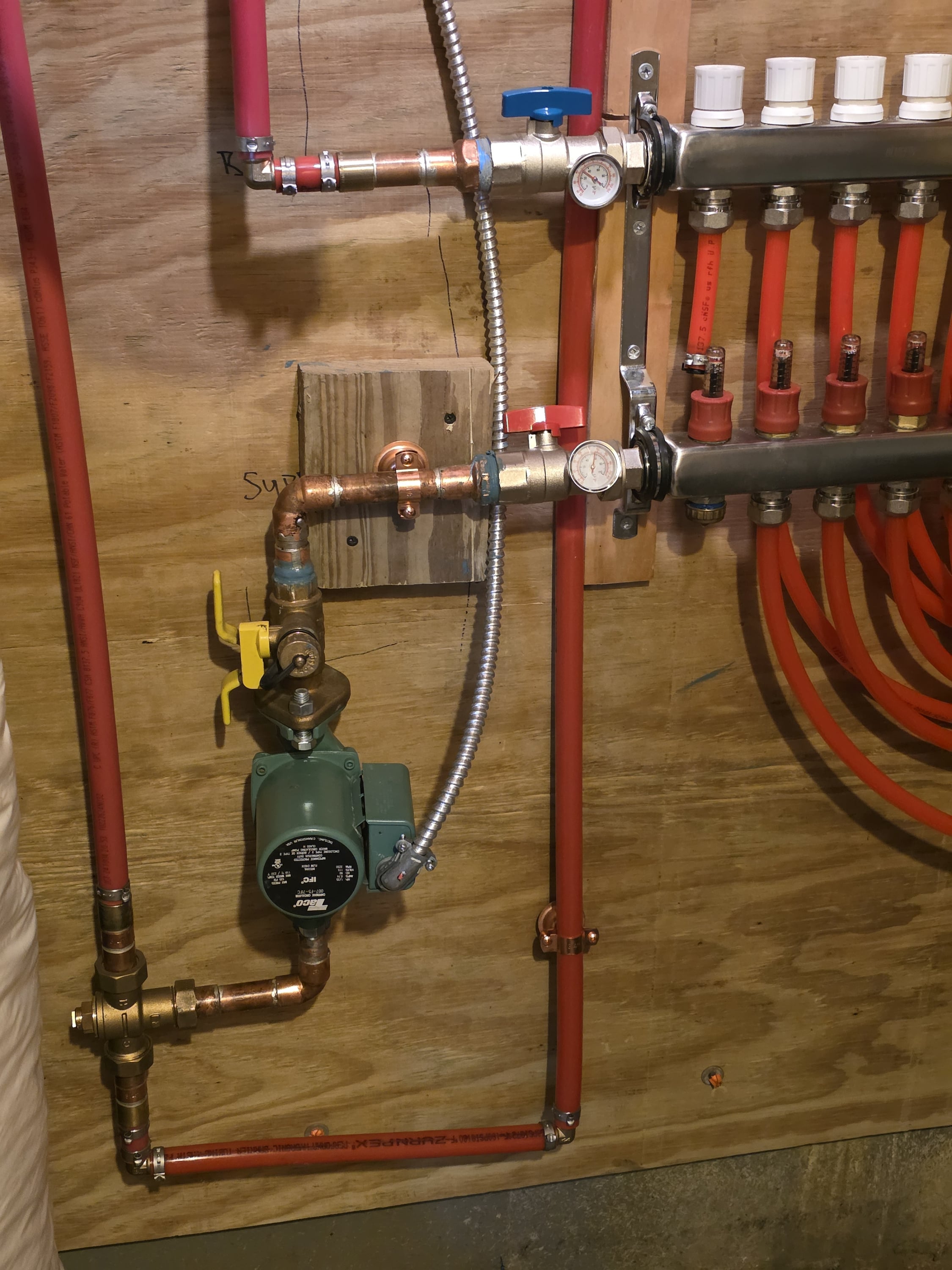

I post pictures of my setup. Running a manifold off the boiler with 4 zones total. Rest of house is baseboard heating. Hot water is separate oilfield burner.
Current circulators are Taco 007 1/25 HP
1/2 pex is set in 2.5" of mud with tile on top
4 zones total. 1 of the zones going to radiant manifold.
Also have taco mixing value 86⁰ to 175⁰
Wanted to install Taco 009 1/8 HP.
How does that sound or will I blow my system up?

    In my first and only build sp far, we left the circulator where it was on the manifold just in front of the return manifold of the boiler. its labeled main in photos.

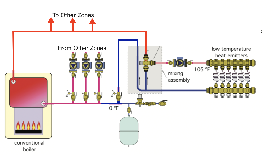

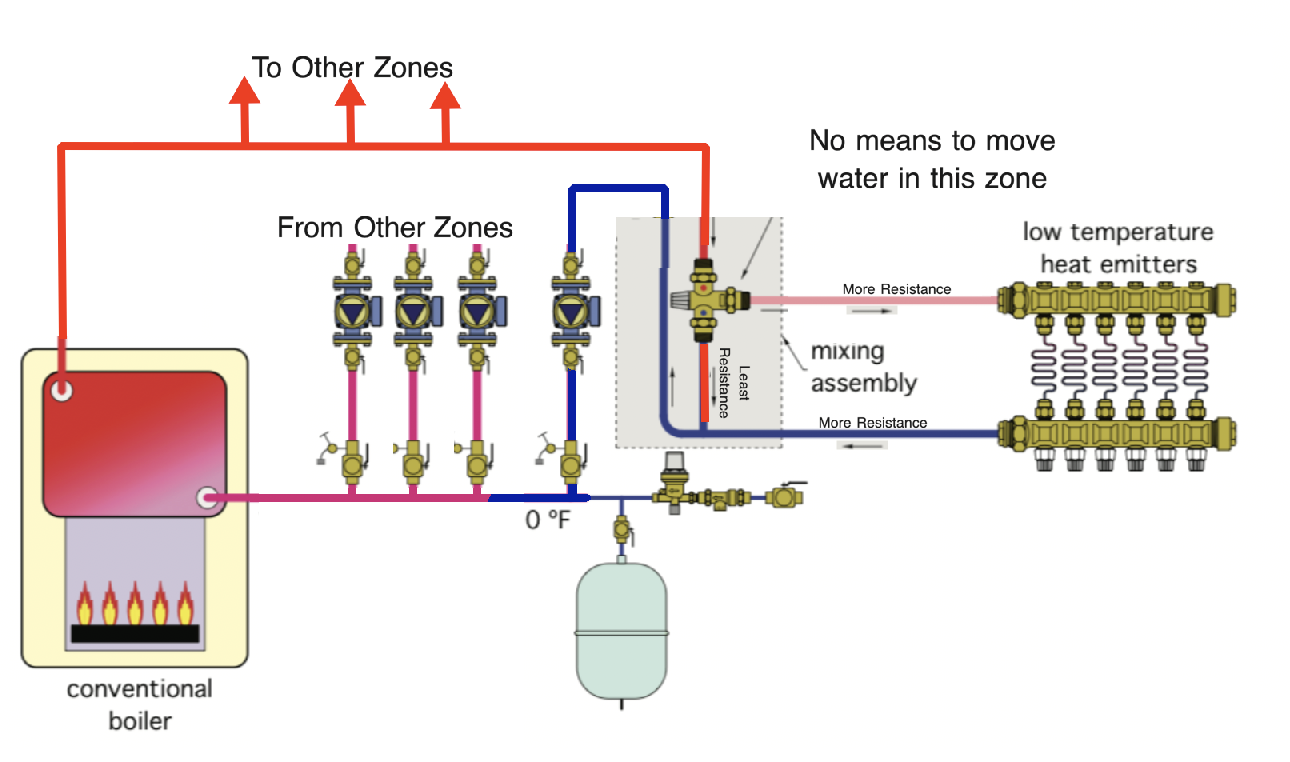

    I see that circulator in your photo. This diagram is how your system might me piped:
    You can see there is not a lot of pressure drop across the mixing valve when the MAIN pump is operating because is pulling equally on the cold inlet of the mixing valve and the return from the radiant floor loops. There is nothing to move the water into the cold side of the mixing valve, so all you get is what might pass thru the mix valve top the radiant loop and the rest of the flow may even go in the opposite direction on the mixing valve cold inlet port.
    This next illustration indicates the circulator in the proper location.
    The pump will pull water from both the hot and the cold ports to get the proper water temperature and move it thru the radiant floor tubes. I have also learned that you do not need the circulator pump where you actually have it located. That is because the mixing valve will pull the water from the boiler as needed to maintain the "MIX" temperature you set it for. If it needs more or less hot water that valve will compensate automatically.

  • (UPDATE) so the Winter is here. My brother helped me move the circulator pump just after the mixing value which was prescribed by the majority of responses. The floor is getting the necessary hot water to warm up the zone. I had to change the taco pump aswell. The old pump was pulling hot water through the manifold but didn't have the power to push all the loops, all the way through and back to the cold side of the manifold. The pump possibly got burnt up on the old setup before moving it. I now have 120⁰ going out and approximately 90⁰ coming back.
